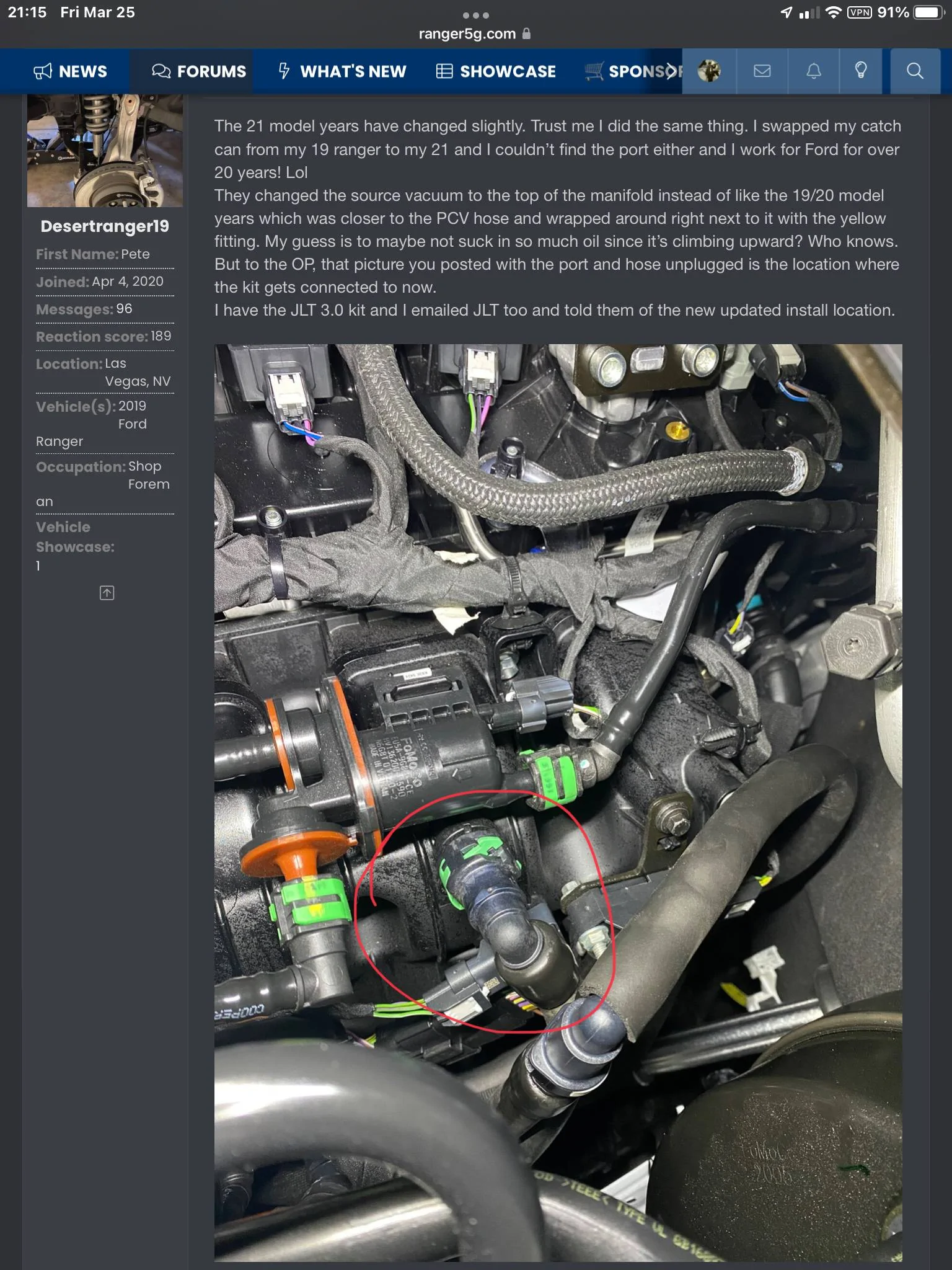

I’m not leveled and I have the smell, as well. I do have a catch can installed. When installing it, I found out that they moved one of the PCV connections to the top of the engine… driver side…. I can almost promise this is where your smell is coming from. I’ll see if I can find a picture and you can see if yours is up top, too. They moved it sometime in the 2021 model year.

This is from the thread where I was asking for help with my catch can. Desertranger19 was showing me the new port location for tying in. But, even if both ports for the PCV system are still down low on the engine, behind the driver side wheel, I’d bet money the PCV connections are your culprit.
