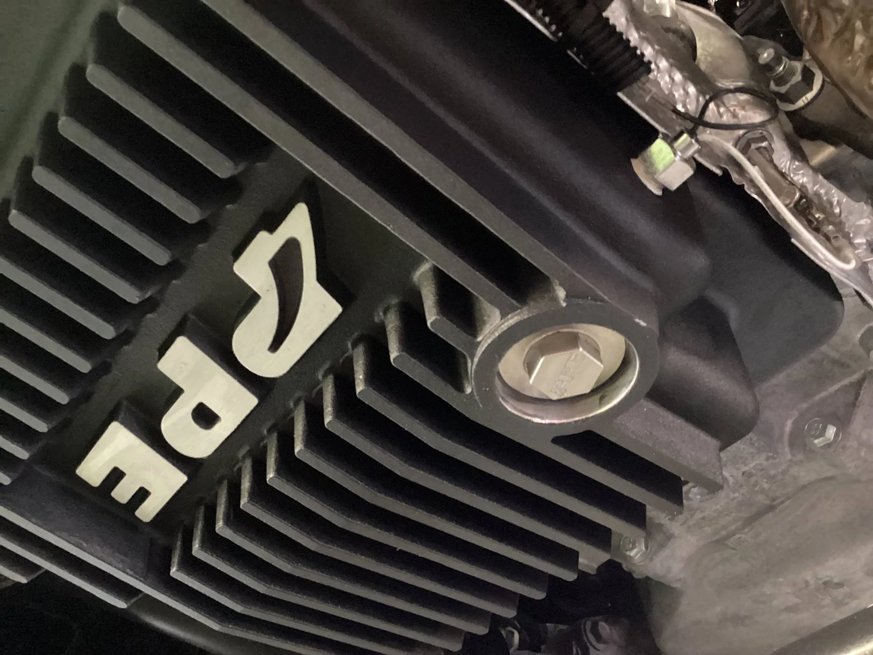

LISTEN TO CTECHBOB.
My transmission problems are GONE.
I changed the fluid via an inexpensive 12v transfer pump, installed the same amount of fluid minus 1/2 quart and added the LubeGard Platinum. I spent under $100 and 2 hours of my time.
I had made up my mind that if this didn't work I was going to unload the truck this summer.
Details follow for those who want to punish themselves further
I started having issues within 18 months at the 5K mile point. Truck was purchased new. Took it to the dealer. Functioning as designed! No problem found! "It's just the way the transmission works." This was well before the onslaught of transmission failures.
At 20K miles I had given up on the Dealer Service Department and was at my wits end. I had reset the tables and tried every recommendation on this forum. Wife begged me to unload the lemon. Neither of us trusted it for any distance.
I asked her to let me try on last thing. I followed ctechbob's advice.
From the very first drive after the fluid change and the addition of LubeGard, the transmission has been PERFECT. I am still not thrilled with the shift points, but everyone of them has been fast and smooth. Not on hiccup in the last 1500 miles.
I had shifts that took 5-10 seconds to complete this last winter, in all gears when cold. I could actually hear the solenoids moving from inside the cabin driving down the road. The truck is kept in a garage that never drops below 50F.
I had crazy symptoms, jerks, hard shifts, and failures to release when coming to a stop, then jerking out of gear with enough force to throw you forward!
And they are all gone. LubeGard works!
