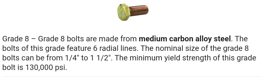

Threads are fine. No scarring. Other 2 bolts do not show signs of removal. Just went to ace. Flange bolts to match original. I will use blue loctite. I’m aggrieved.
Grade 8 bolts I hope.

The factory bolt is a 10.9 grade metric flange head m12x1.75-40 bolt with a 15mm head.
5,908
29,446
Gotta remember...SAE hardware and metric hardware are graded differently.
5.8 metric is approx a grade 2-3 sae
8.8 is grade 5 sae
10.9 metric is grade 8 sae.
Most hardware (Lowes, Home Depot, Ace) is either/usually 5.8 or if your lucky 8.8, which is generally for homeowner type applications or light strength automotive applications like panel attachment, ect.
10.9 is the automotive grade for high strength applications.
And, for high strength applications you don't want to substitute stainless steel hardware due to it composition stainless steel hardware is much more "brittle" than standard carbon steel. There is high strength grade 5 and 8 stainless but it is hard to find,,,never at your local hardware store.

8.8 would be fine, 10.9 better. For example the tow ball 2 bolts on EU ranger are M16 8.8, and those are supposed to hold a pulling strength of 3.5t. Yes, the driveshaft mount is about sheering force, but those are 4 M12 bolts. God knows how much driving the OP did with only two.

One of the photos the OP posted shows the OE bolt and it appears to be a 10.0 or 10.9 on the head, indicating a grade 8 equivalent. Definitely would not want to go to a lower rated bolt.
I just crawled under mine, a 2021, and those bolts are definitely marked 10.9 grade...a grade 8 equivalent.
