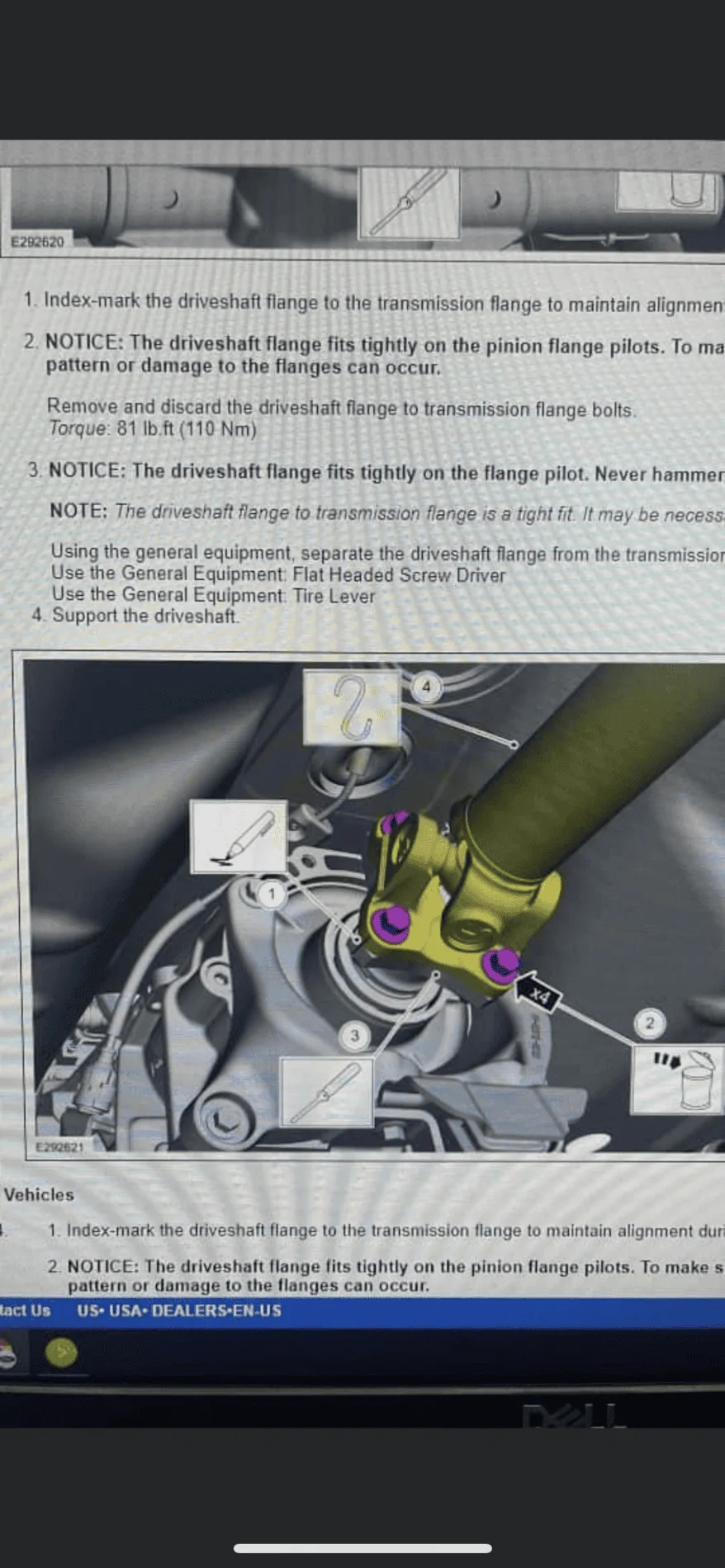

Looked under truck and found this today. This is insane.
Hi Michael,
It looks like a classic case of never been installed. How this got through inspections could be because the bolt was "top side". Normally in such situations the plant has torque counting guns and flags a uninstalled bolt....would appear this attachment operation did not have such a system installed. I highly recommend you have the correct fastener installed by the dealer and torqued to spec and the other bolts checked for torque. Things like this make me upset. I think Michigan Truck plant suffers with poor assembly quality. Too much of this kind of thing pops up in these forums. Buck stops at the Plant Manager....JMO, he/she needs to go....

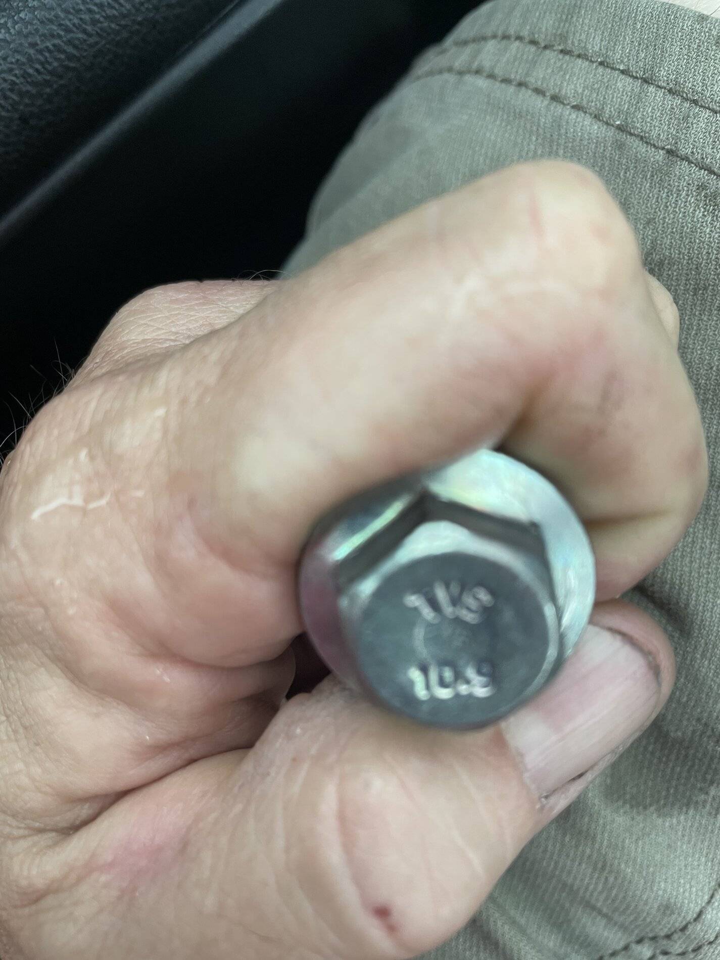

Fwiw these are the hardware store bolts. They are 10.9. Only difference from factory was the 17mm head and non taper on tip. So if any of you have this problem in the future, ACE hardware had the 10.9 m12x1.75-40

It’s fixed now. Bolt head is 17mm on the ace bolts and factory is 15mm
Did you do all 4 of them? Do you know the grade temper and torque spec? That’s just as important as having them there.
