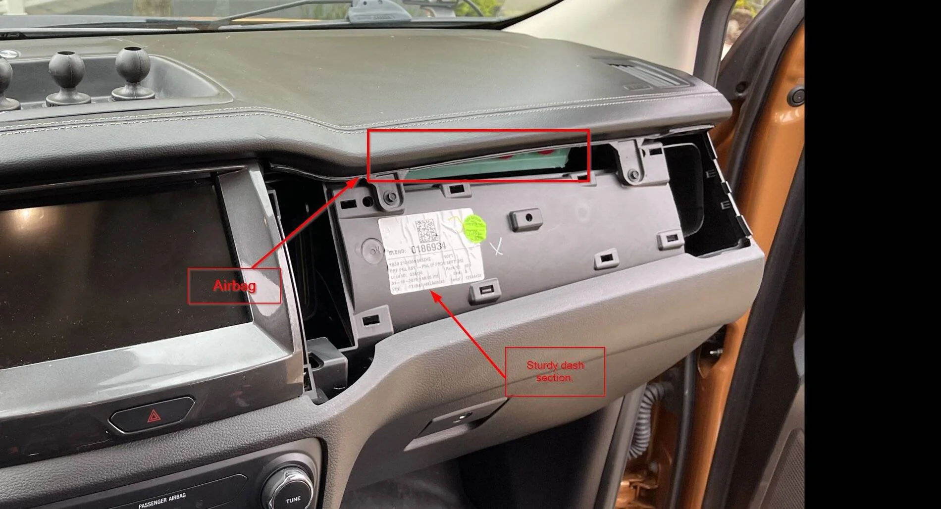

From what I am seeing online, it looks like the airbag for this zone deploys from the top of the dash? It appears to break open the top to deploy? The reason I ask is on another video I watched it almost looked like it was deploying from under the glove box and inflated upwards.
I am asking because I was looking to mount some flat items on the accent trim above the glove box and I don't want my passenger punched in the face by a foreign object.

I've had that area apart. It goes up through the dash. Mounting things that stick above the trim piece above the glove box might be a bad idea. So as long as they don't stick up too high you should be good.
