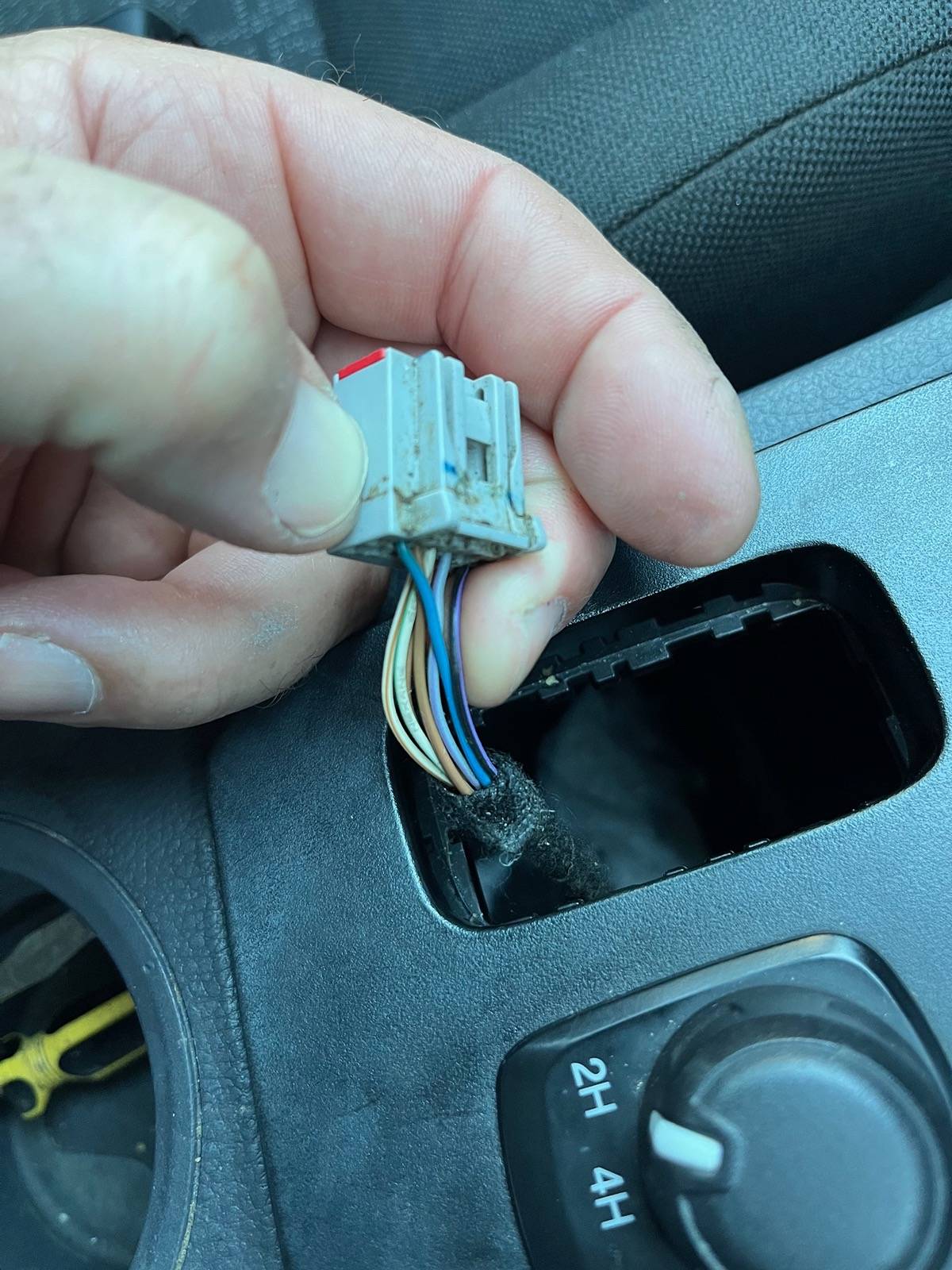

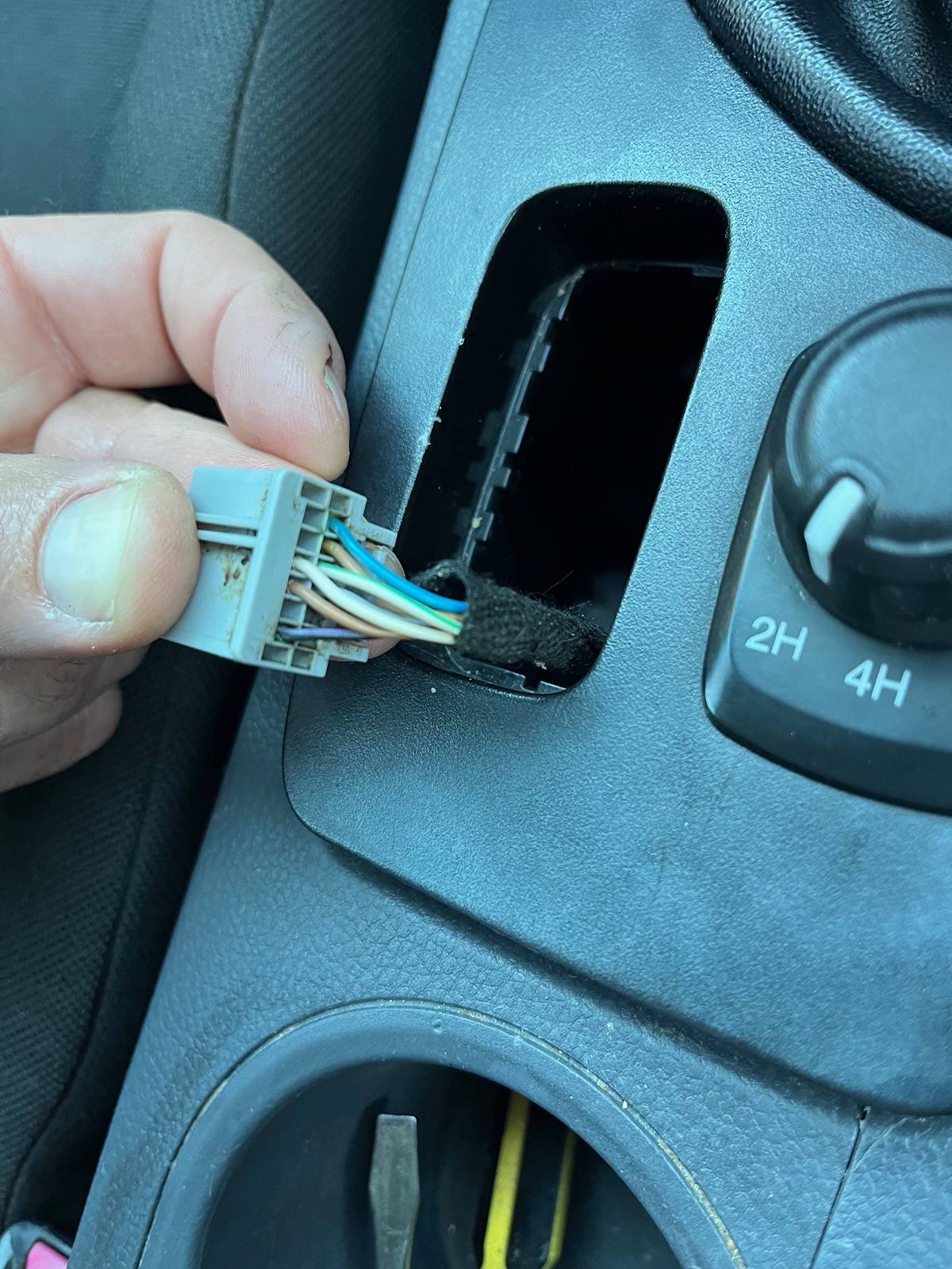

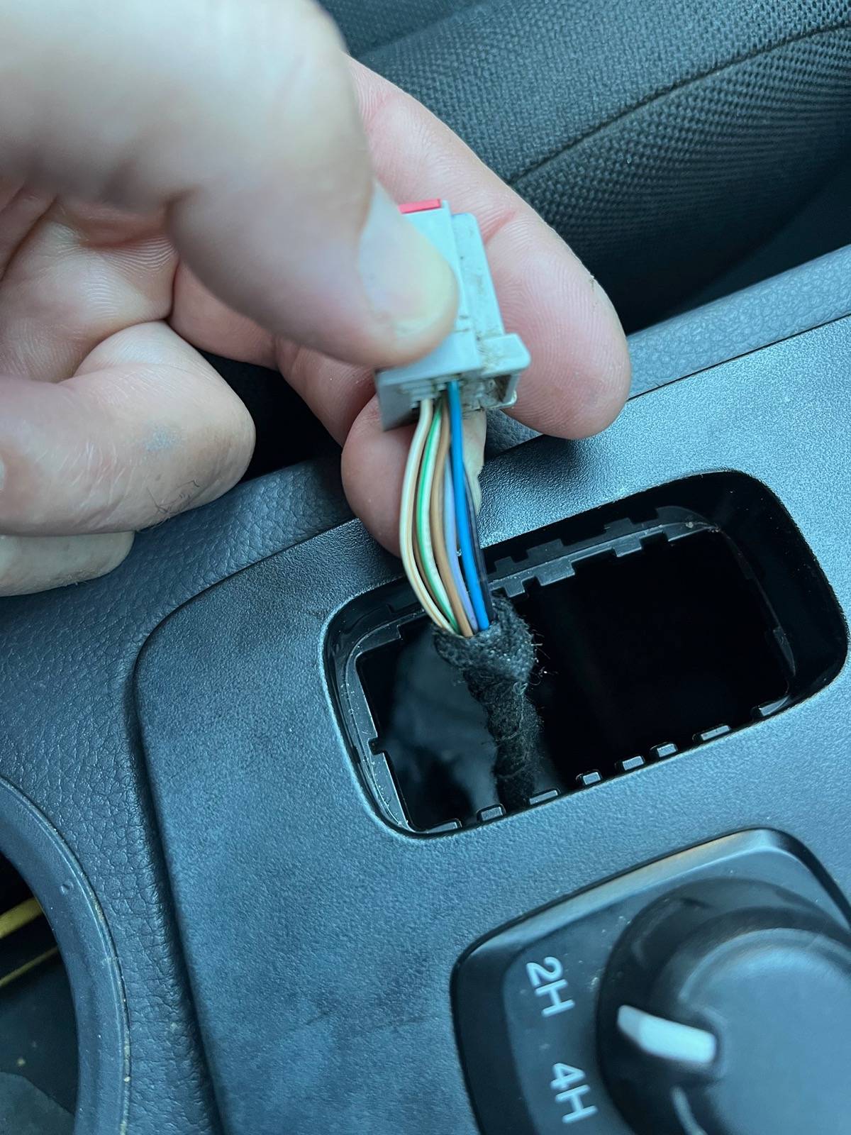

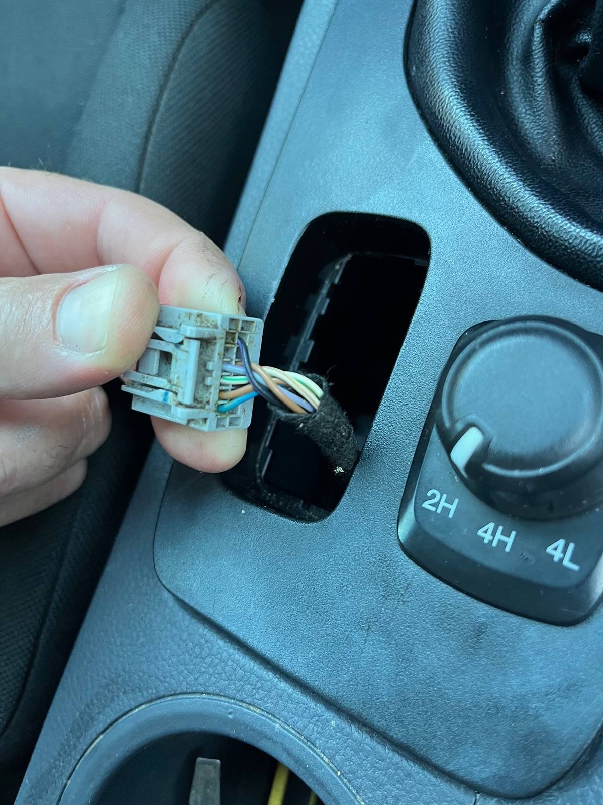

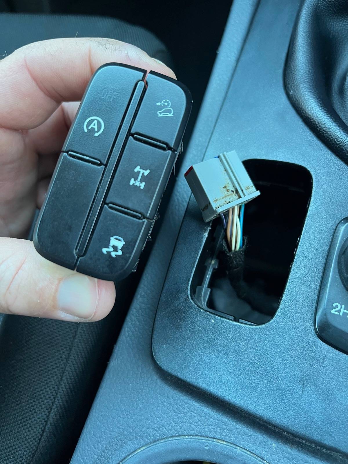

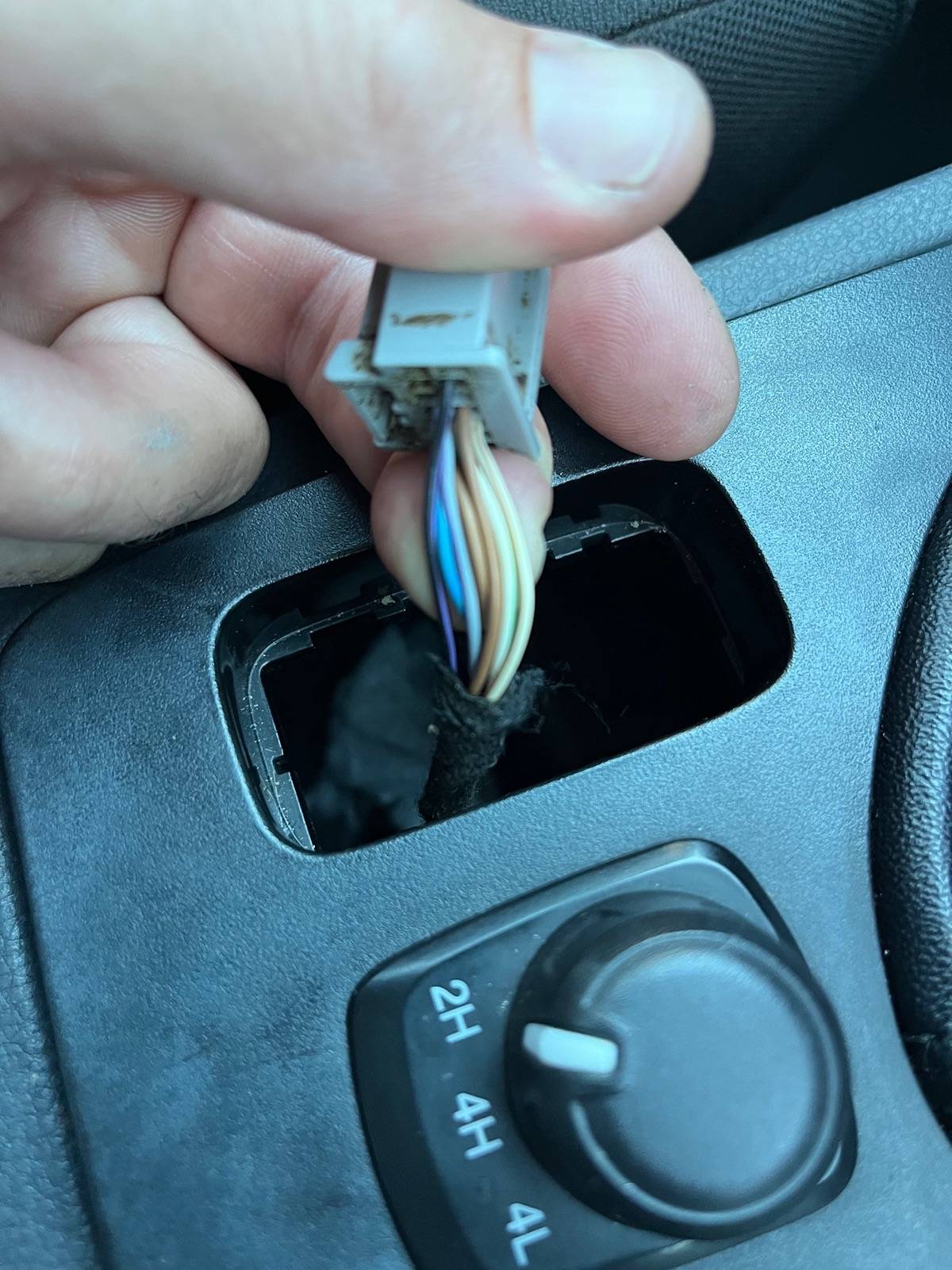

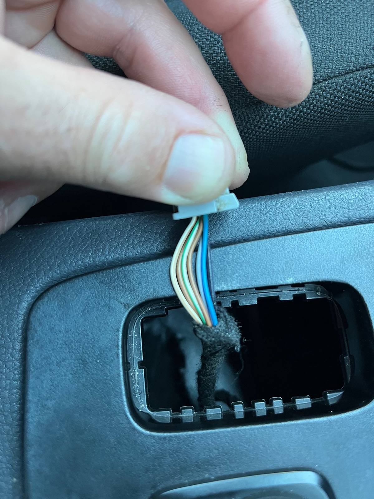

I am still unsure which two wires to splice for my toggle switch please.
Note, the Australian PX2 Ranger wires in the console switch are
White/brown
White/green
Blue
Light purple
Purple/black
Brown x2
Thanks again
White/brown
White/green
Blue
Light purple
Purple/black
Brown x2
Thanks again
Since we are only looking for 2-wires, this should be fairly easy.
The White / Brown - Should be the ASS Switch (Output)
The Black / Villot- Should be the Mult switch (Ground)
But this is for the US Version Connector.
To verify use the switch as a reference - disconnected and in your hand.
With a multimeter set to Ohms scale
Probe the pins on the switch that correlate with the Connector.
Negative Lead - To the Black / Purple - Should Be the Ground
Positive Lead - To the White / Brown - Should be the ASS Switch (Power) from the FCIM
However, cannot confirm due to not actually seeing the wiring diagram for YOUR truck.
But you can Identify which wire and confirm by (with the Pos and Neg) leads of the meter on the pins of the switch itself.
With switch in (normal) position the (Ohm Meter) will read OL (Open Circuit)
When you press the switch the (Ohm Meter) will read resistance (Continuity) should be reading around 1.0 Ohm.
This momentary contact pulses the microcontroller in the FCIM, which grounds the circuit for the indicator light in the switch and it also sends the Data along the CAN Data Bus to the other modules in the system that the switch has been (pulsed) to ground and the ASS is deactivated.
This is the message on the IPC (dash) disabled.
This is where I question if the FCIM will allow the switch to be perm grounded and hold itself in the deactivated state or will it still look for a momentary pulse before it deactivates and force you to actuate the toggle switch - (just like the OEM Button)
If it is not the White / Brown wire, then continue with the other pins until you find the pin that is for the ASS switch (provides the continuity) test results as above.
Any Wire with (Black) on it should be your ground, so it's just the matter of locating which of the other wires is actually the (Power) feed for the ASS switch which by the US Version connector is the White / Brown.
Thanks again airline tech
