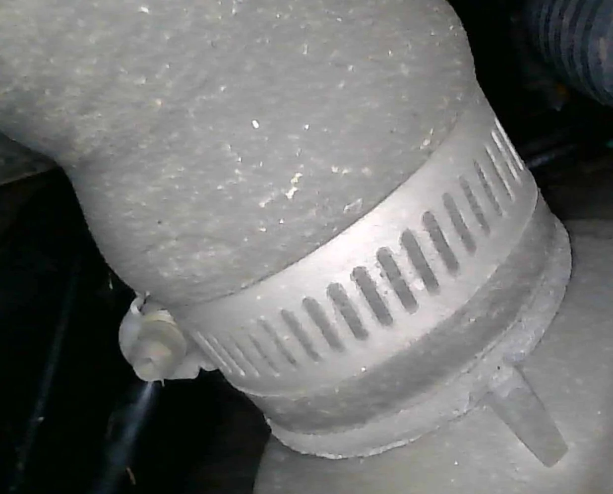

Spent a little time today with my two Bore Scopes looking above the fuel tank. Here is what I saw.
This is the filler hose where it meets the top of the fuel tank. It is dry. You can see the buldge above the clamp that I alluded to earlier. It is not leaking.

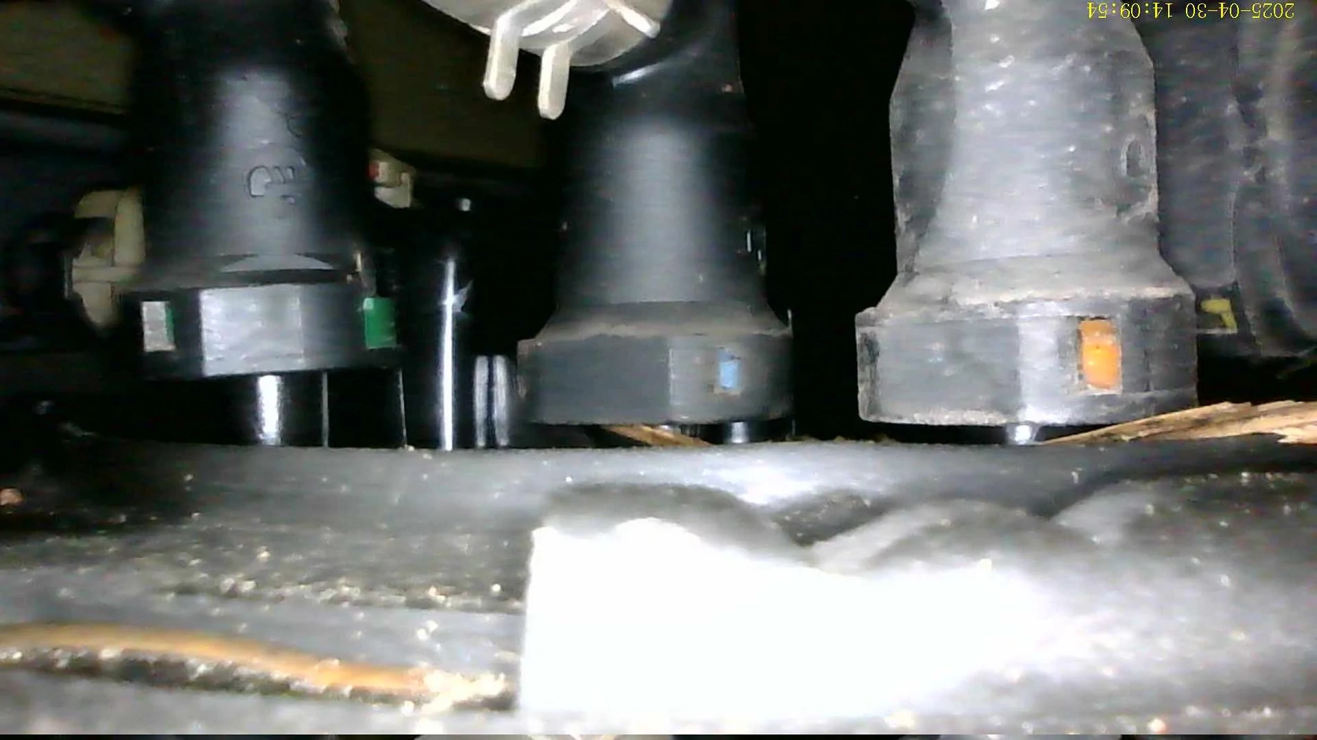

However the left most line appears to have lifted off the input stud and leaked gas. I don't recall one being higher than the others and it is somewhat cocked. This is the port closest to the cab.
Notice how clean the input port is. Gas is a great cleaning agent! The question remains why the pressure rose so high as to raise the cap.
I'm going to try to reach up there and push the cap down onto the port. If it locks into place we will have the answer about what was leaking, but not WHY it was leaking.
