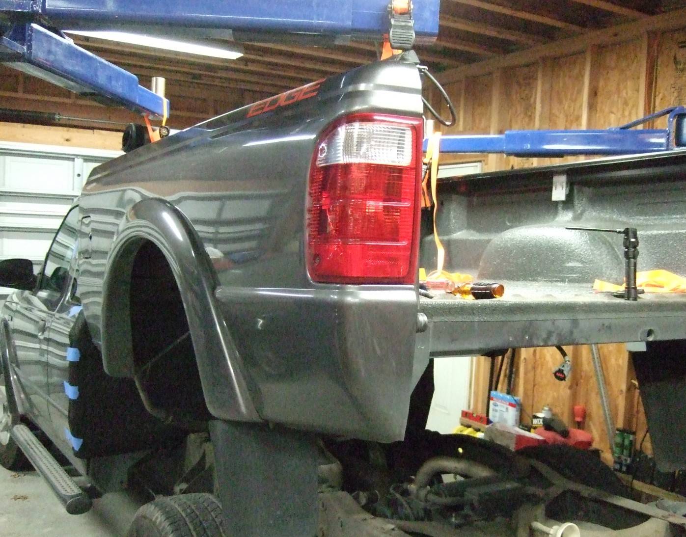

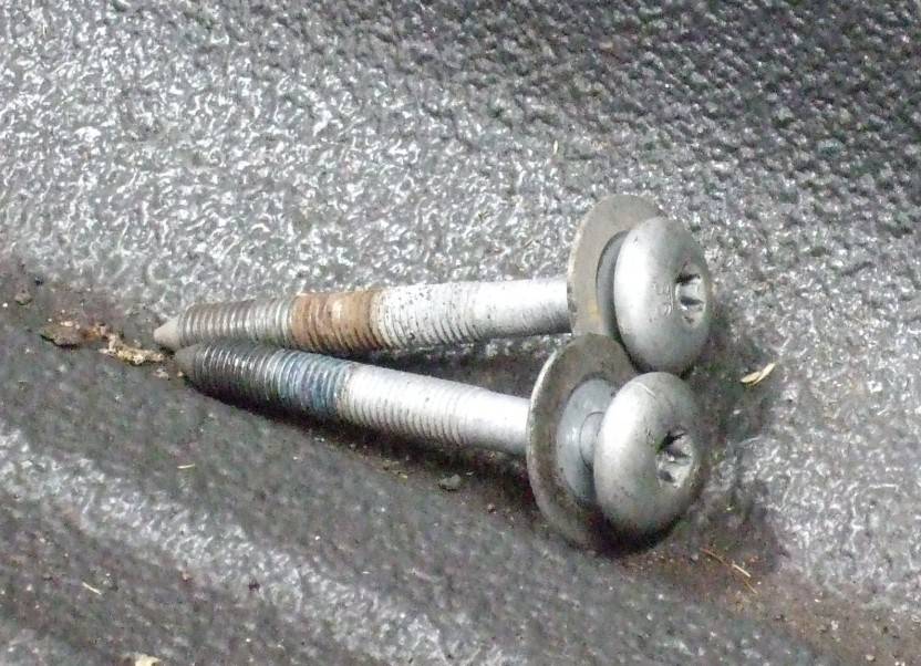

I went with option 2 as I have long owned a 2 post lift which should make easy work lifting the bed. I started work on the project this morning. I began by removing 6 bed bolts which held the bed to the truck frame. They are long bolts but came out relatively easily considering that the truck is 18 years old. A few were tough but all eventually came out. I am going to be cleaning them up prior to reinstalling them. Here is a couple of them.

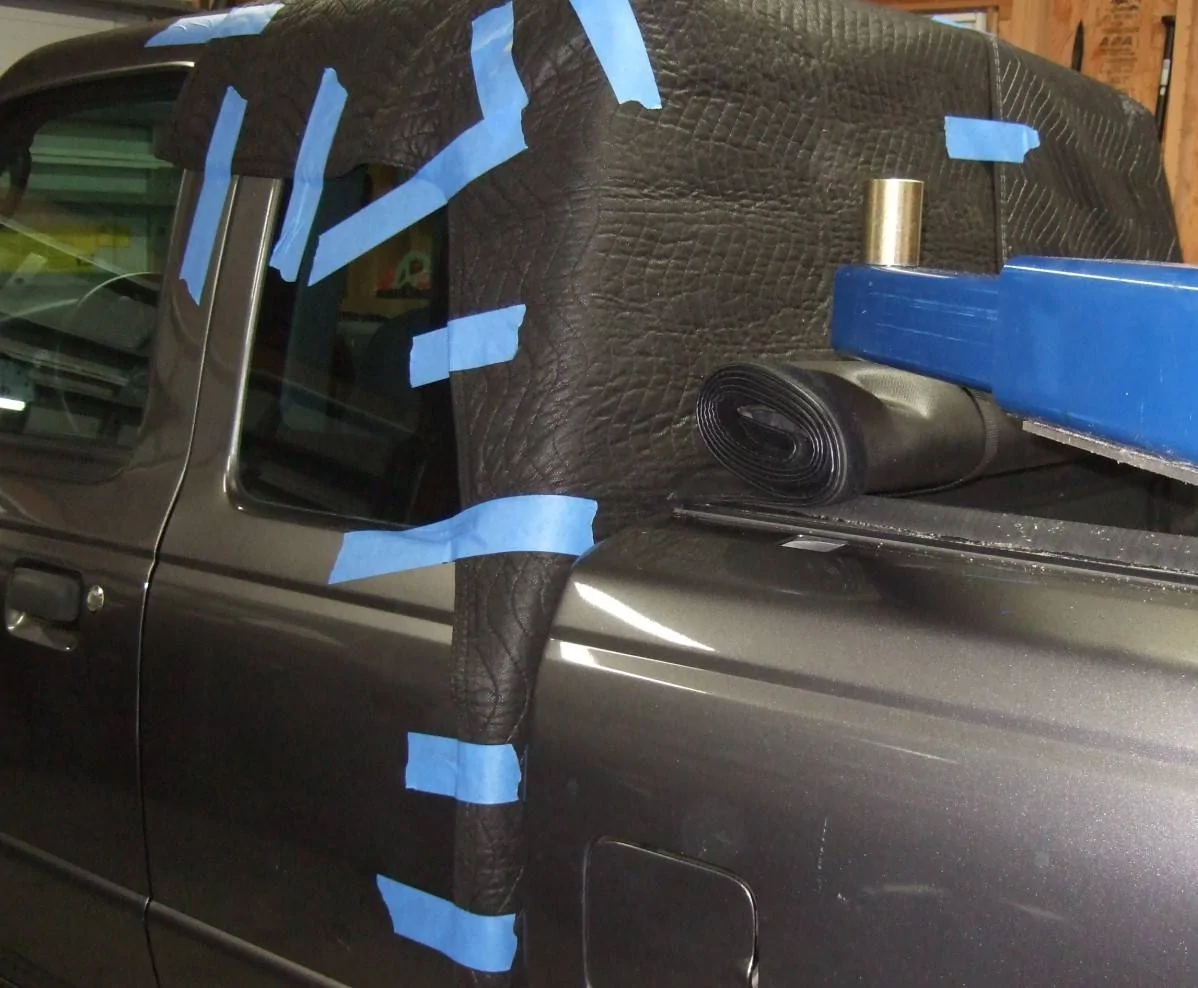

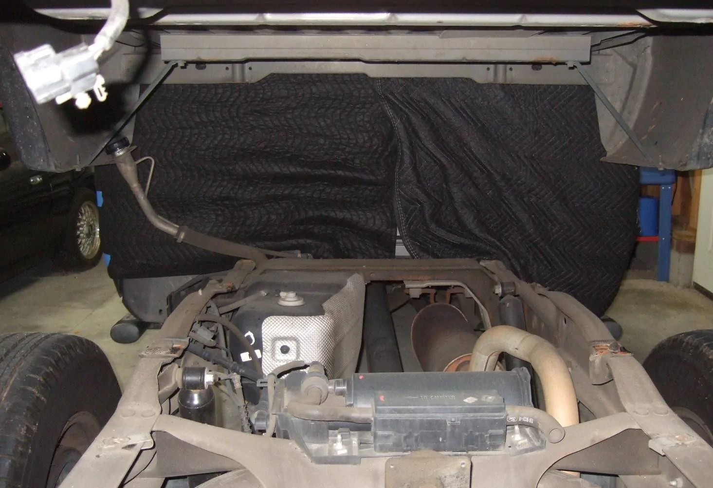

Before going further I decided to protect the cab and the bed. I used moving blankets and painters tap to secure the blankets where there was a possibility of the bed damaging the cab.

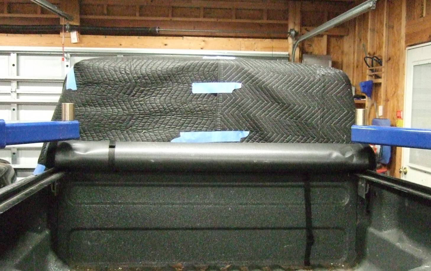

Once this was accomplished I attached a 400lb ratchet strap to each of the four tie down points in the bed looping them over the post. This should allow me to raise and lower the bed with precision.
Plenty enough room to access and remove the pump.

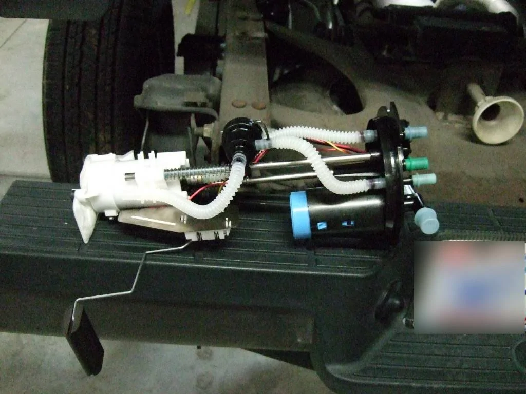

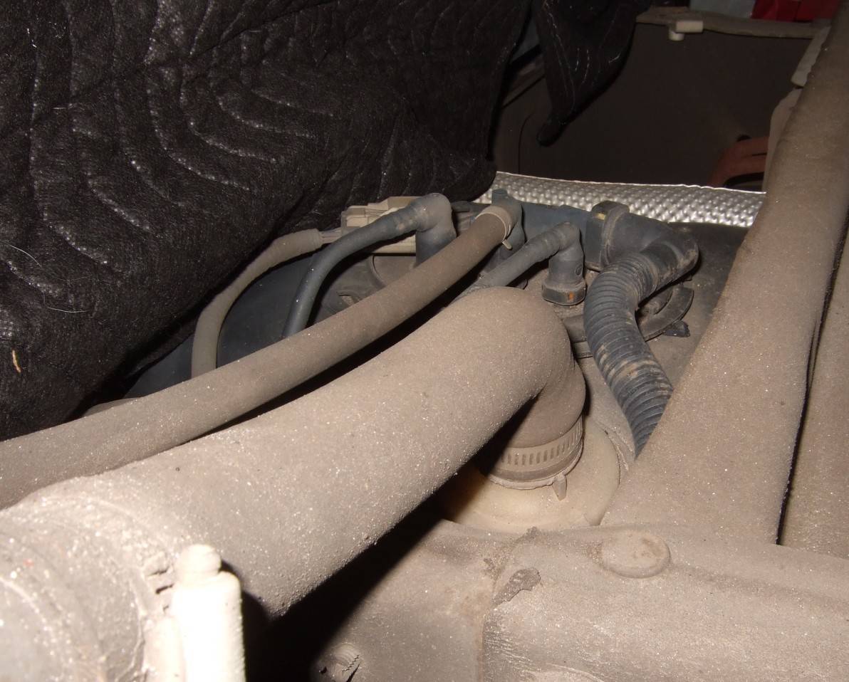

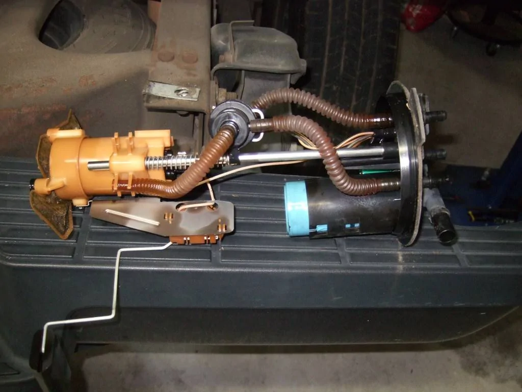

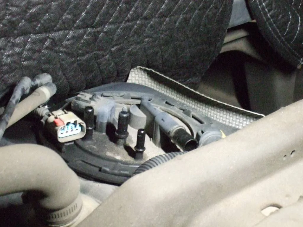

Here is the target of all this effort. Going to cleanup the area, then replace the pump assembly. Don't want to contaminate the fuel or tank.
I removed the 4 fuels lines from the original pump assembly. Then unplugged the cable. The red tab has to be pulled out to release the cable. The fuel lines all required depressing the colored tab on the line cap.
Here is the new pump. It cost $300! And the original pump with 18 years and 165K miles on it. The days of $20 mechanical fuel pumps are gone!
