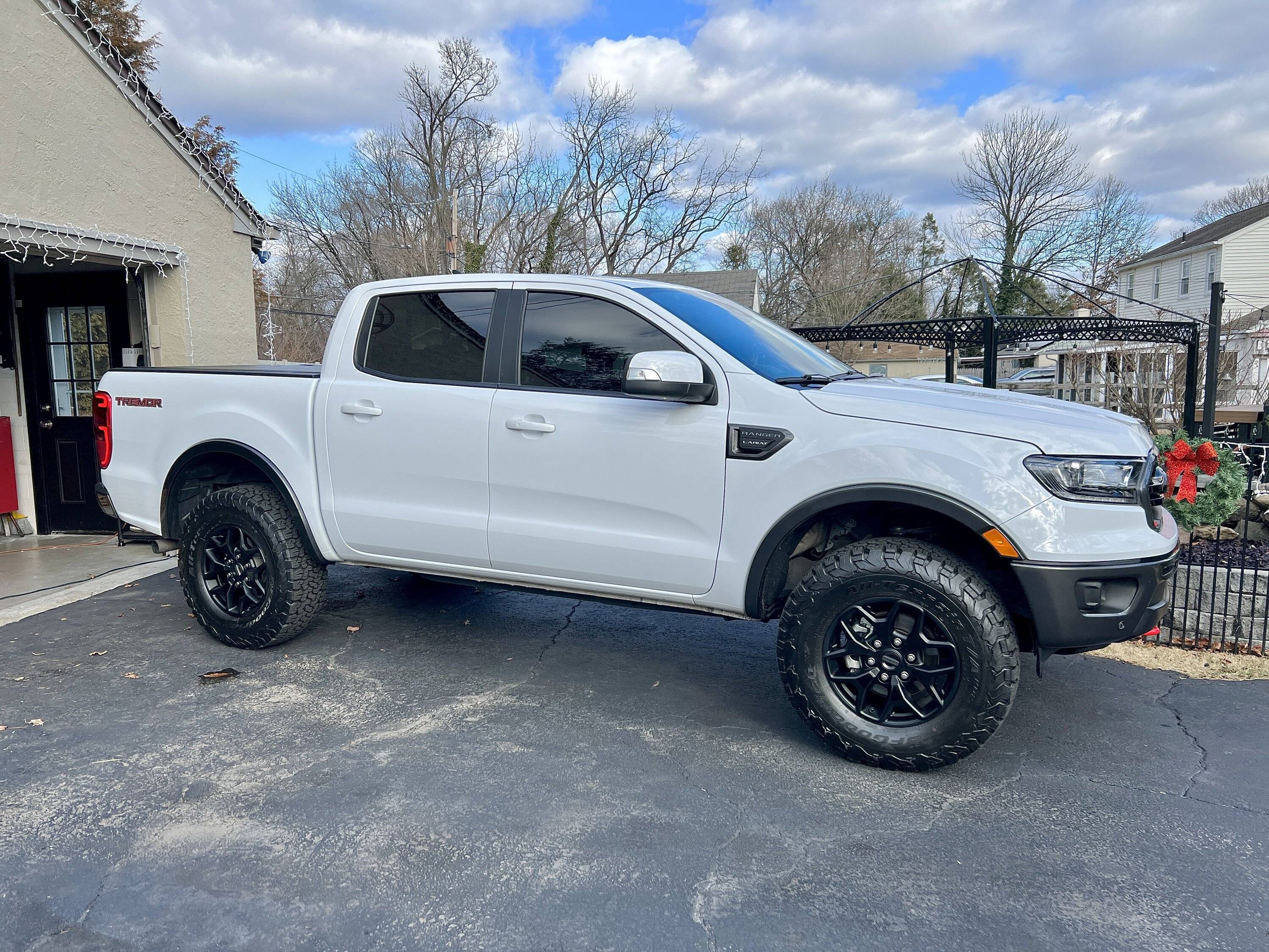

Installed a 1” level over the weekend (put on a set of bronco badlands wheels and tires as well) haven’t really noticed any difference of significance in the ride.
Man, those wheels look great on the Ranger. Was the offset different? Do they stick out more than the Tremor wheels? I like the stock Tremor wheels but put a 1" wheel spacer on them for a better stance.
They are +55, not sure what the stock tremor wheels are off the top of my head but it seems similar to my eye. I'm going to throw on a set of 1" spacers and it should be pretty close to flush with the fender and give me the look I want.
Those wheels look sweet!
They stick out less. +55 for any Bronco or Ranger wheels with the exception of the Sasquatch wheels for the Bronco (+30) and Tremor wheels for the Ranger (+42).
