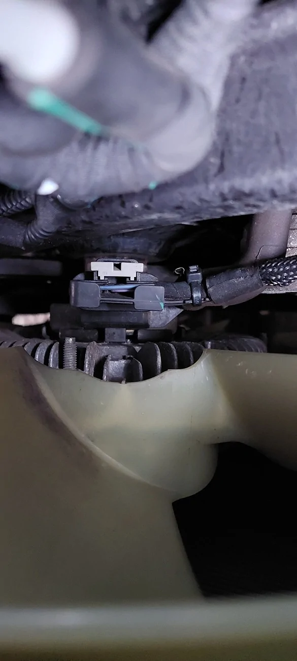

A friend told me that maybe the fan isn't cooling enough.
The fan is constantly running at idle, I tried to stop it while the engine was cold and I managed to do it without much resistance. I also did the same thing when the temperature was close to operating temperature and the same thing, I stopped the fan, I don't know if that should be possible.
By the way, when I did the Co2 test, the fluid at idle was still, but when I stepped on the gas, the pressure pulled it in and not out.
Is it viscous clutch fan or electric? Once warm the fan should cycle off/on as the engine heats up. If it is not cycling, the viscous clutch may have failed.
When first starting our USA Rangers, the fan clutch cycles on and our truck sounds like a multi-ton diesel truck for a few seconds as the rush of air is quite loud, even in the cab with the windows up.
Your friend may very well be correct!
Elektric or ?

Elektric or ?
Its electro viscous - its not a true electric fan, its pulse width modulated (PWM) controlled by the PCM Its still a clutch fan style - only instead of a thermal spring it has the PCM controlling the speed via a VREF circuit -I do not think this is your issue.
