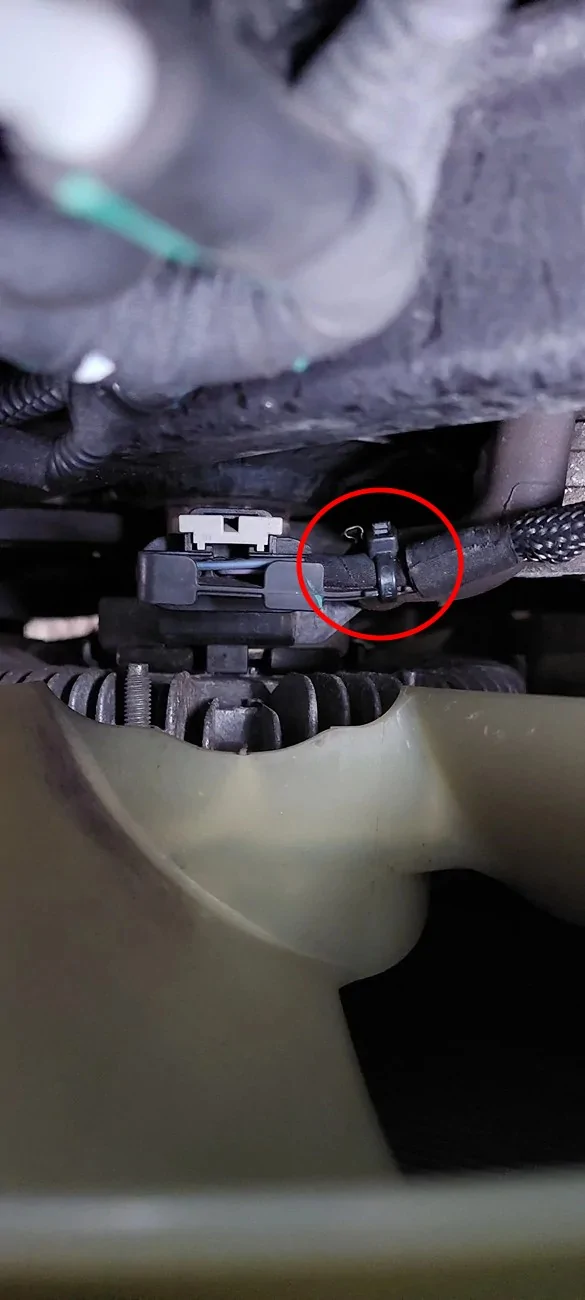

But it is easy enough to test. Does it ever engage! If it does it's not the problem. If it doesn't, hmmm....
One last thing... Notice that zip tie on the cable where it meets the sensor. Is that stock? I dunno, but I don't think so. I know it is not there on my truck. Maybe someone had an issue and repaired something in that area.
I'm grasping at straws, looking for something out of the ordinary.

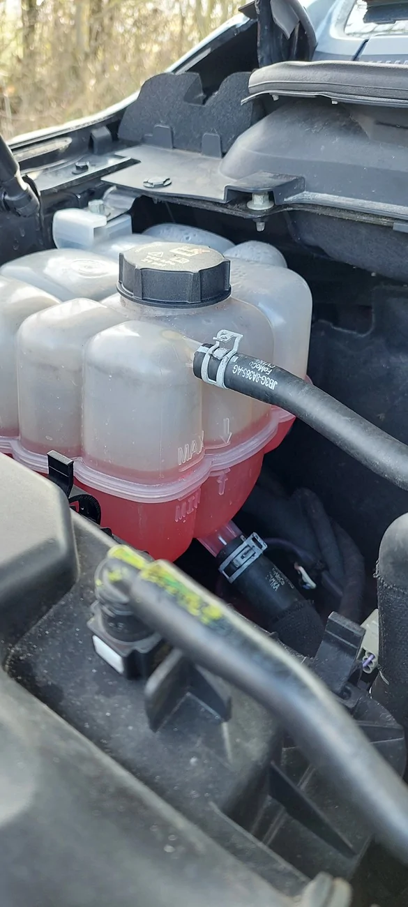

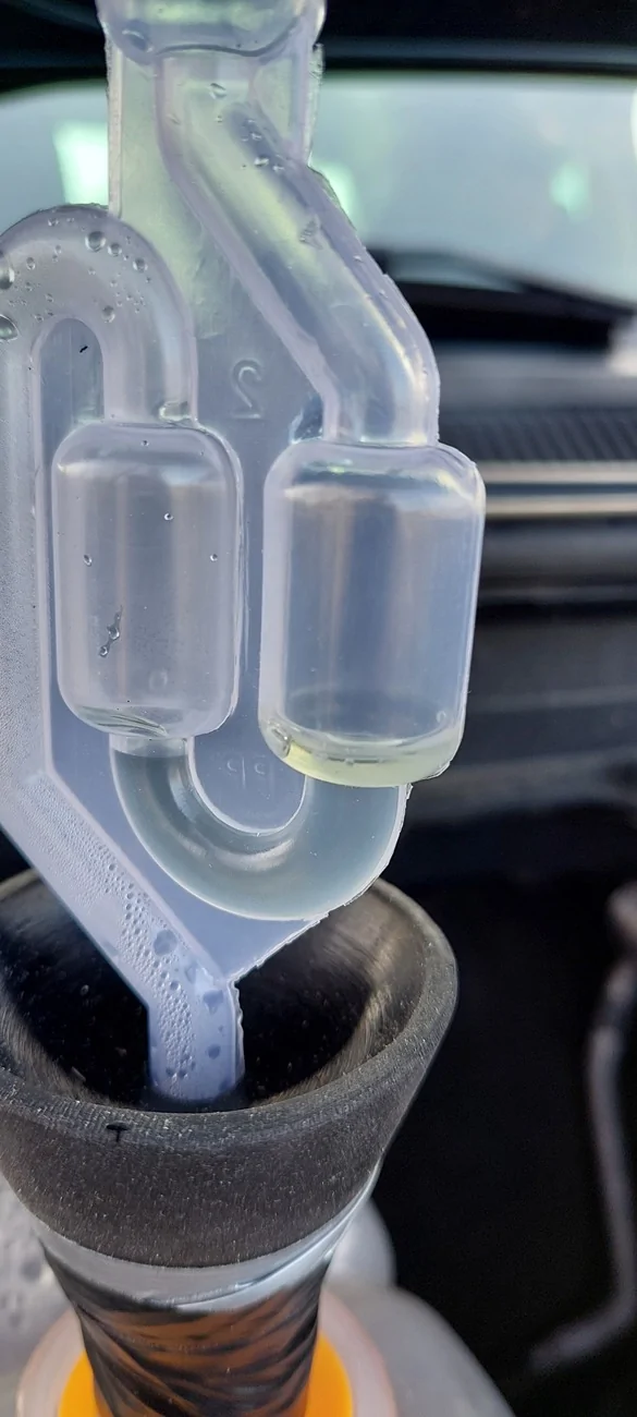

Hello, today I tested the EGR valve cooler as you described.
1. picture, condition at 88 degrees Celsius, thermostat released fluid into the front radiator
2. video, I opened the cap from the container and placed the tester

3. color of the fluid after testing

It seems to me that the liquid has changed color.

Airlien Tech,
You are probably correct,
One last thing... Notice that zip tie on the cable where it mets the sensor. Is that stock? I dunno, but I don't think so. I know it is not there on my truck. Maybe someone had an issue and repaired something in that area.

That’s because they have a 2.0 liter biturbo diesel engine and not our 2.3L gas engine. Stuff’s different.
I'm aware that it's a different engine.
I have never seen a zip tie used on any OEM auto cables except when I placed them there. I don't think manufacturers use zip ties to hold cable sheaths in place. Mass produced parts don't generally come with zip ties. There are much more cost efficient ways to achieve the same result.
My point is that the zip tie is an anomaly to modern manufacturing, and may point to a modification, or suggest that a previous diagnostic investigation was performed on the cable or fan clutch assembly.

1. Blue Fluid at the beginning of the test
2. Air Pockets - Moved to Reservoir - (noted subtle - not aggressive)
3. Reservoir Fluid - remained stable - did not suck down - so air pockets are gone
4. Noted some slight pressure pulses - still remained (Tester)
5. Fluid eventually (what did not get displaced) by the pressure pulses
6. Turned (Greenish / Yellow) -- Positive Test
Since you did not have it set up - like I intended (Sorry, that's on me) it still appears to be the EGR Cooler - Leaking - (Exhaust to Cooling System) using one very important observation and that is if a Head Gasket or Head was leaking - the air pockets would have remained and the pulses would have increased and been in sync with RPM.
So, for me and from my office chair - EGR Cooler
I suspect if the test was done - how I intended - the pressure pulses would have been slightly more aggressive and the (Test-Fluid) would have changed faster.
So, if you were to retest - again and my theory is correct - it confirms the EGR Cooler 100%.
Basically, I can see a (Highly Possible - EGR Cooler Leak) as with only that test, well you actually isolated 1/2 of the possible source and by doing another test would just be a secondary confirmation of the EGR Cooler - If it gets worse under load - it confirms it.
