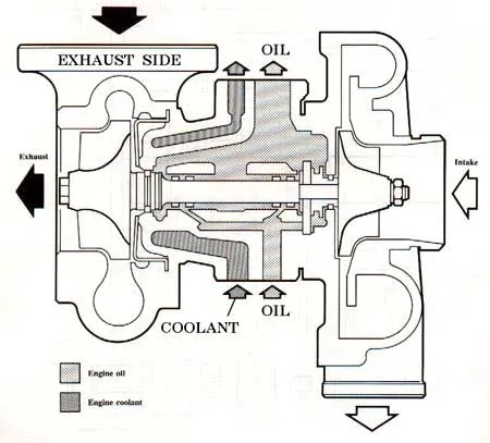

“I believe the turbo in his diesel engine is water cooled. An internal coolant leak could cause air to enter the coolant system, but not combustion gases. You'd still see burbling / gurgling in the coolant from air /water vapor.”
Just an FYI. An internal coolant leak in the turbo would not reach the compressor side. The coolant jacket is on the exhaust side of the turbo. So if it leaks internally it’s either going into the oil cavity or out the exhaust side of the turbo. Compressed air would not reach the coolant passages.

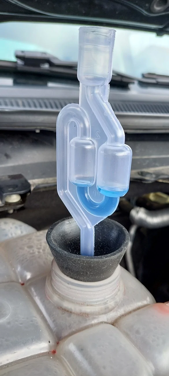

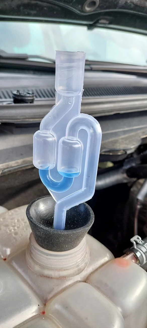

Hello friends, last weekend I tested according to the description

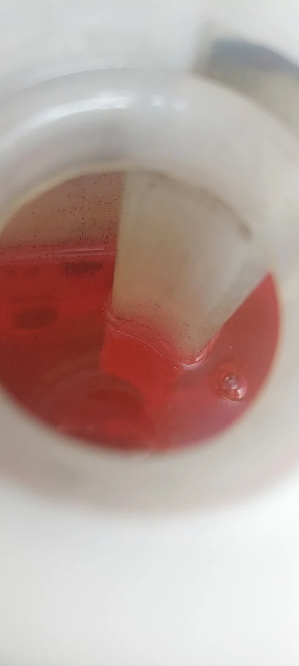

Today I took a photo of the liquid in the container. I don't know what the black particles are. I haven't noticed that before. In the video, you can see them on the inner walls of the container. The level changes as does the liquid.
Just curious if you ever found a resolution, but a quick check on the floating debris
Pour it over a paper towel
If it smears when you put your finger on it - its combustion partials
If it stays solid, then its debris from - Rubber Hoses or Radiator Fins or other metal sources
or
When the partials dry out (evaporates) they will leave a stain on the paper towel.
or

Yes your issue is slightly unique as you are not loosing coolant (notably) and you are not overheating (notably)- Just be sure to explain in Detail what your issue is and what you have done so far to troubleshoot it.
It only appears to be either sucking air in or exhaust air being pushed in.

Awesome - The reason for no white smoke is it was not leaking into the exhaust; the exhaust pressure was always greater than the coolant system pressure and was pressurizing the cooling system via exhaust - at least the source was finally located
This was the cause of the Positive CO2 (Tests) and the bubbles noted in the reservoir and the constant air in the cooling system
