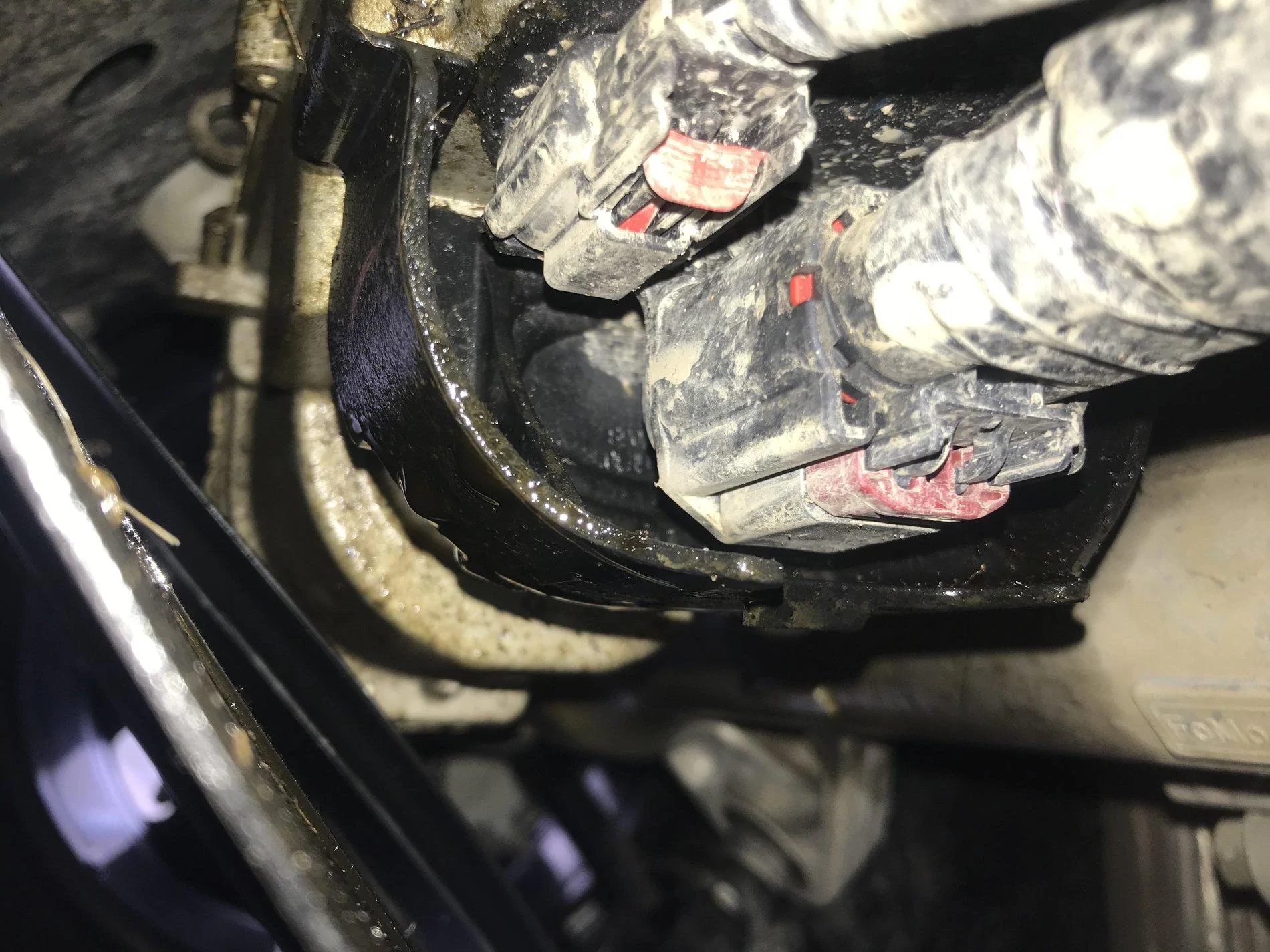

Does your vehicle have a front skid plate? Was wondering if that would help with mud splash into the engine compartment. Ford does test 4x4s in mud on our Romeo Michigan Test Track on a specially designed 4x4 course and am surprised they did not find this problem during testing. There are some real serious water and mud areas on the course. Will have to pop the hood and see if I can understand more clearly what might have gone wrong. I would elevate this to Ford Customer Care for reconsideration.... I am puzzled by your unfortunate event... You should be able to go off road with confidence. Is you vehicle lifted with bigger tires? Not sure if lifting would change things that much. Sorry for the questions...I am trying to understand why it happened to you.

Okay...popped the hood....Was quite dismayed at the gaps in the skid shield to frame and the inner fenders and the frame. No wonder your alternator is mud soaked. My take is that you might be better to try to eliminate the gaps between the inner fender, the frame and the skid plate. Keep that left tire from slinging junk into the engine compartment. The video shows a mud covered engine, and frankly I have seen this many times before, but not to the point of clogging the low mounted alternator. I have to say I am puzzled by this as when we were at Ford, this sort of mud slinging would have been accepted, only if the componentry would have still been functional and the engine compartment cleanable... In my opinion, Ford should pay for your alternator and the installation time. Three hours? Maybe, as I have not slung a wrench to make a living in some 50 years, before I became a Train Driver...
