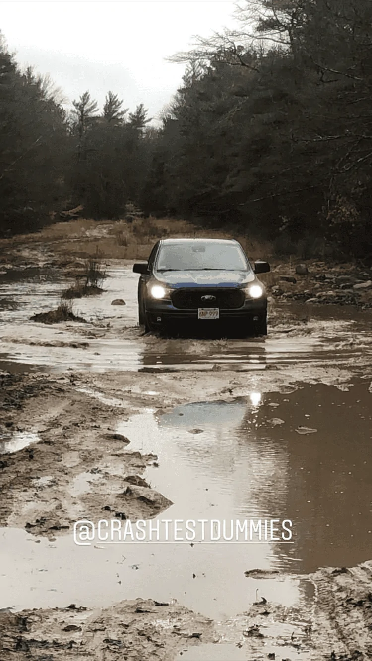

Update: it is 100% the alternator. Thing is caked w mud. Here's a pic of the deepest crossing from today...
Quite disappointing for a truck that says off-road on the side LOL! Otherwise very impressed but pissed off rn.

Thanks Phil. I was going pretty slow, probably <5mph through this area. There are some large rocks in the water so I would not risk going faster. It was raining today and I did go through some puddles at speed but I can't imagine that would cause any damage to the alternator.

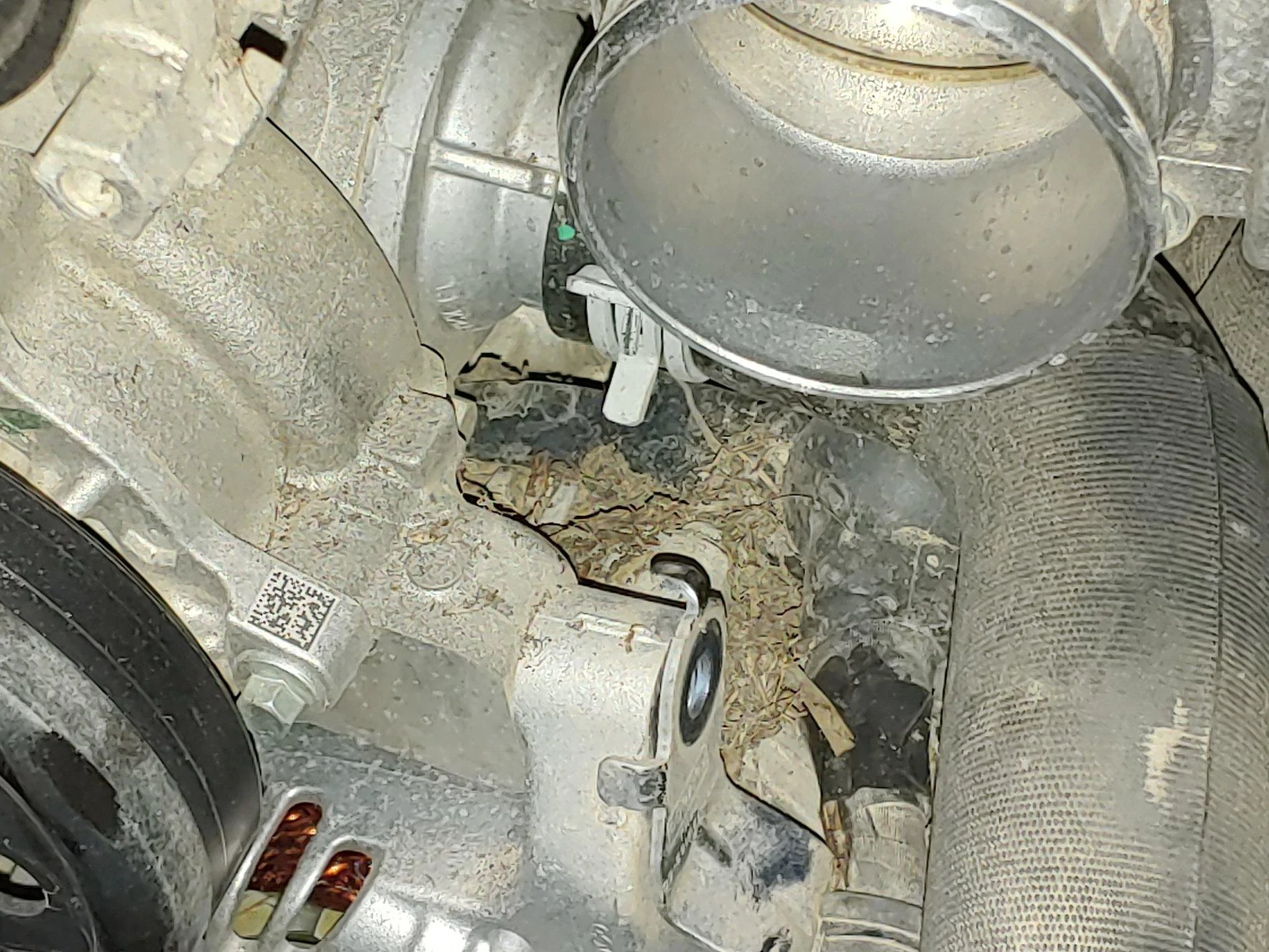

I'm no expert, but judging by splash patterns on my vehicle it seems like mud can be picked up by the fan and basically blasted over the engine and alternator.
You can see in the attached pic of the alternator that there is grass type debris that somehow swept up there, which puzzled me. I'm assuming that this was swept up there by a puddle I crossed, but I'm really surprised that it got past the skid plate!
Hoping a guard for the alternator will prevent this in the future.

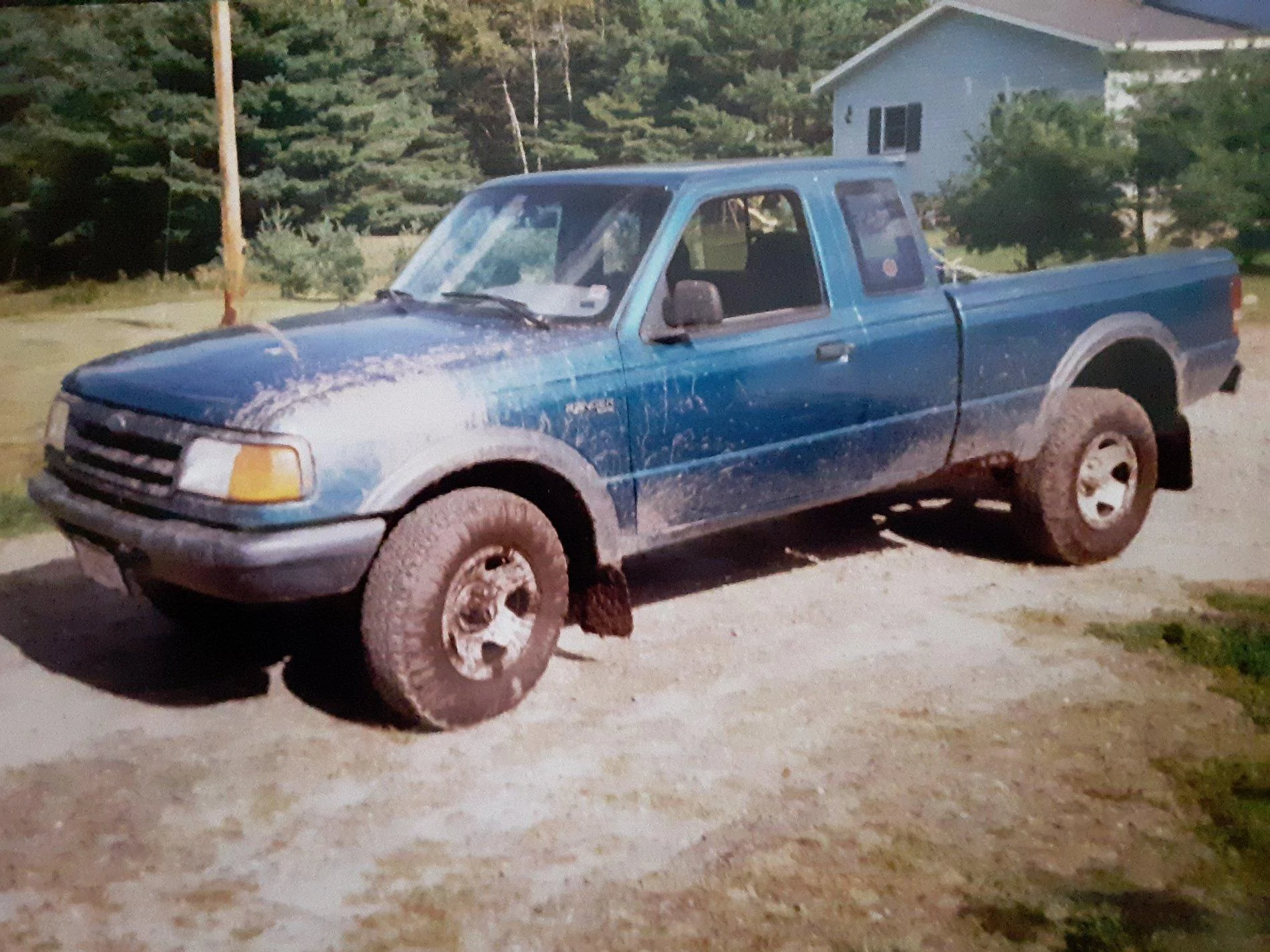

I remember spending about 3 hours cleaning after one hour playing in dirt...and I mean pressure-washing everything, taking wheels off and hosing wherever I thought mud couldn't possibly get..the stuff would dry up pretty quick and stick like glue to driveshafts, inside of wheels, you name it..the ride back from a mudding trip was like sitting on top of a washing machine on spin cycle...
Exhibit A...of course, the good thing about the Vulcan 3.0 was a high mounted alternator...but still would get mud around it
