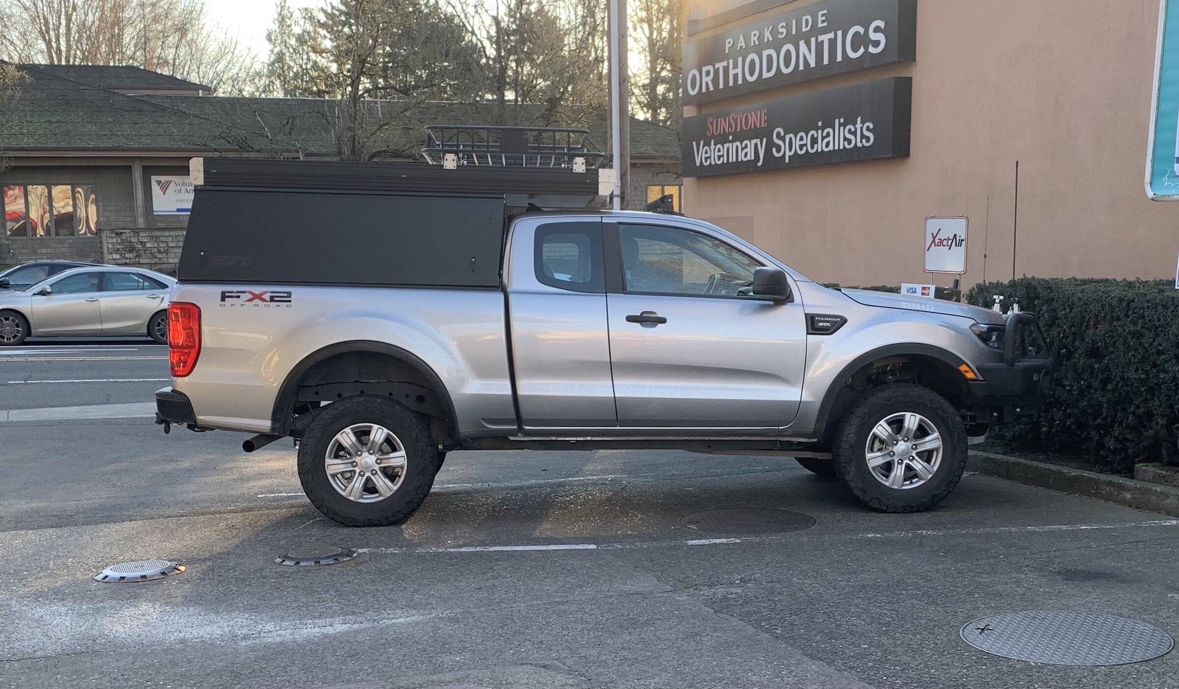

Figured I'd post a better picture showing the rake. The first image I posted looked more extreme due to my driveway slope. I'm not saying it's level, but it's pretty close to what it was stock. Also, keep in mind this is an empty bed save for the GoFast (weighs a tad under 300 lbs). The new leafs are markedly better at bump dampening. I'm still running stock shocks in the rear. Bilstein and Fox are both on backorder for what I want. We'll see who gets stock in first.

Update: welp, got some shuddering going on during moderate acceleration. Took it back to the shop and they installed a shim on the driveline. That helped quite a bit but it's still there somewhat. A suspension / driveline expert I am not, but they mentioned something about shims for the leafs to change some...angle. Anyway, I'll see what they wanna do next.
Sounds about right due to the little extra lift of the medium load springs. I did not have the issue with my truck using standard load springs. Once the angle is corrected it will help considerably
Makes sense. These springs do add a bit more lift than I had initially anticipated. I suspect fully laden it'll be just about perfect.
The shop has taken great interest in my rig as it's the only 2WD Ranger they've run across. I'll post specifics once it's all sorted out for anyone else that may run into this.
