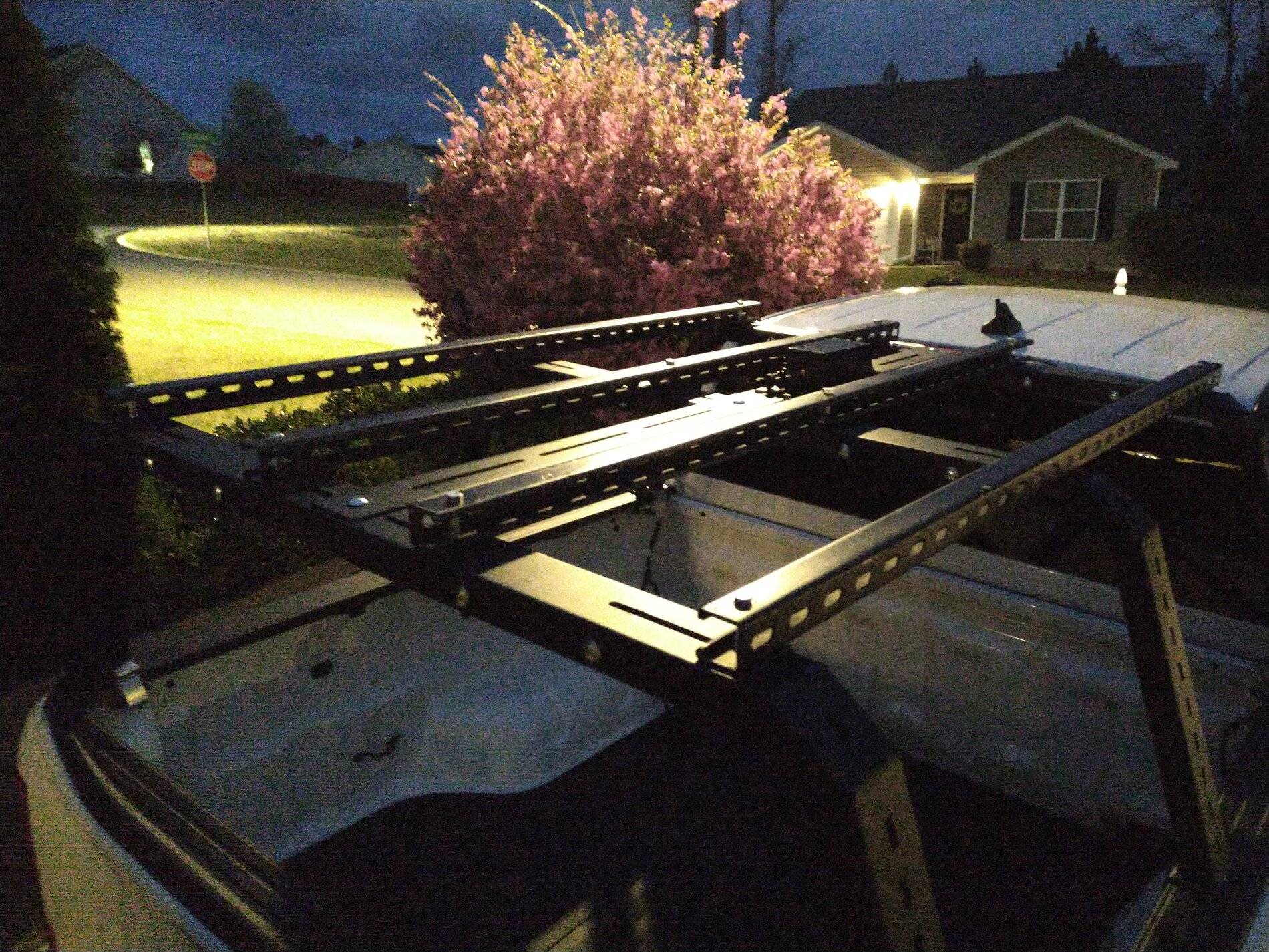

Not sure exactly what you’re trying to do , but I assume you want this rack to cantilever over the cab like the one in your photo. There are many sources of large racks for vans, but all of them rely on full-length support from the van roof. You know that wood will be bulky and heavy to get the required strength. Just spitballing here, but you might consider using aluminum extension ladder sections for the base. They have better cantilever strength than anything I can think of for the cost. Three sections should provide your desired width.

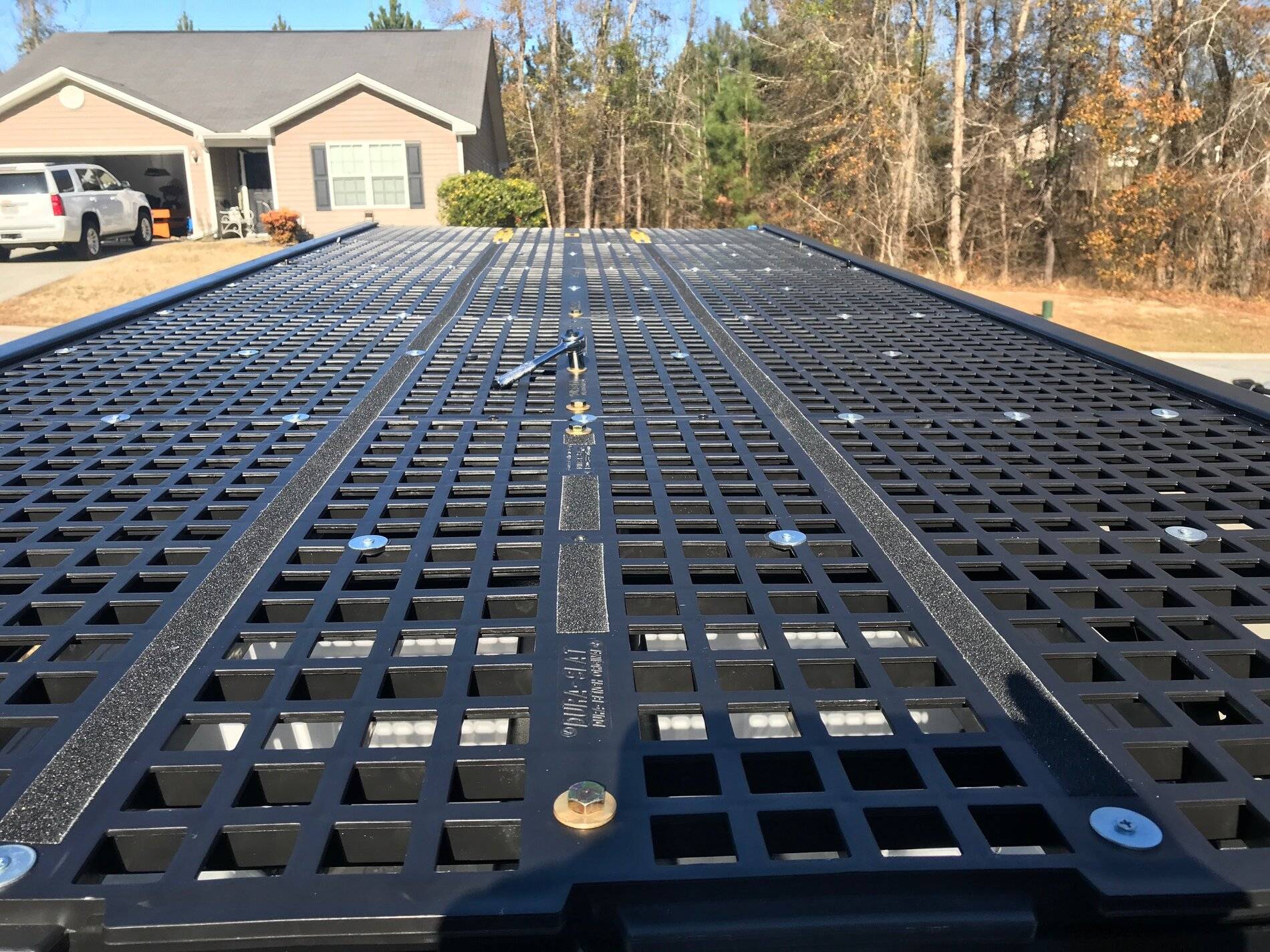

This thread is super old FYI. The solution ended up being an aluminum / unistrut mixture sub-frame and 3/4" dura-slat grating. Its connected to the RCI bed rack via carriage bolts down the spine.
