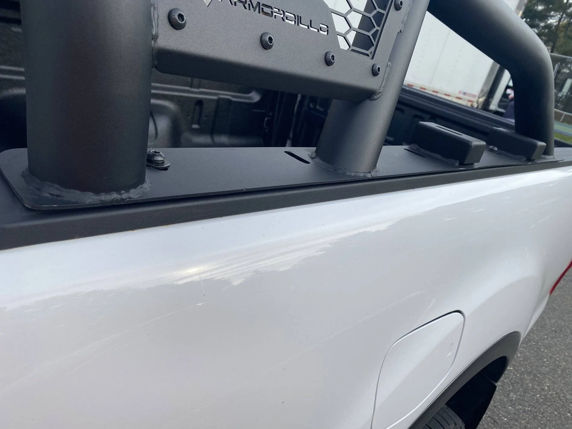

Hello I’m new to this so let see if I can explain this right.
so I recently purchased a 2019 ranger xl which I love. The truck comes with a chase rack I believe it’s called. Does anyone know if there is a bed cover that will fit with a rack.
I have amordillo CR-1 rack.

Lets see the rack and how it mounts to the bed. Can you post a pic?

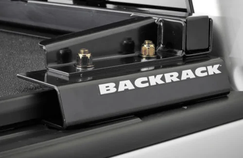

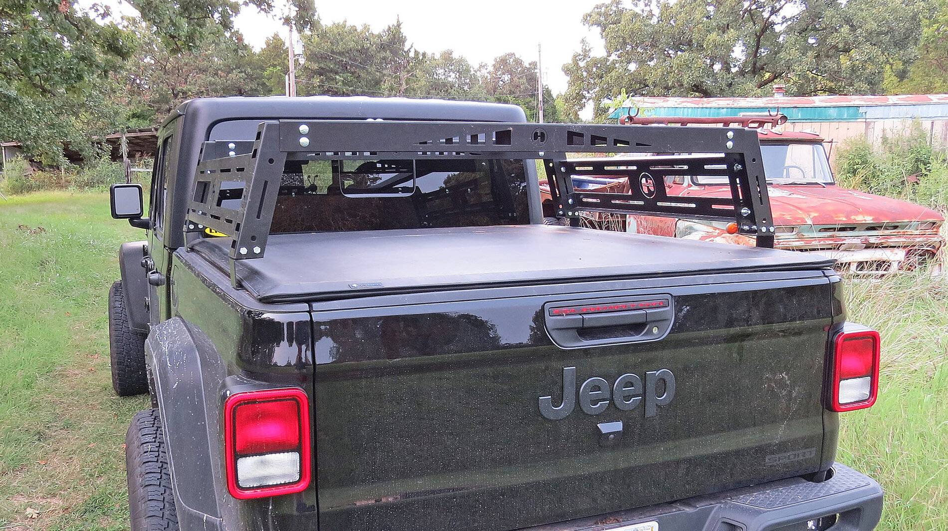

Racks that work with a tonneau cover usually have a "C" channel type of mount to let the bed cover sit on top of the rack base.
Take a look at this Gladiator bed rack and you can see what I mean.
You may be able to either find or fabricate a C channel mount that will work with your existing rack.
@TheDo114 posted a link to some that may work..
