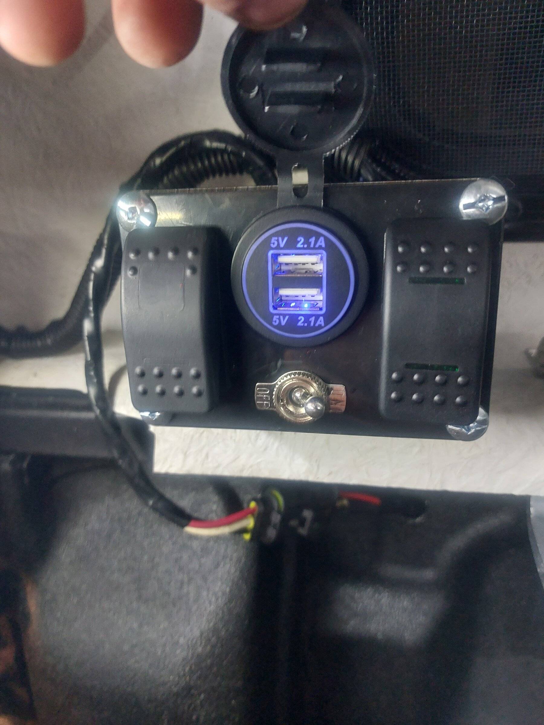

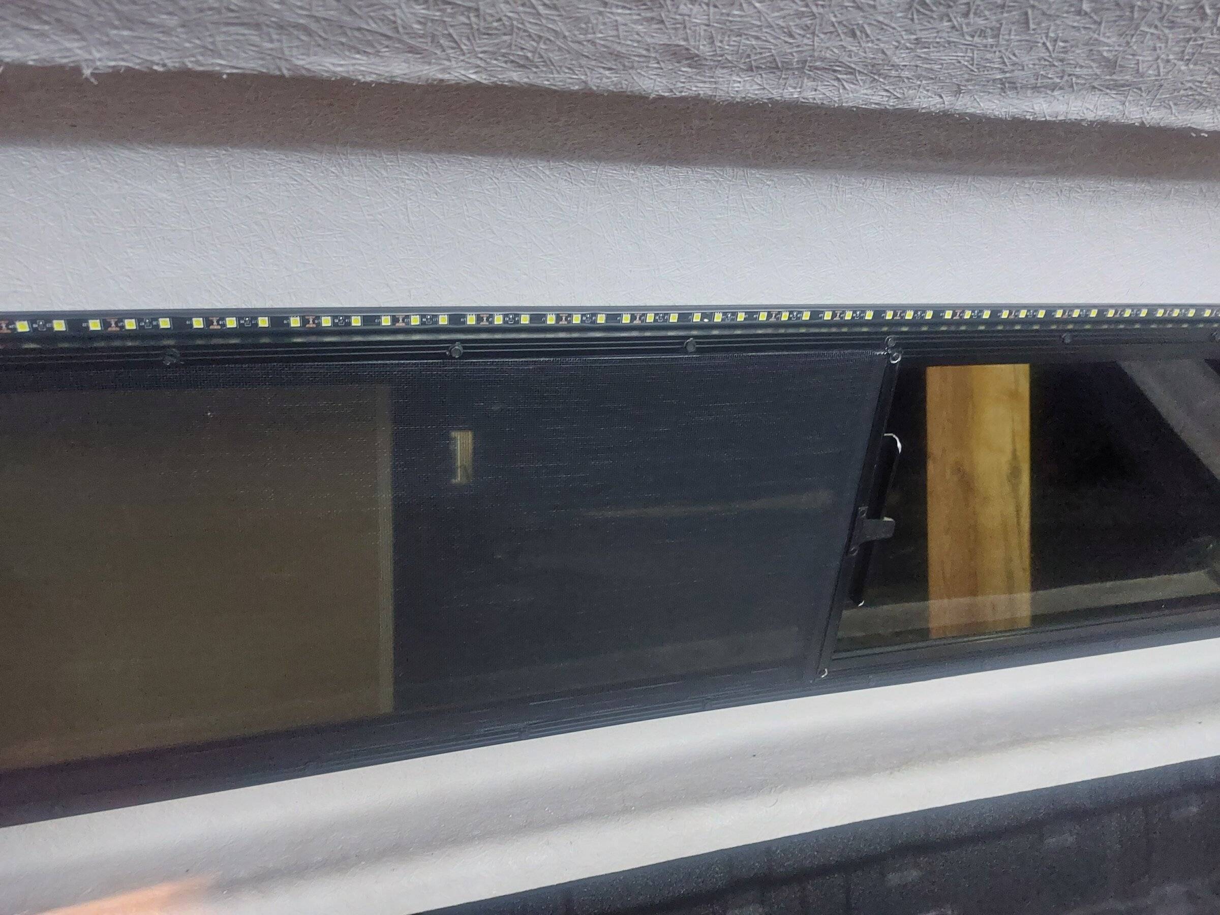

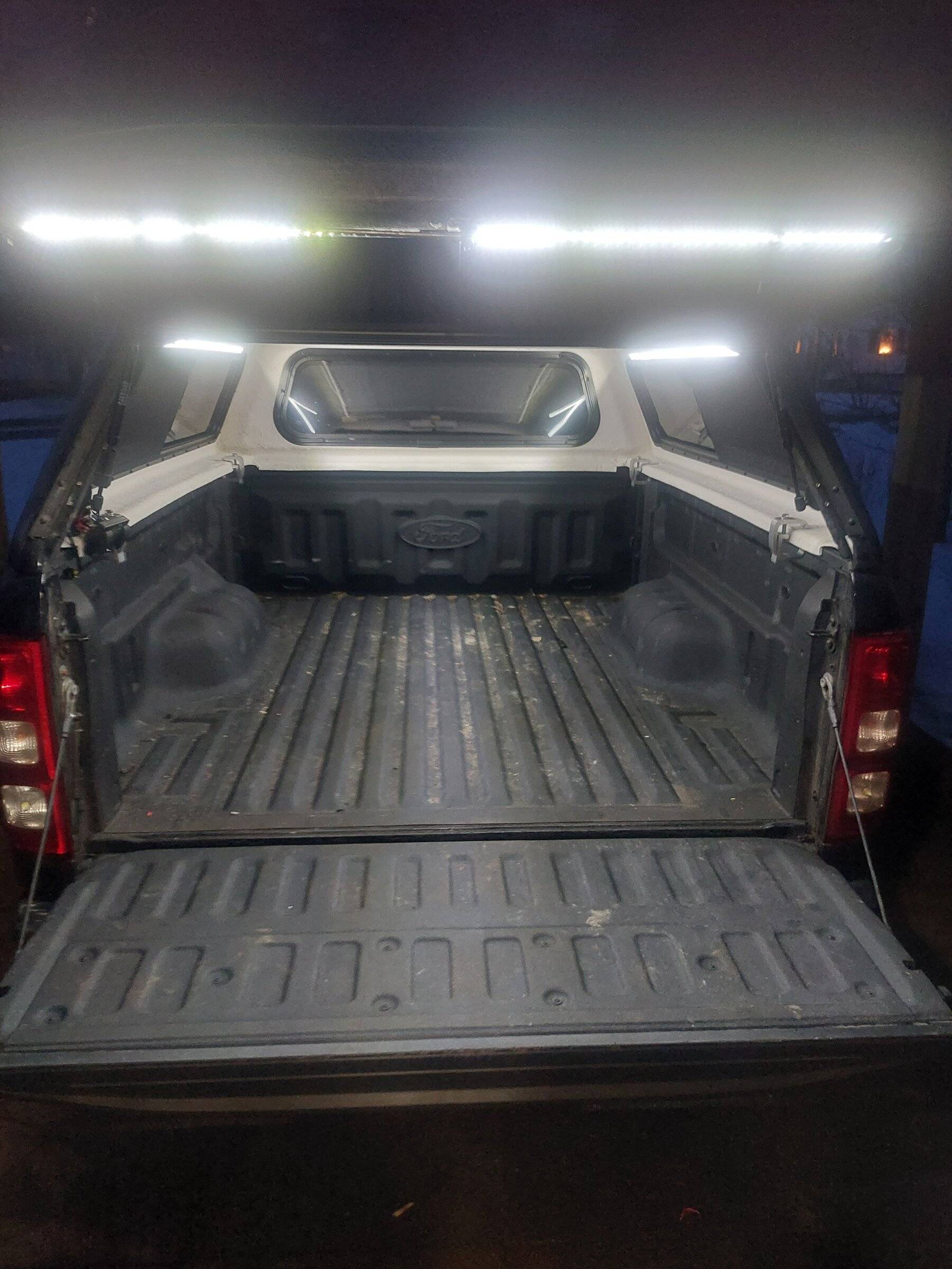

Finally got my topper wired, did an Led strip on the frame of each side window and one across the hatch to light up the tailgate when the hatch is open. Added a switch box with a 3 way that controls On-Off-Door, another switch that turns two strips off to dim things down for reading and stuff when camping. Added a USB port with a toggle switch to turn it off and on and also junctioned the third brake light wires inside the switch box. All plugs into the truck though a weatherpack connector that can be tucked out of the way when the topper is off. Used a prop switch to turn the lights on when the hatch is open.
