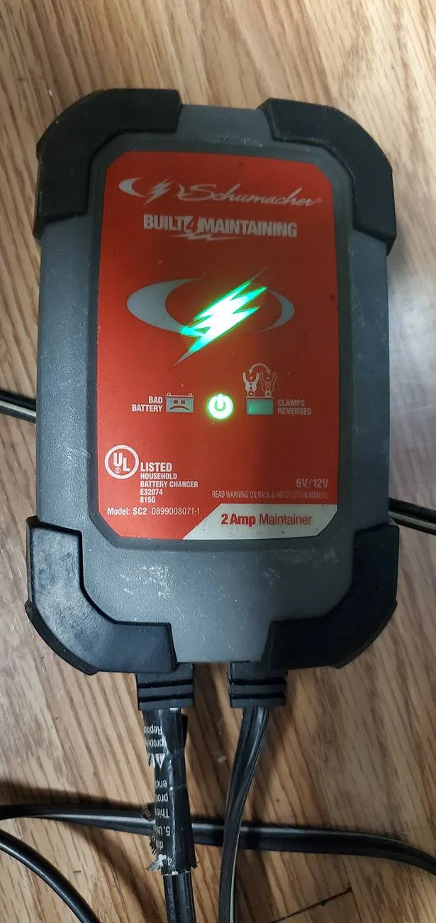

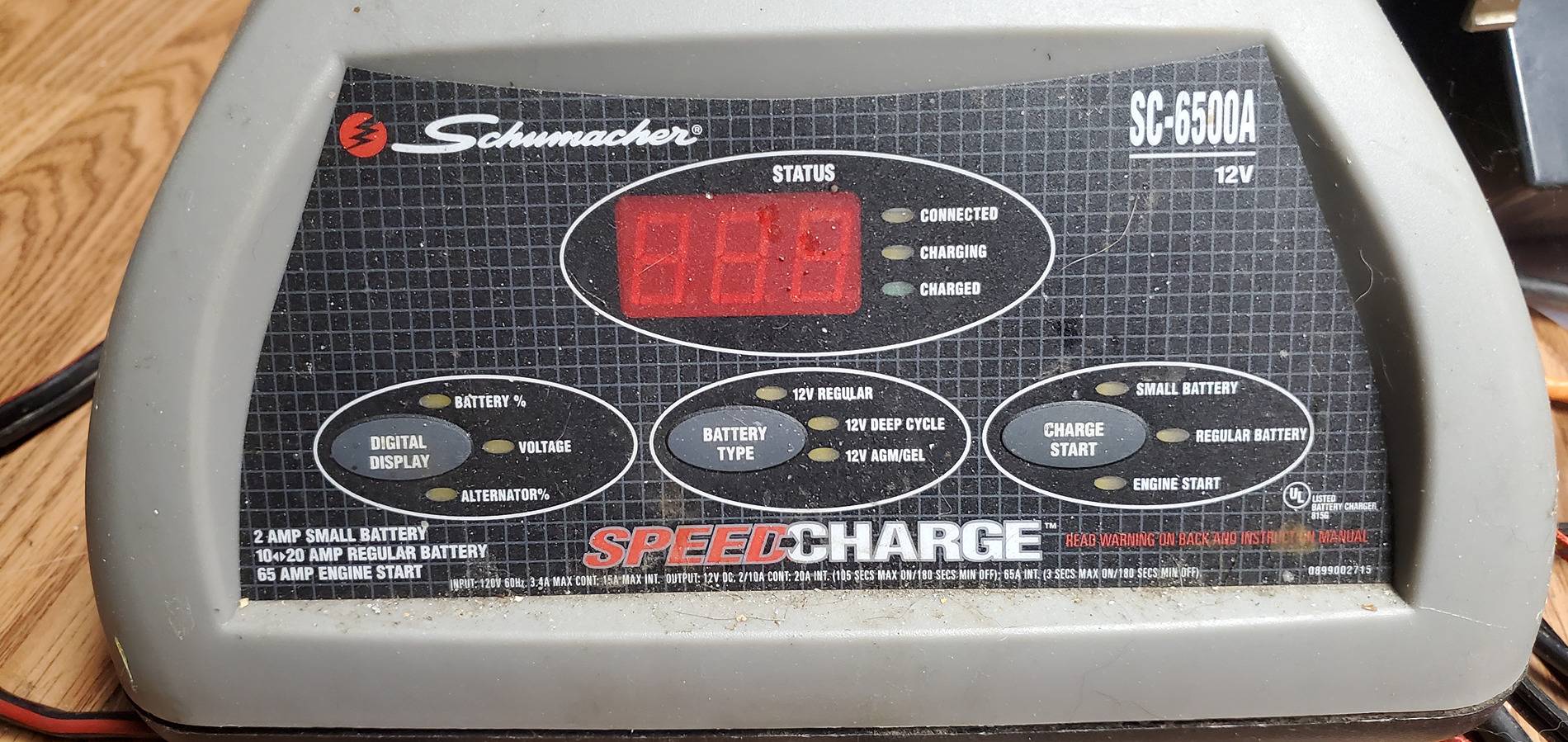

I have three different chargers all Schumacher and have done me well over the years for everything cars, trucks, boats and lawnmowers, some nights in the winter I put the trickle charger on it over night
I even use one to rejuvenate 145AH Telco AGM batteries, 8 of them will run a whole house for a few days without sun they are a Beast!

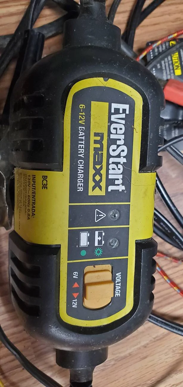

LOL the Everstart Sucks! not worth the $5 at walfart
the big one brings the battery up to 15.7v and holds it for a few min. then drops back to 12.5v and slowly ramps back up to 13.5v and will hold it there (Float - Accumulate) for as long as you need it to.
and damn can I recommend the 145ah telco batteries I put a 2200W inverter on one and ran it for 12 hours with lights and computers and it was still at 12.5v when my time clears up in the new year I will be doing some testing mainly focused on Solar, there is so much miss information out there around batteries, Panels and inverters its not funny, and they guys Hyping that piece of shit EMPshield
