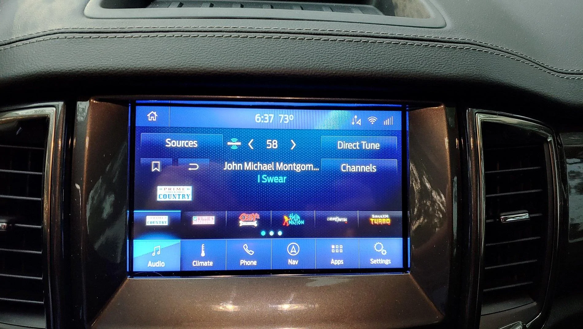

That's helpful, but one more question. If truck connected to Ford Pass, you get an up&down arrow next to a location triangle which are all next to the cell phone icon. Have you ever seen those icons AND the Wi-fi icon at the same time? My theory is that if the Ford Pass icons are up, the Wi-fi icon won't come up...just a theory though ...

Yep. It does. I currently do not have the truck's hot spot on in this pic. Just Ford Pass with location WiFi with the icon turned on while being connected to WiFi at my house.
