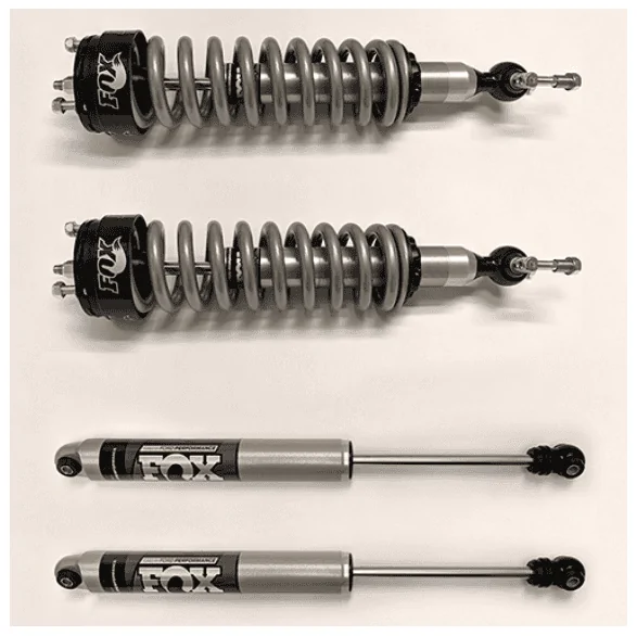

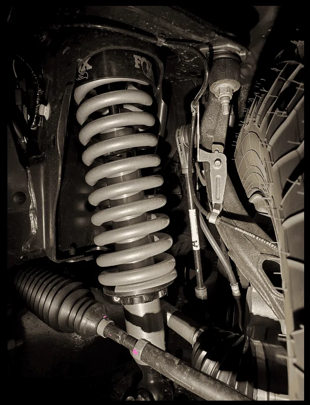

Kit includes both front and rear. Front lift, no rear lift.

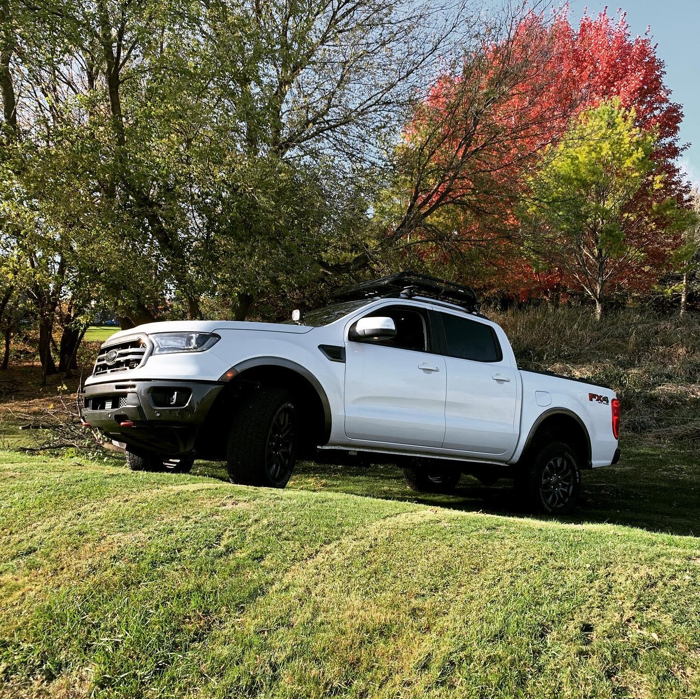

Pic of my 2020.
From Ford Performance . . .
QUESTIONS ANSWERED ABOUT THE FOX “TUNED BY FORD PERFORMANCE” OFF-ROAD SUSPENSION LEVELING KIT
2019-2020 RANGER FOX "TUNED BY FORD PERFORMANCE" OFF-ROAD SUSPENSION LEVELING KIT
Ford Leveling Kit
Benny at @LevittownFordParts.com (forum sponsor) has a good price with no tax if you're out of state. Free or low shipping rates if heavy.
FORD PERFORMANCE FOX SUSPENSION KIT 2.0 IFP OFF ROAD
PART NUMBER: M-18000-RA
Ford Performance 4WD Leveling Suspension Kit
Installation instructions . . .

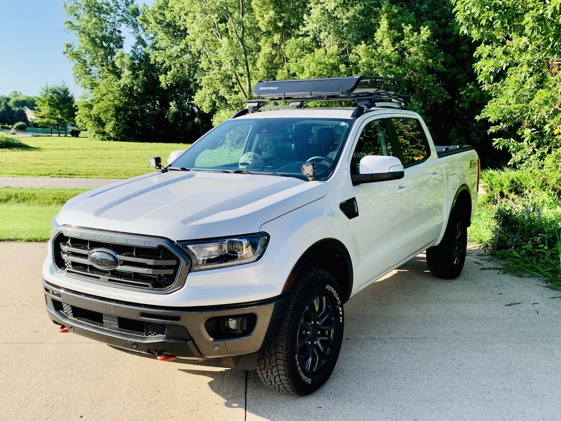

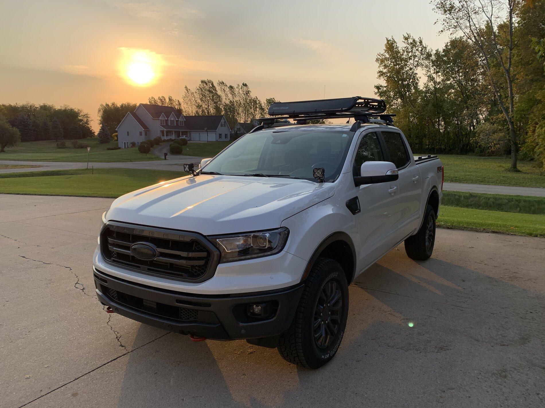

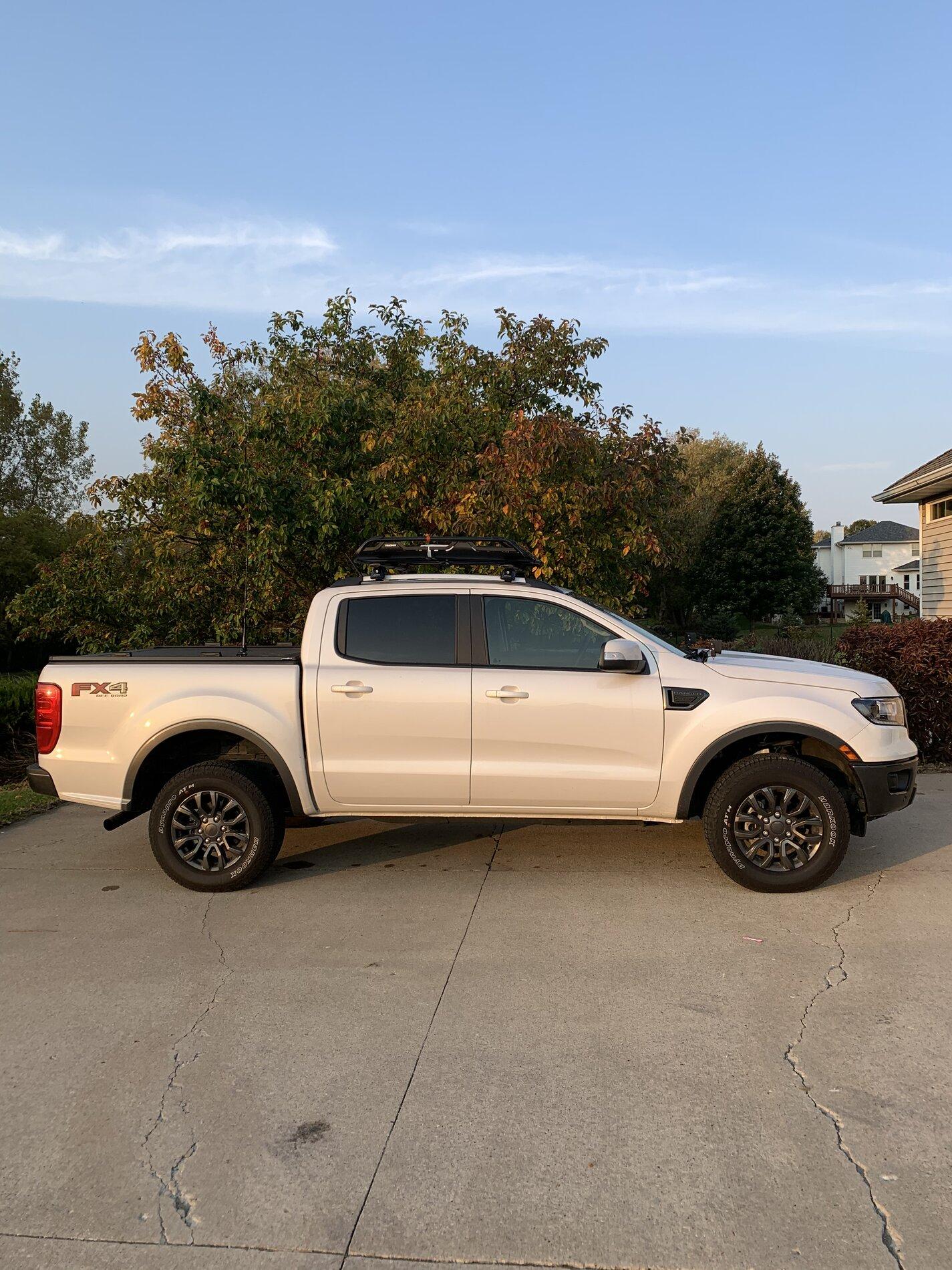

here’s my 2019 lariat fx4. I’ve added the euro roof rails, Yakima cross bars and basket, Ford Ranger Lifts hood bracket light mounts and Retrax bed cover. I’ve also painted the Ford emblems and skid plate/lower bumper valance. I have yet to install the level kit and I plan to ditch the plastic bed cover for a spray in bed liner. Hopefully Santa is good to me and I can get a bed rack system soon.

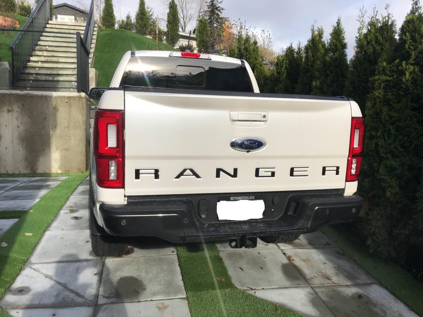

Figured I may as well throw mine in here, now that I finally registered.
2019 Lariat FX4. Bought in March 2019. Came with 501a, FX4, Sport package, 18" wheels, Keypad, Bedliner, Hard Tonneau cover. It's basically how I would have ordered one, except I wouldn't have added the 18" wheels. The best part of the Sport package are the wheels, but it seems every dealer around here gets them in with the optional 18" wheels.
I removed the FX4 decals and ecoboost emblem. Added S/S black letters, mudflaps, weather mats, swing boxes, Rough Country 2.5" level kit, Cooper Discoverer AT3 XLT LT265/70R18, Loadlifter 5000 airbags, a front hitch receiver, and........wait for it.............TAILGATE DAMPER!
Crappy pics, but to lazy to get better ones.

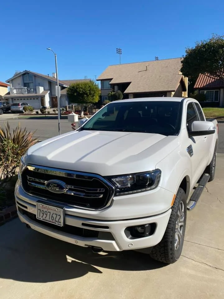

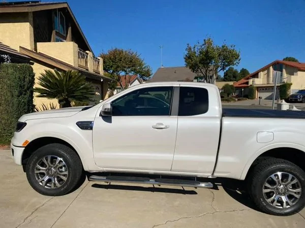

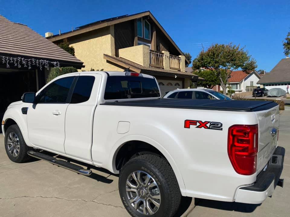

Sorry I am late but here are some pics of my new 2020 Platinum white Lariat Supercab FX2
500a
Tech package
Tow package
Amorflex Cover
LineX
Bedtred Impact Mat
Iconic running boards
70% 3M Crystalline Windshield tint
40% 3M Crystalline Drivers and Passenger door tint.
I got my truck on July 16th after waiting almost 5 months for Ford to build it.
I just turned over 1,000 miles on her.

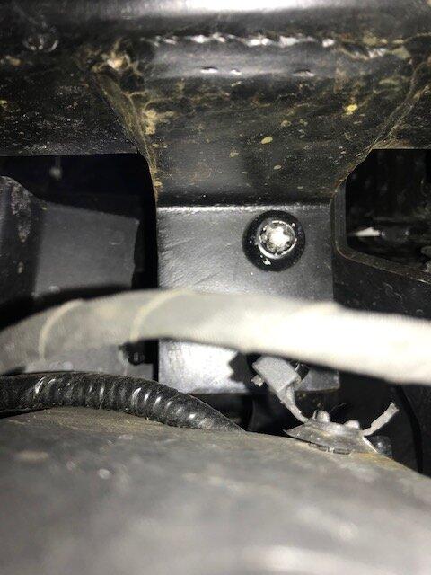

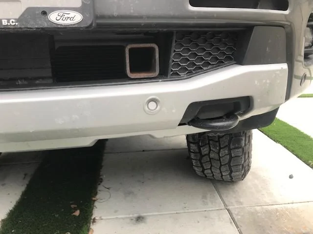

Here's a few pics of the receiver. It wasn't possible to get pics of how it bolts to the frame rail without removing the front skid plate, so the pdf shows how it was built.
Sorry, but I can't remember the sizes the metal used, but if you look at the pdf, I used a piece of C-channel that fit around the frame rail and on the upper and lower ends of the channel and welded flat bar (vertically) to accept a couple bolts. Then I cut a piece of plate steel for the opposite side of the frame rail so I could bolt the 2 pieces together and "sandwich" the frame rail.
2" tubing was cut and welded, so the receiver would end up where it did.
I also added a front support tab. I think it bolts to an existing oem hole, but can't fully remember. I may have had to drill a hole?
I plan to do an oil change soon, so when I do that, I'll see if I can get better pics.

Thanks.
Looks like it'd work for some light duty stuff.
I'm looking for something to winch off of. Think I want something a little beefier.

No, I wouldn't winch off it. I only need it to move my boat in/out of the garage.
I've been thinking of getting a winch and if I decide to go with a receiver mount, then I'll need to remake it. If you can cut metal and know how to weld, then it wouldn't be too big a deal to fab one up.
