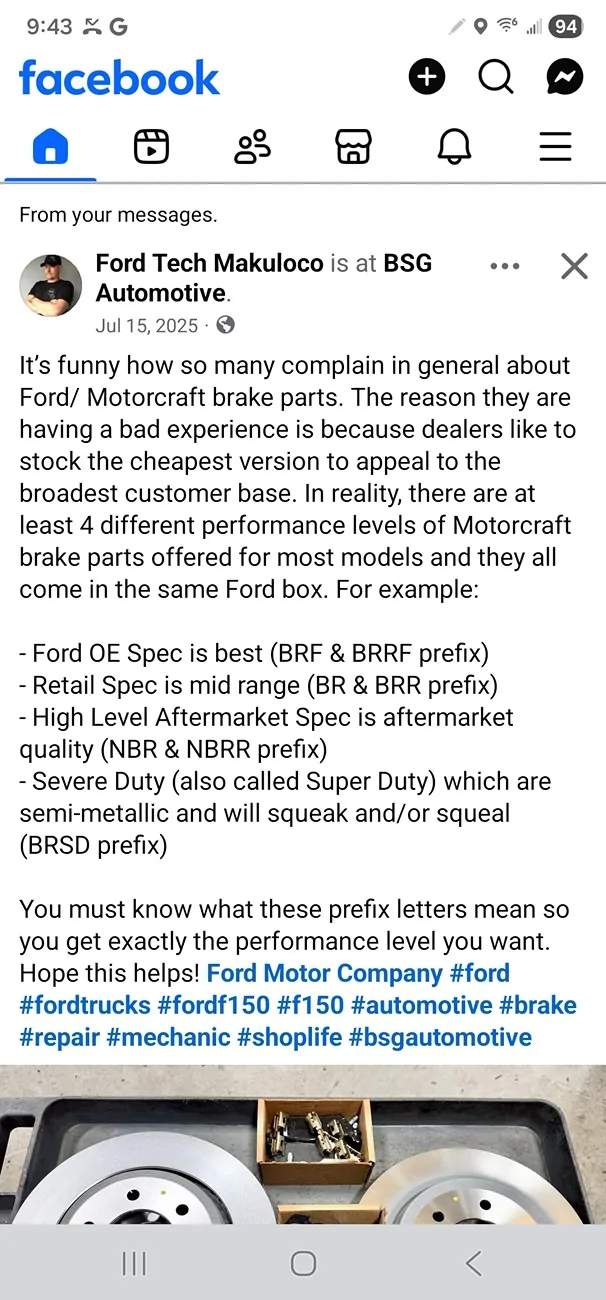

Andrew27
Andrew
Aug 24, 2022
93
403
Missouri
23 Ford Ranger, 95 Ford Explorer, 98 Ford Ranger
Auto Technician
The part numbers with the F in them are the factory versions.
