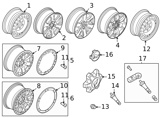

Any one know if the studs and lug nuts are the same for the factory steel wheel the Factory aluminum wheels?
In other words can the lug nuts that came with the OEM Aluminum wheels work with the OEM steel wheels without bottoming out on the studs?
Or do I need to change the stud lengths?

I'm setting up some pizza cutter tires on steel wheels and wanted to make sure I wouldn't run into trouble going from Alloy to Steelies.
Thanks for the reply.
I can check when the steelies get here too - But good to know up front.

Chances are the lugs may be a little different between factory steels to factory aluminium wheels. Comparing to aftermaket wheels there is a high chance they require a different lug nut. As for the studs yoy will be fine

Hi Chris,
For Ford testing, the aluminum wheel at each corner is removed and the spare tire is installed and the vehicle is put through its paces on the handling track, evasive accident avoidance, lane change etc. The lugnuts used for the test came from the aluminum wheels..so it has to work. The steel wheel cone is still at 60° angle so the test ensures that the studs do not bottom out before the wheel is tight.

Good thread and glad I found it since I had the same question! I tried looking on Ford parts diagrams online, from what I see it looks like there is only 1 lugnut (#13 in the diagram) for any of the steel or alloy wheels except maybe beadlocks.
