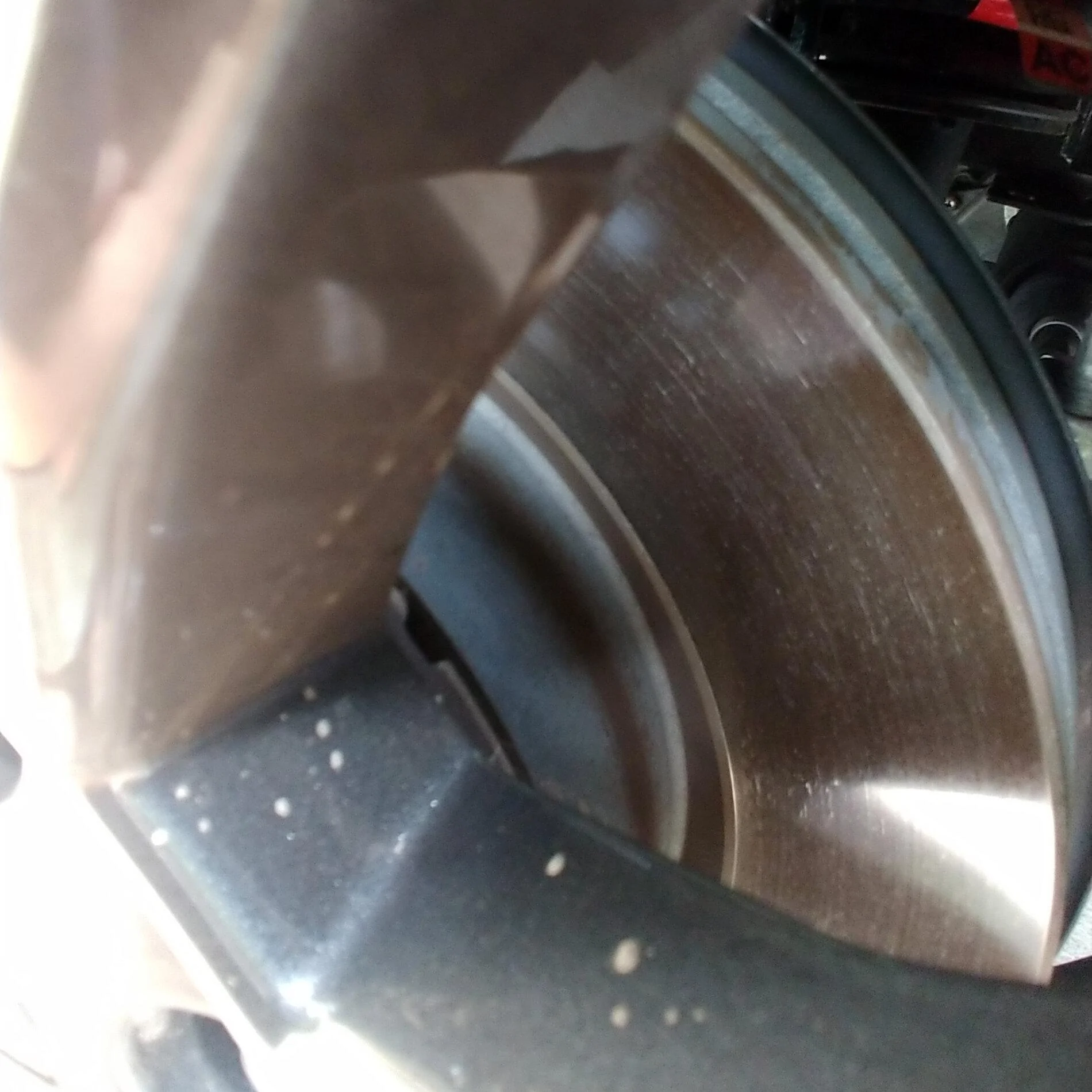

Mine has a slight low squeal at very low speeds.What could be the cause? It has ~3000 miles on it, so it cant be wear as I don't break hard or ride the brakes. I did do the bedding in process on the truck early due to the sponge like feeling of the brake pedal.

Hi Jason,
Not normal. As a start, since you can see your rotors through the wheel, what do they look like, Nice smooth and shiny? Blueish (heat and needs attention)...Grooved our scored(Something that needs attention). Also, check the brake heat shield if you can for a rubbing condition... I think the heat shield is likely your issue. How handy are you? Pull the wheel that is suspect for a better inspection or have the dealer do this under warranty.
Good luck!
Phil Schilke
Ranger Vehicle Engineering
Ford Motor Co. Retired

Thanks Phil.
I think you are correct as it may have been the dust shield. A slight pull on one of the dust shields felt a bit odd. I checked it for clearance all around. Will monitor it this week, specially in the morning as this is when I hear it mostly. The rotors look good no grooves, or blueish spots, and feel smooth to the touch with even coloring/wear. Worst case, I will pull the wheel and inspect further.
