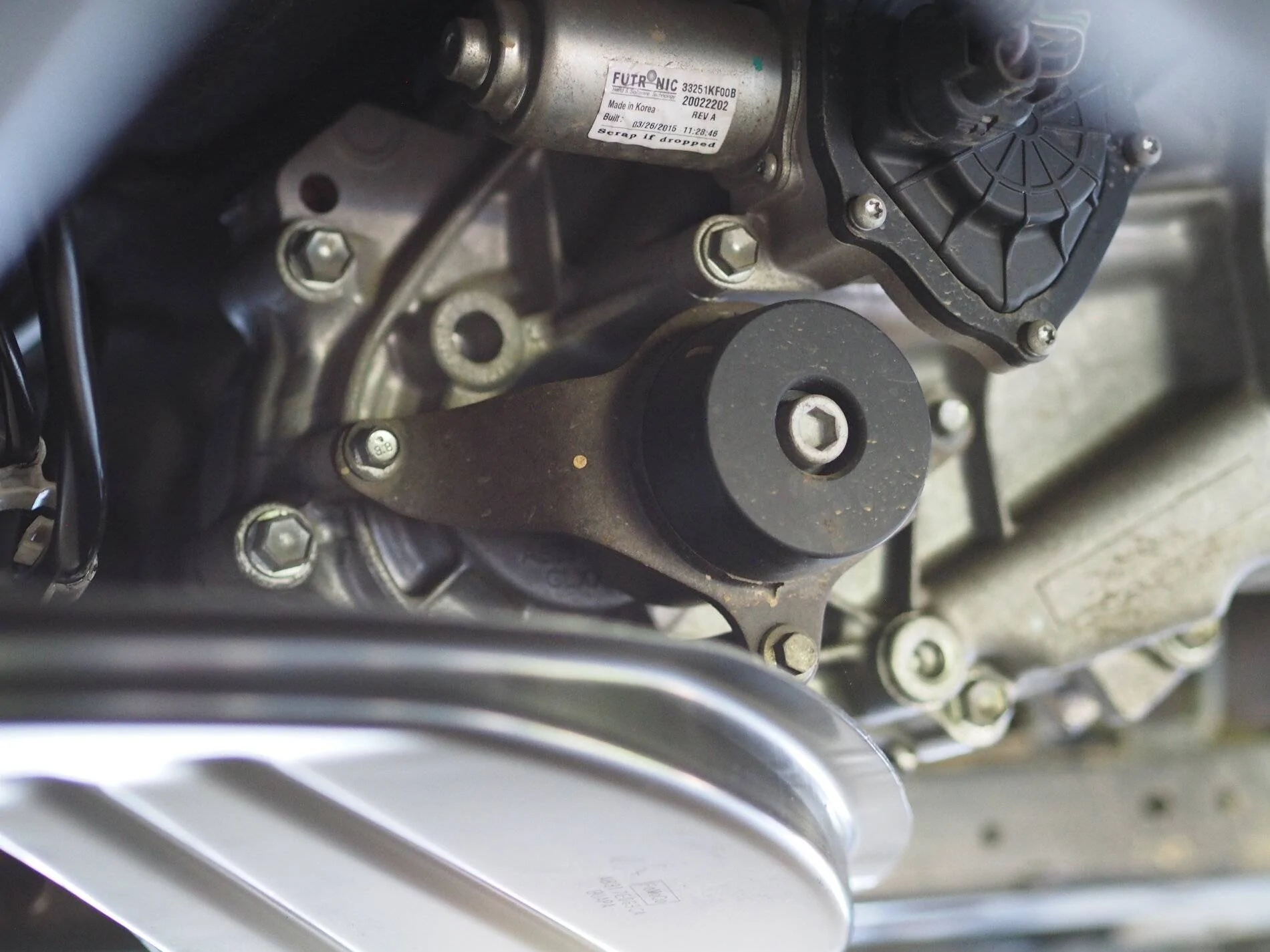

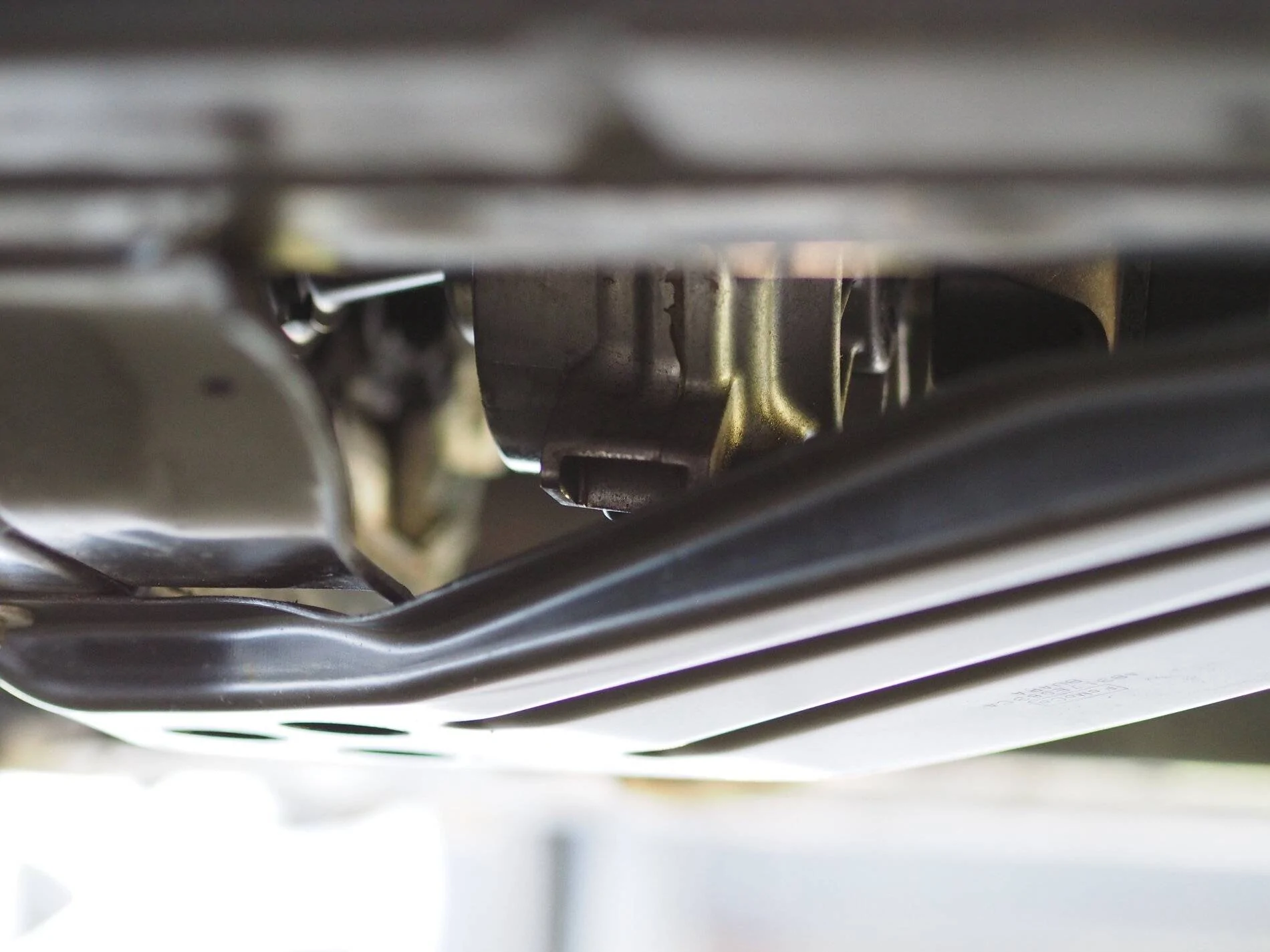

The front driveshaft on my transfer case began to weep slightly for the last few months, and after returning from a recent camping trip I noticed it had actually developed into a drip - not a lot, but annoying none the less (drops on garage floor). My vehicle has done 99,000 Km ~ 60,000 miles.
A quick look around the Australian Ranger forum showed this to be not uncommon amongst PX1 Rangers, the seal was revised it seems, for PX2/3 series.
I considered fixing it properly, but that involves removing the bash plate, undoing the flange nut which Ford employs lowland gorillas to do up to a gazillion foot pounds of torque, and paying a small fortune to Ford for the part, as the revised seal has to be bought with a new driveshaft flange which had to be ordered in.
So I thought I would try Max Life. Drained out just over a litre of very dirty ATF, - so much for filled for life! Replaced with new fluid, cleaned up the mess and waited and watched.
Voila! two weeks later leak stopped! I'm impressed, a product which lived up to it's claims.
