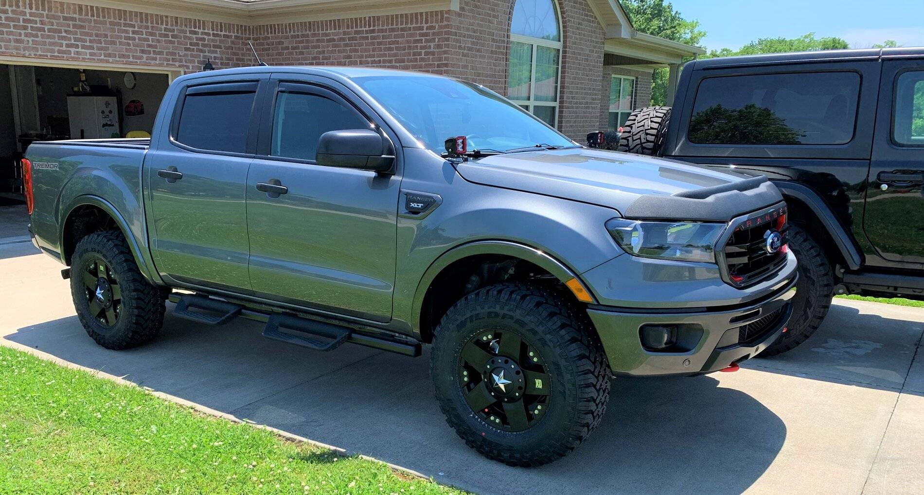

With my new P285 70 17 Wildpeak AT3Ws my speedo is only off by 3 mph at 50 (When speedo shows 50 you are actually going 53 mph). I couldn't be happier with that. I'll adjust it with Forscan soon as I get up the courage to play with that..

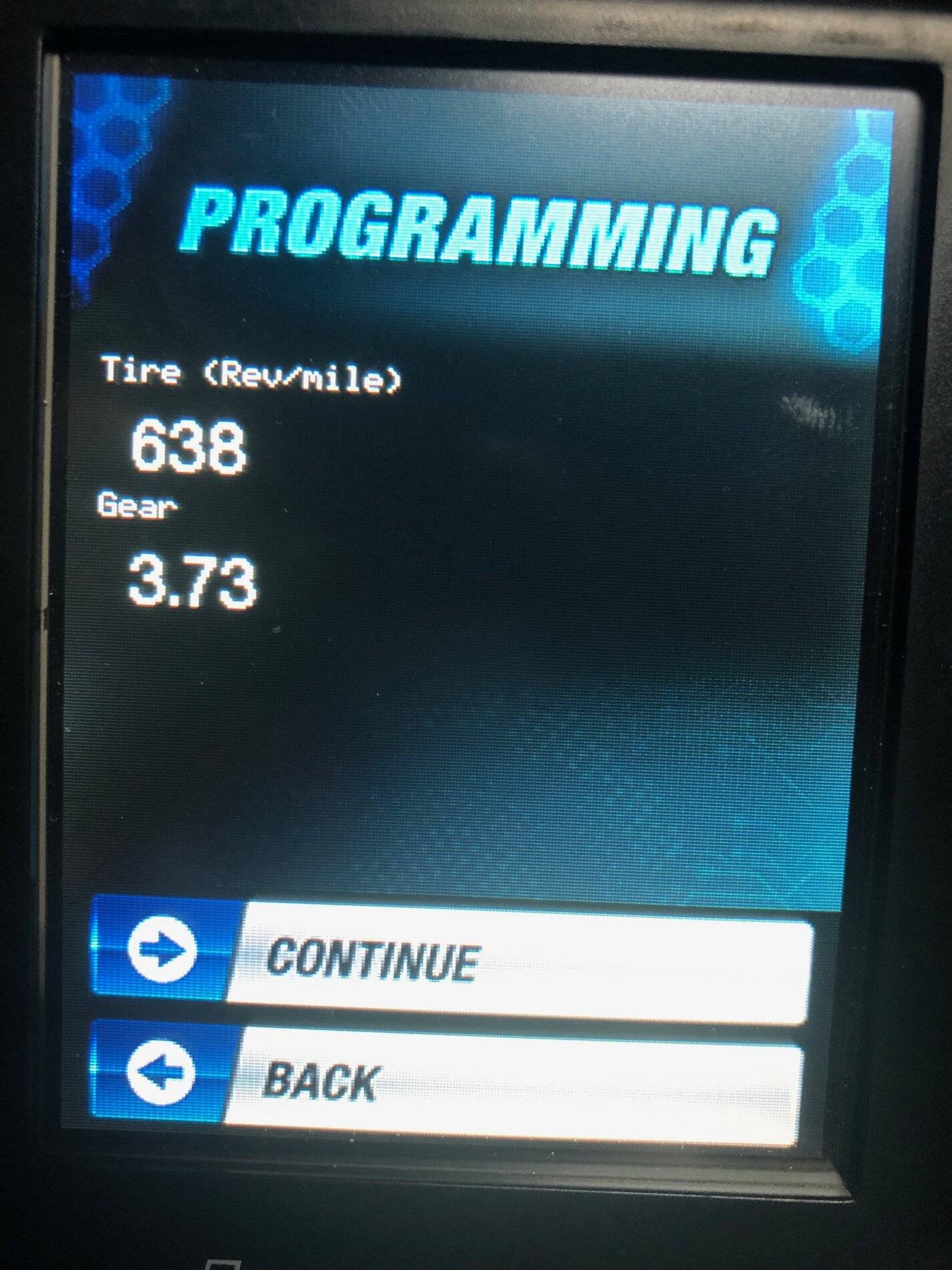

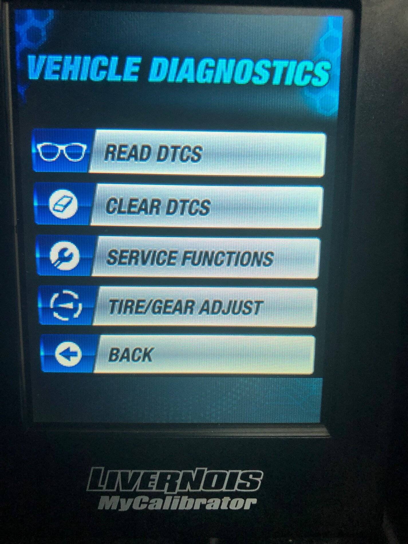

IIRC a few have asked their dealers and they wouldn't do it but I guess if you knew your service manager good they might. You can also correct it with a tune so it's a good excuse to get one. ;)
Edit: With the tune you just hook it to the ODB port and use the touch screen to get to the tire adjustment page. From there you just enter in the numbers. It's really easy and little to no chance of messing it up and I probably would with Forscan.

I just edited my post but it's really easy to do with the tuner. I went up to 265/70 R17 and changed it to 660 on the tuner and now I'm very close, within 1 mph. You could always ask one of the younger neighborhood kids to help you out. ?
