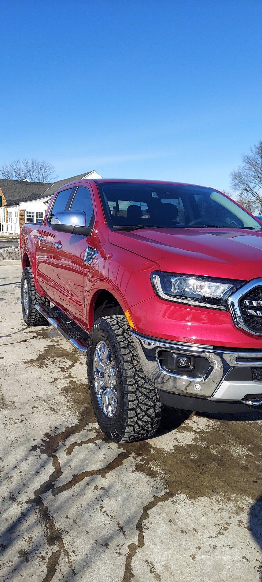

I installed the Ford Performance 2" lift and a 1" rear block. I'm keeping the stock 18" wheels, what size tires can I fit on it with no rubbing or having to modify crash bars? Any help would be appreciated.
265 65 18

This is the direction I am going (at some point) ...take a look at the Cooper Discoverer AT3 XLT - LT285/65R18 http://us.coopertire.com/tires/discoverer-at3-xlt
I have those tires, except in a 265/70/18. Really like them. I only have the 2.5" level kit and no rubbing, and no alterations.
They are about the same distance from the knuckle as posted by SVTchad. The 1/4~3/8" clearance doesn't bother me as that is the top of the tire so there shouldn't be much if any flexing there. 4000mi (with some off-road) and no rubbing.
