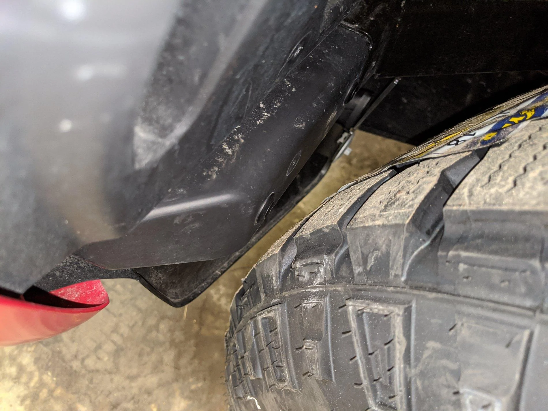

We Installed the 275/65 18 Duratracs and they are extremely close to rubbing on the bumper bracket. I think it's too close for comfort so I guess I'm back to the drawing board.

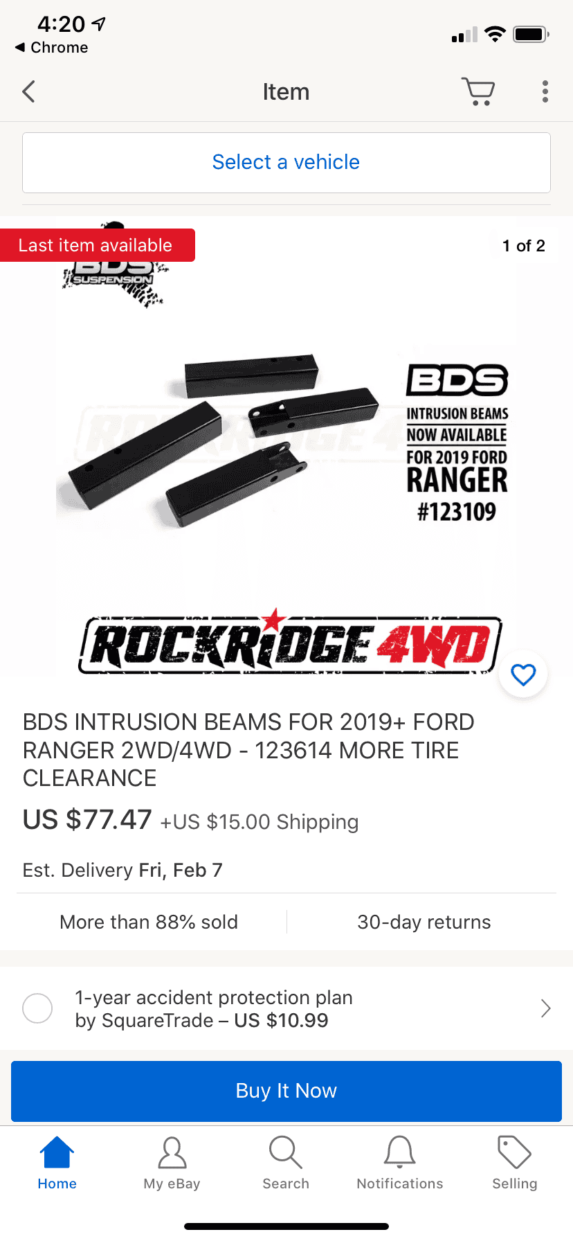

You can loosen the crash bars and move them forward some with the help of a big hammer.
Also, BDS, FabTech and ProComp sell modified crash bars.

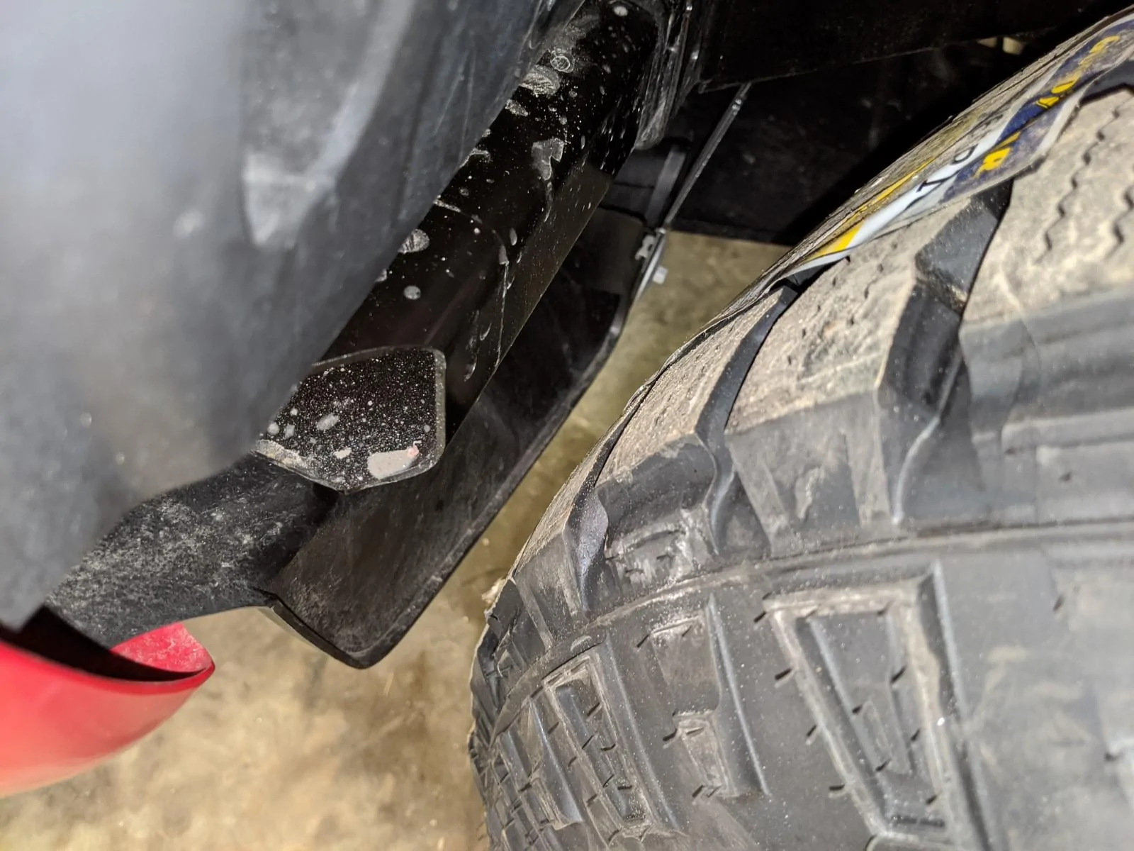

We removed the plastic and were able to move the bar enough that there is enough room now.

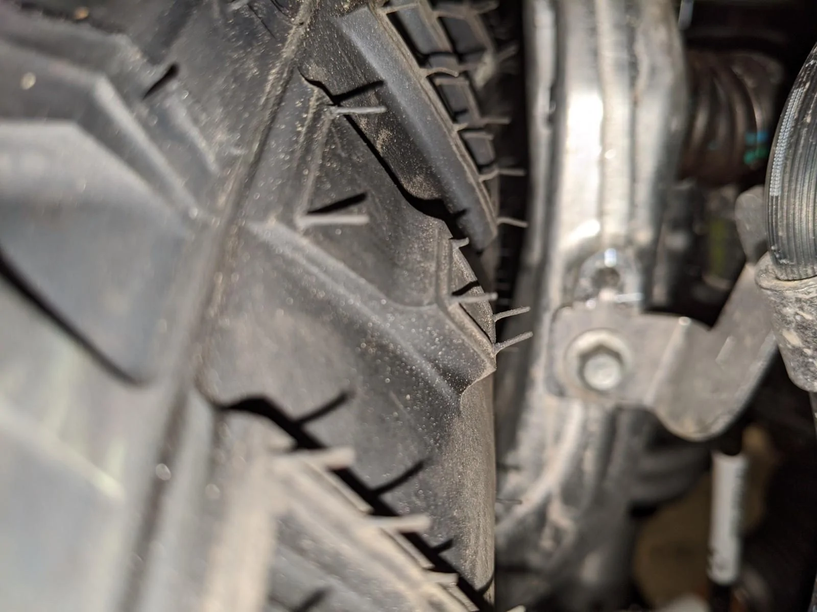

New problem now though. The tire is extremely close to the knuckle. I can't even fit my finger between. My worry is if the tire flexes at all it will rub.

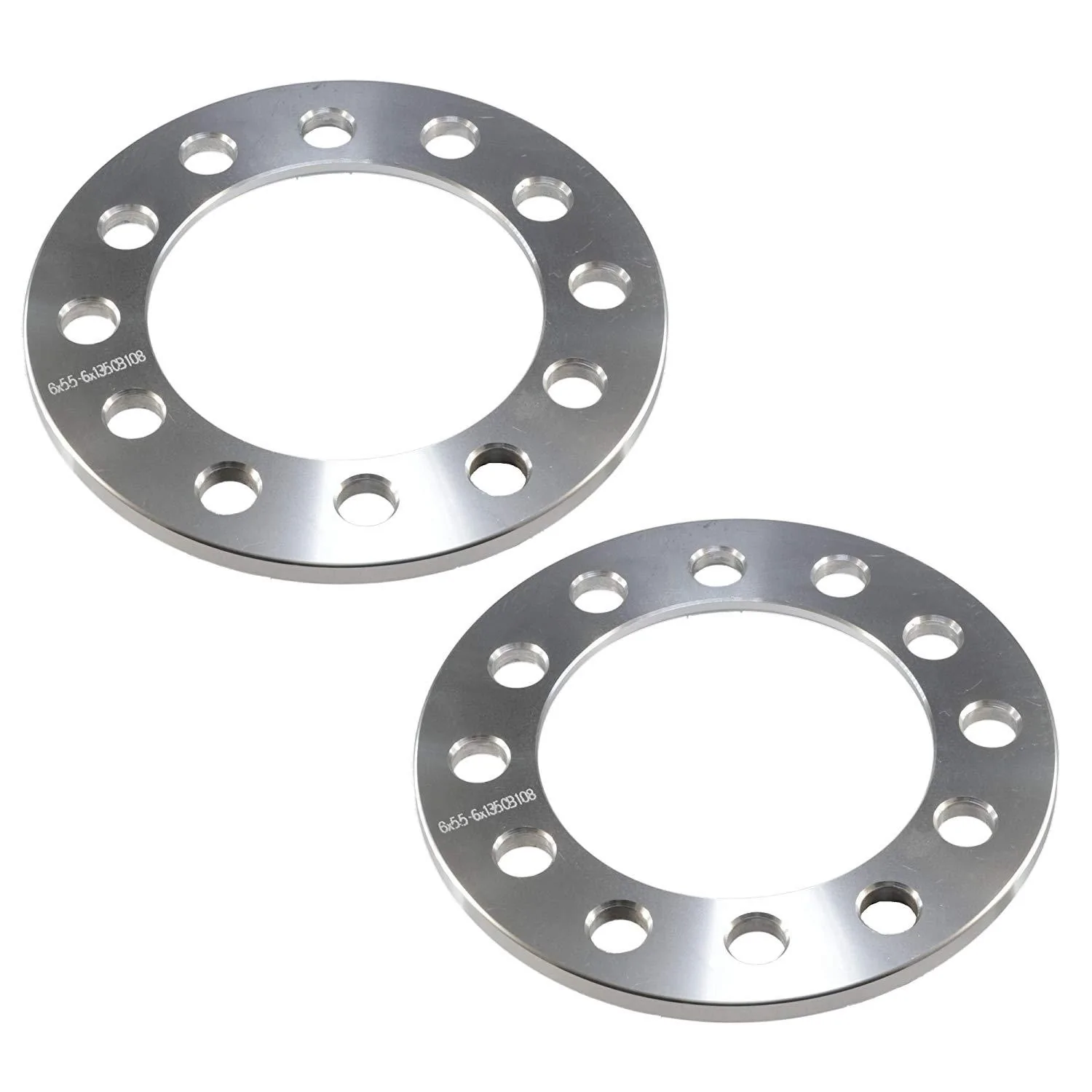

Several on here are using THESE to space the tire out by 1/4".
They will work with the stock wheel studs.
I'll see if I can find the thread and link it too.

I've never liked the idea of spacers. Being able to use factory studs and nuts does make it more appealing but I've seen some horror stories over the years with wheels falling off.
