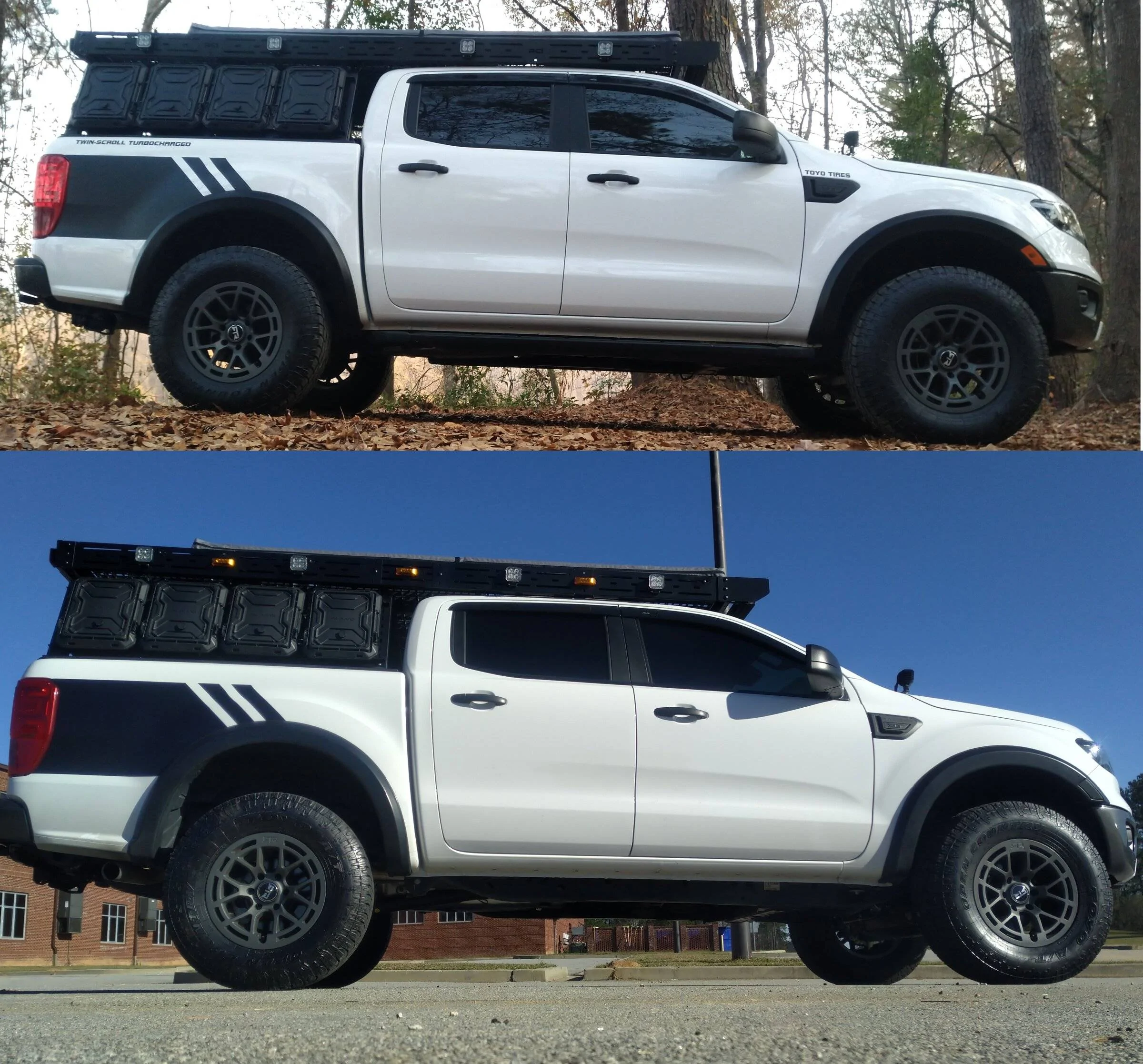

Well I got the rear shocks on and the 1" rear blocks.
I installed the blocks the opposite ways of most videos online (raise truck, drop the diff and axles). I took the u bolts / brackets off while it was on the ground, then used a floor jack (with a stack of 4x6 wood on top)on the the rear hitch to raise the frame up to slip them in under the leafs.
Took it for a test ride. Much better, no more Cadillac boat ass. As far as visually, its subtle, but I can see the difference.
The front shocks & springs once installed will take me from a 2" to a 3".
