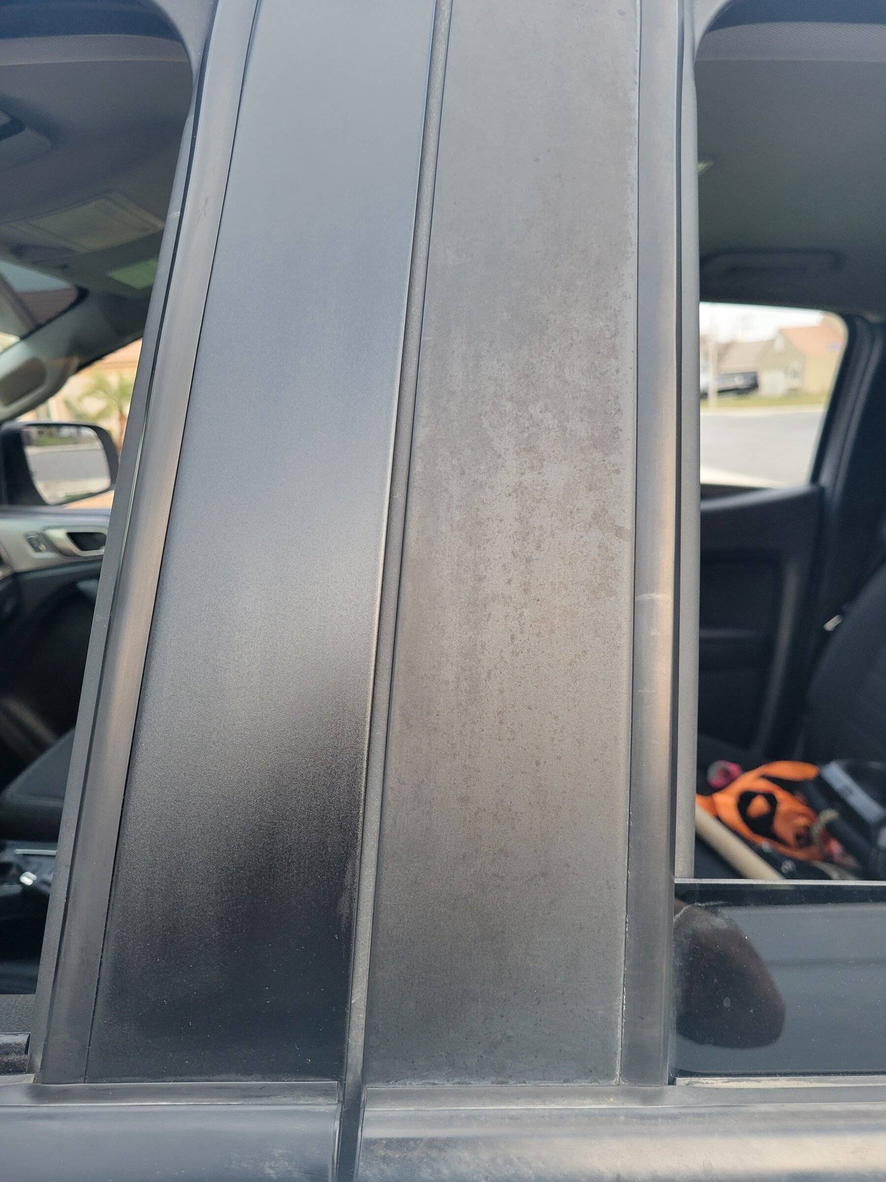

So idk if it's just mine or others have the issue where the exterior door trims fade into a somewhat white color. I've tried several products today I said fuck it, and grabbed some Teflon grease and sprayed it on the moldings. As you can see driver door vs rear passenger door. Did pretty good. Then sprayed mink oil on all rubber seals and interior panels. Avoid any petroleum oils on any rubber it will swell and turn gummy.

The strips between the doors can be removed and the body color is behind them. If you want to leave them in place I use the 303 Aerospace Protectant on mine and it keeps them from fading. Also use it on all the rubber trim pieces to keep it from drying out and fading.

O nice I may order some. The Teflon grease was what I had on hand from work. All other commercial products from say Walmart and autozone would continually fail to bring the color back.

As mentioned, those plastic looking covers are actually stickers from my understanding lol

I just went our to look and yup they're a textured vinyl lol
