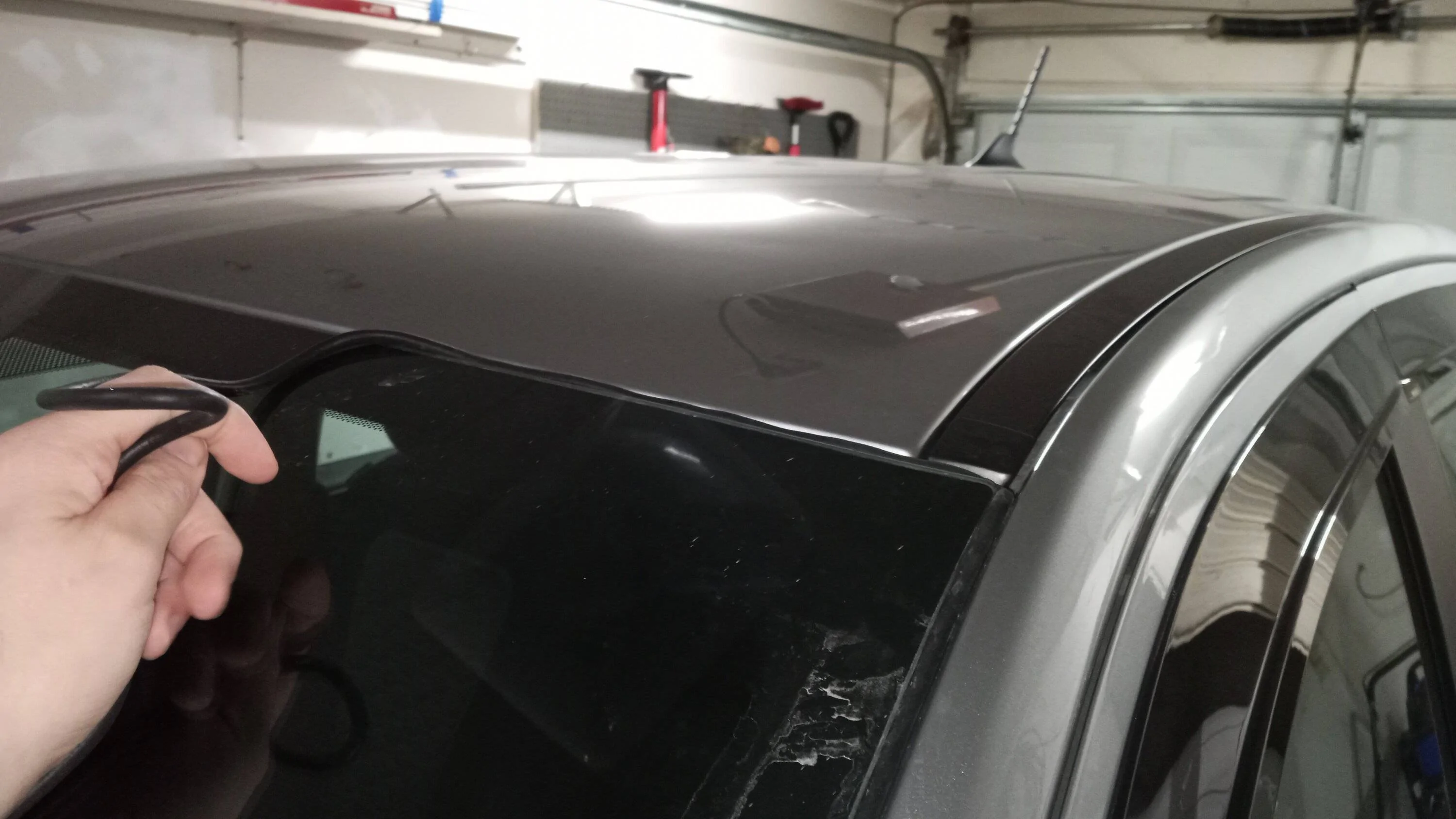

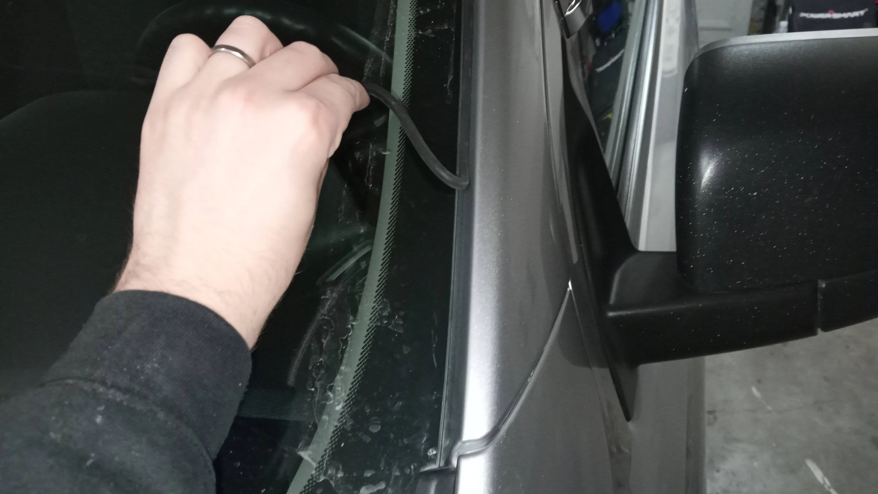

Used molding not meant for this application, and thus project did not go as expected.
The gaps are much bigger than I thoughts.
And yes my hands look deformed, cold weather turns them into crab claws...
Backer Rod was a good and logical choice for what you were trying to achieve - I mean, it’s meant for windows, right? Too bad it didn’t work out.
Yeah, kinda anticipated this outcome. The gap behind the glass is about an inch from between the factory adhesive and the pillar... Ford used bare minimum here.
Ah well, gonna order actual windshield molding once i get all my measurements taken.
