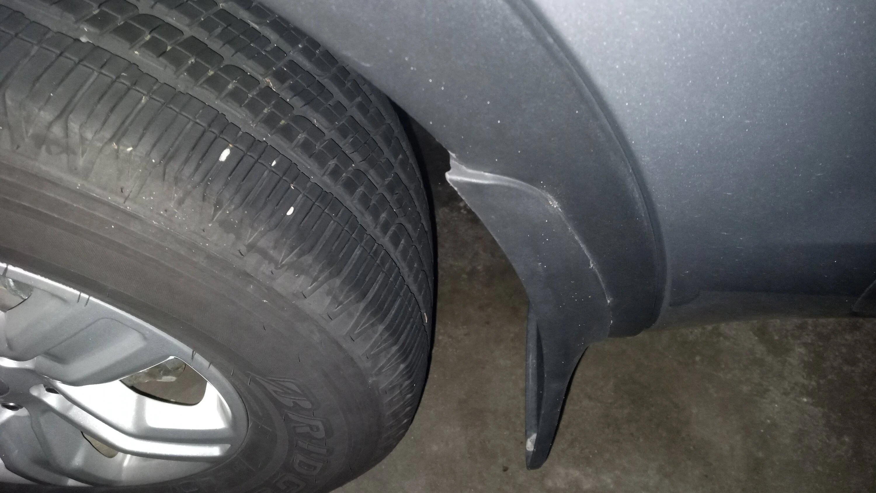

Probably one of the weirder "mods".
My mud guards had oddly sharp "claws" that would usually snag my pant legs, or get my elbow if I was doing wheel well stuff.
Used my rotary tool and some sandpaper.

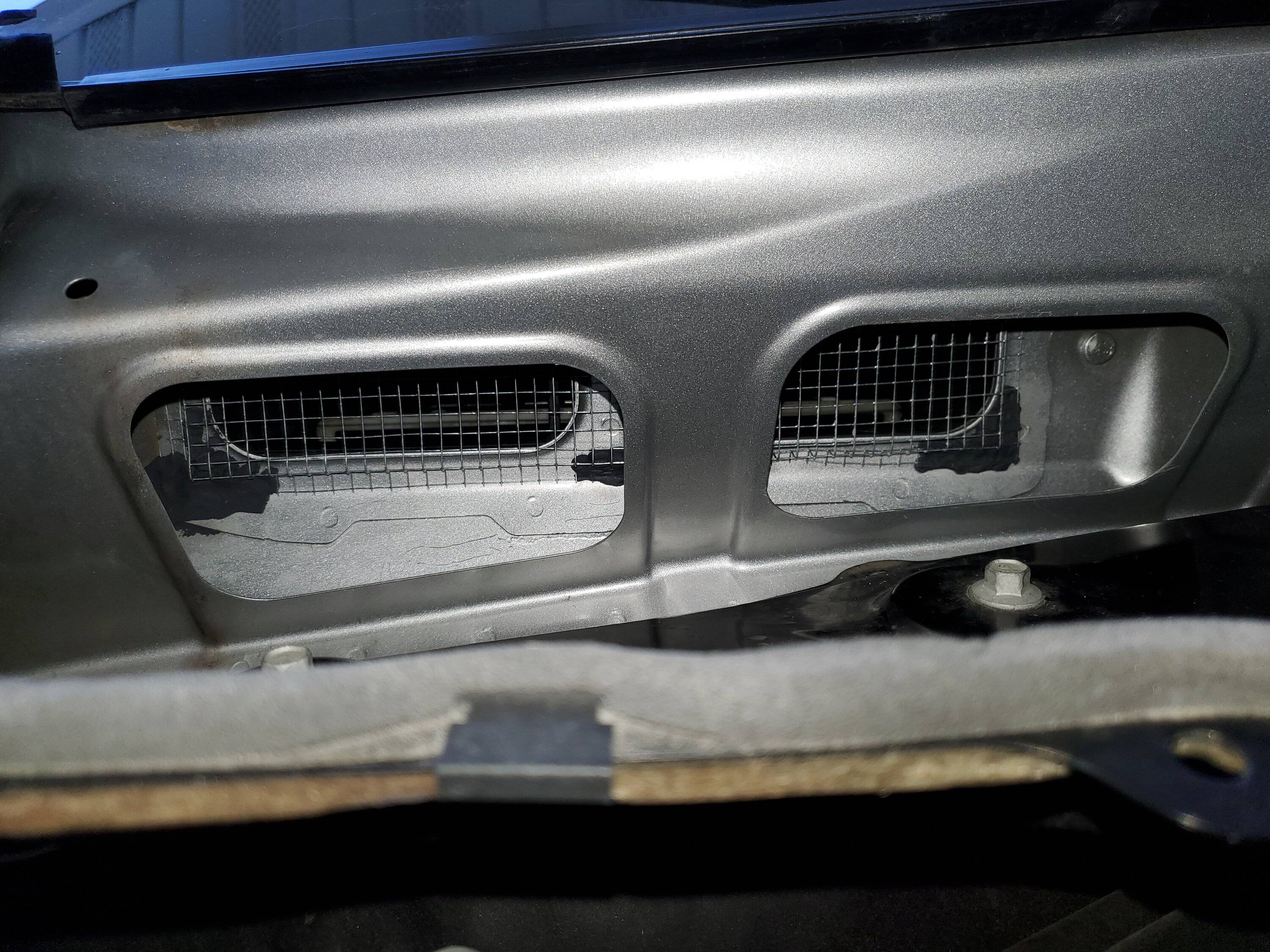

Installed the rodent blocker 2023.

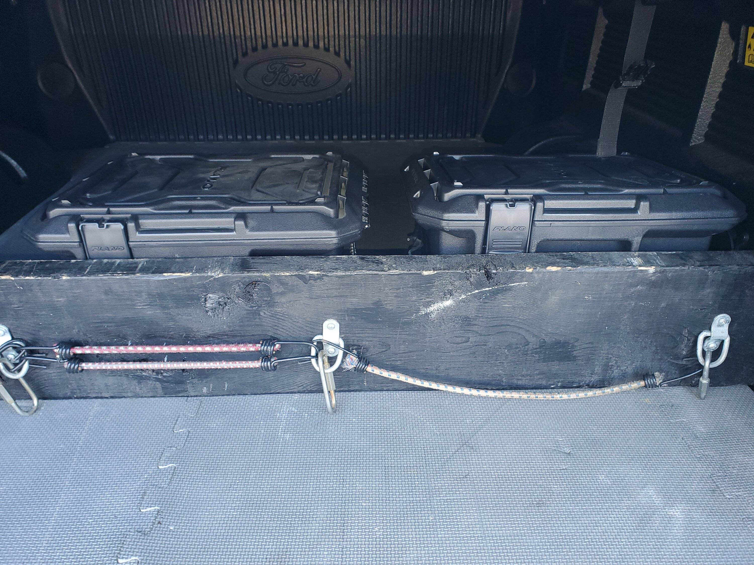

Installed some d-rings on the front side of my bed divider and relocated my Plano storage boxes.

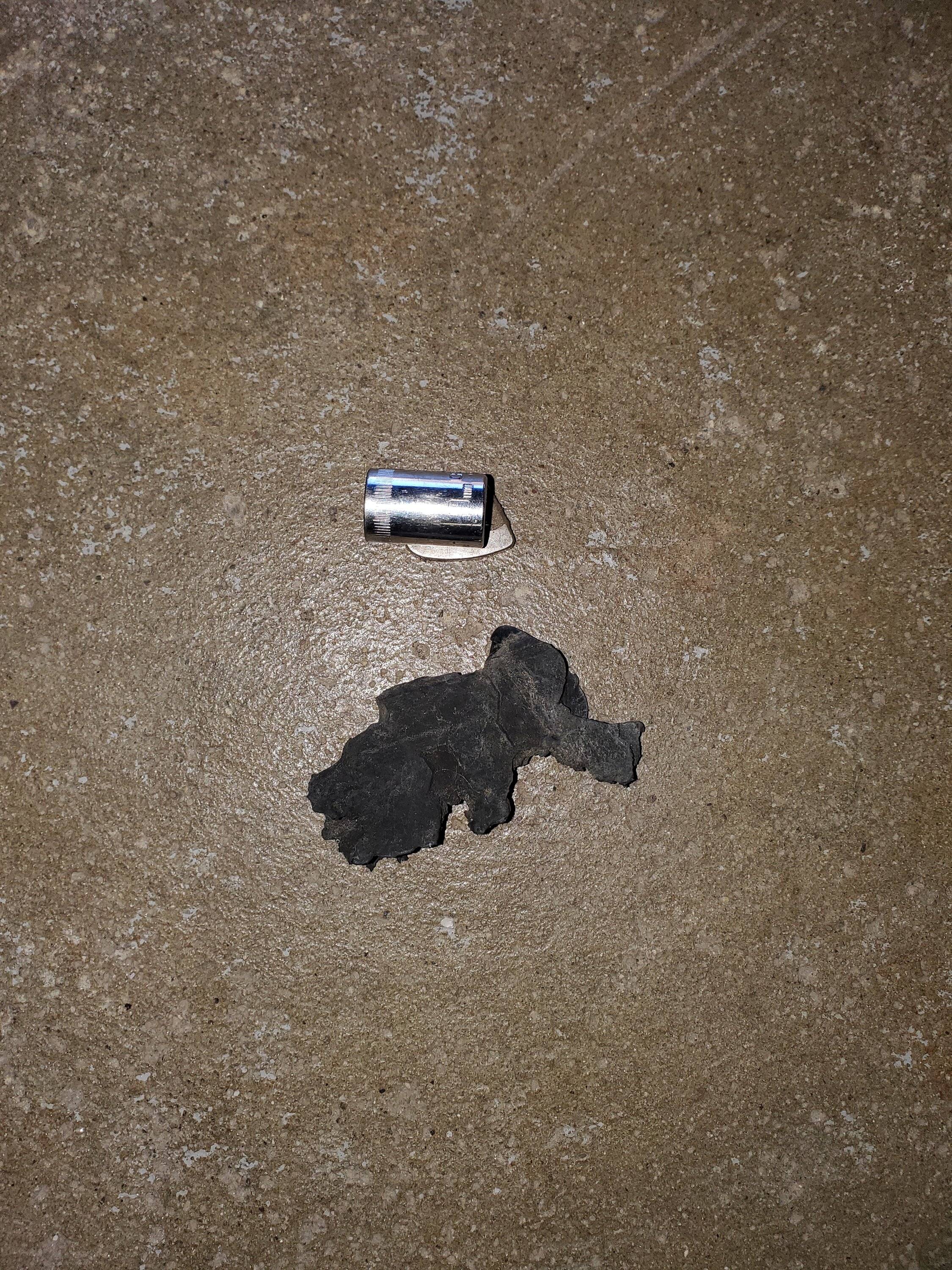

Then checked under the engine cover for any damage from rodents, didn't find any but the 10mm socket tried to runaway. It rolled into the slots in the radiator cover, landed on the plastic inside and then rolled again out of sight. Spent the next hour taking off the belly pan and searching around with a magnet and all I found was a chunk of old tire that got into the shroud somehow. Banged on the bottom of the fan shroud, heard the socket bouncing around and managed to bounce it forward towards the bumper. Stuck my magnet in there and it promptly got lost.
Stuck my hand up in there, found the socket and magnet.

Looks good. Which size mesh did you use and how did you attach it ?
1/4 mesh and JB Weld steel stick. I borrowed the idea.
I think I'll be borrowing your idea for the airbox opening. No problems there yet and would like to keep it that way.

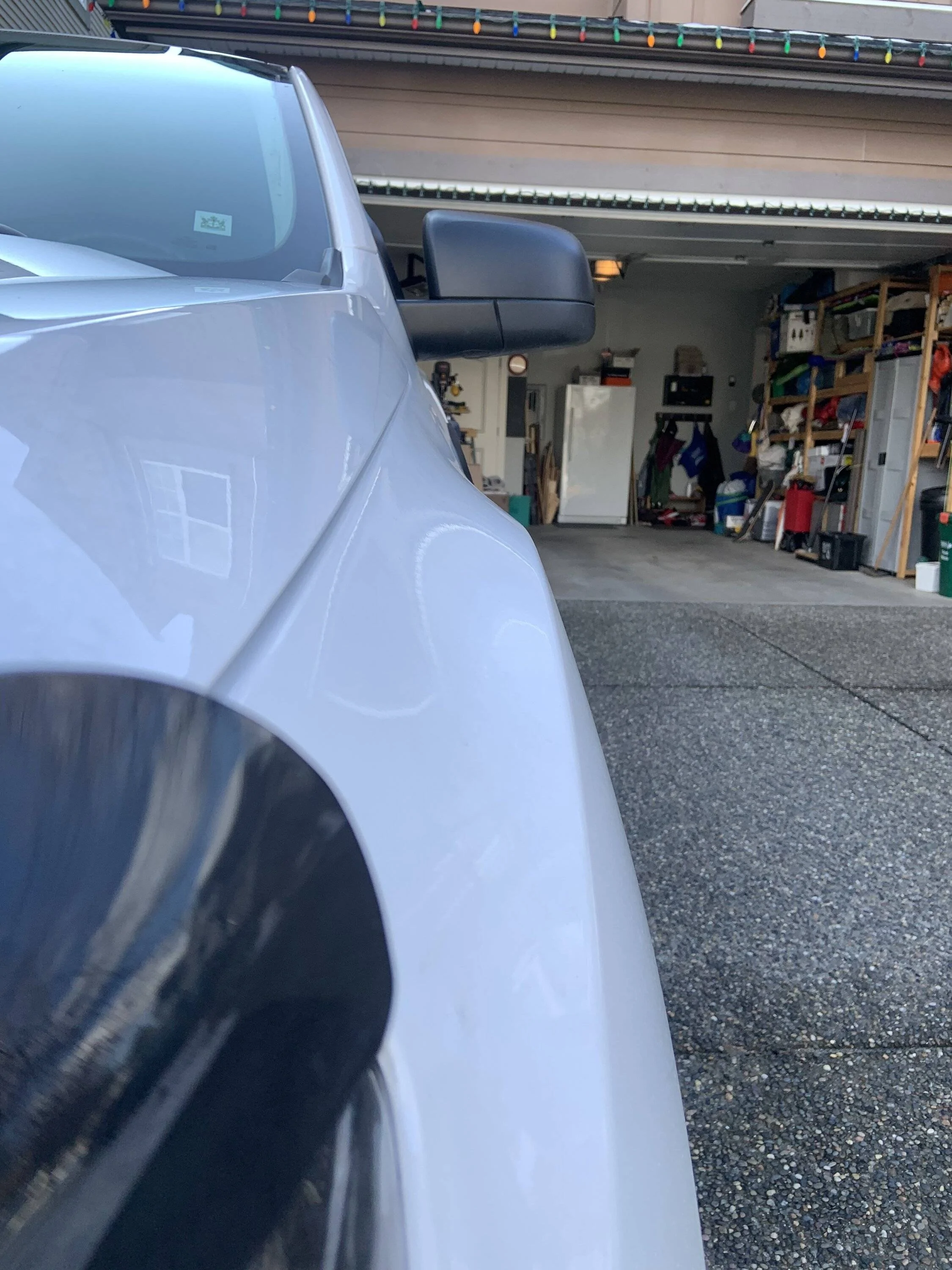

Got my Putco grill and installed it yesterday and finally moved the fenders out a bit. It made a small difference - could have used a bit more space to move a little more but it looks okay. It was never in so much that is was visibly but was uneven compared to the passenger side. At least it moved a bit so I feel like I accomplished something!
