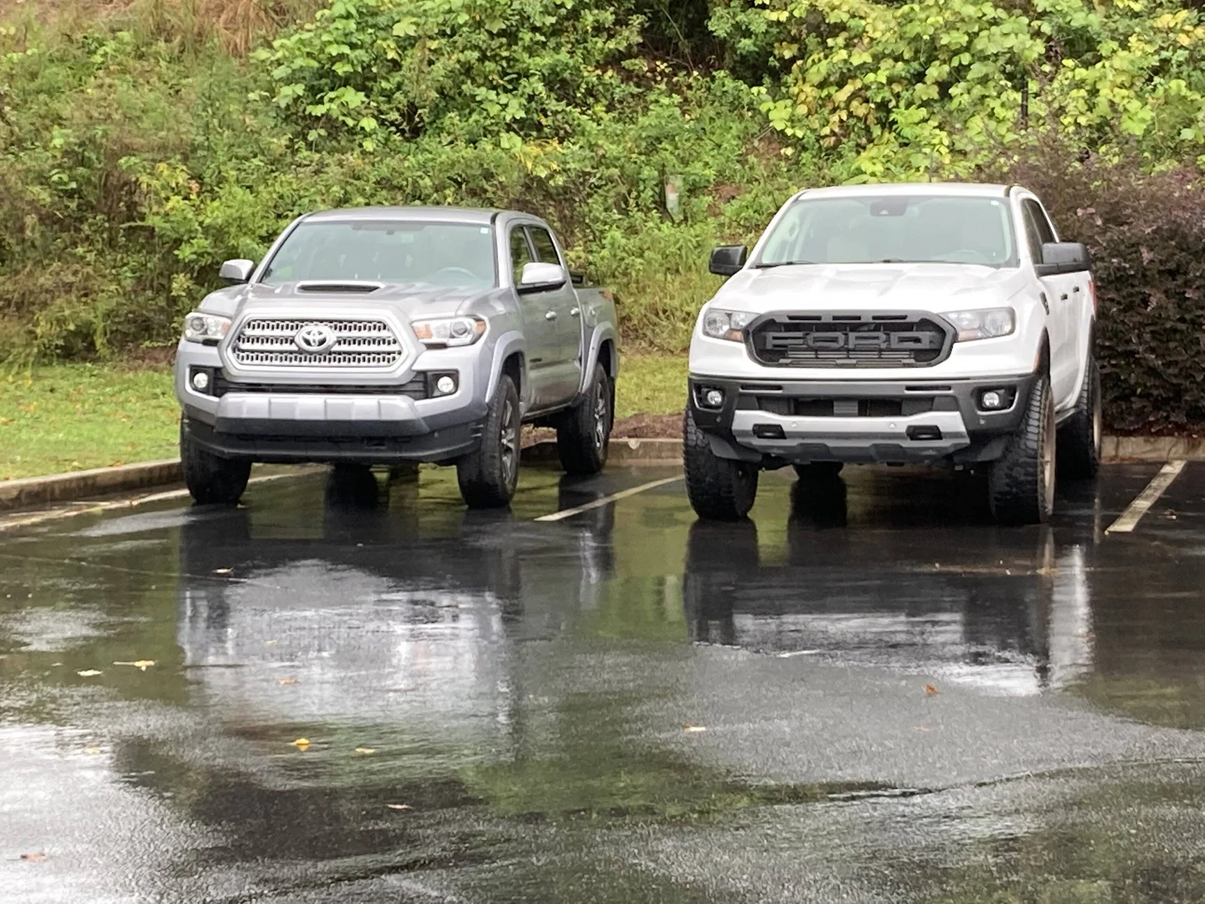

I have the Fuel Shok in bronze on my White Ranger with a +20 offset.
Here is a pic of the wheel and a pic of the "Poke" with 265/70/17 tires.
The +20 offset lines up great with the edge of the fender.
Thank you for the information and the pictures from the front and side of your truck really gives me a good idea of what the wheels will look like on my truck. If the cards will fall into place, I'm go with the Fuel Shok in bronze like yours with a 1 inch taller tire than the stock size that are on it at the current time. Thank you!😁👍

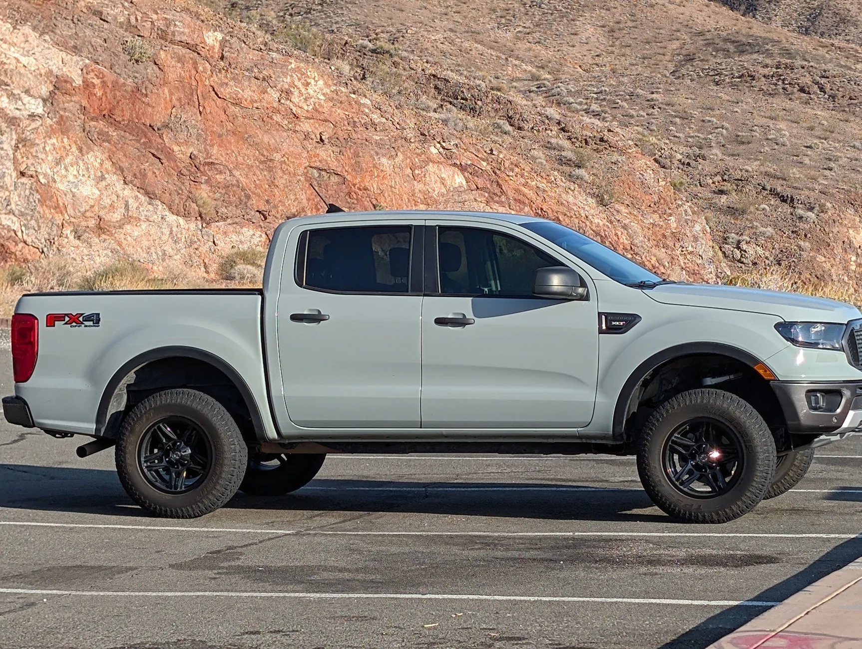

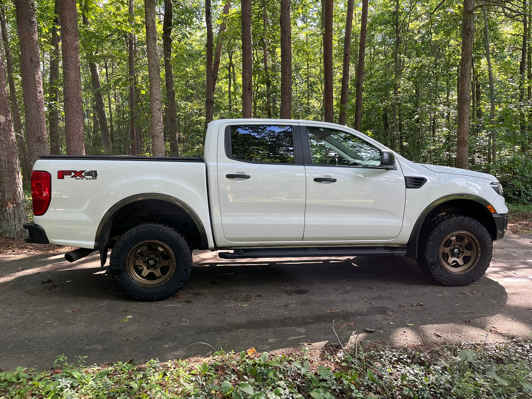

Both Sid and Dennis have great setups and you can see how Sid’s 1” spacers work perfectly to get his tires out closer to the edge of his Air Design fender flares.
+20mm offset or slightly higher is a good target to shoot for. I went with +15mm and when my fender flares are off, there’s enough poke that my paint suffers.

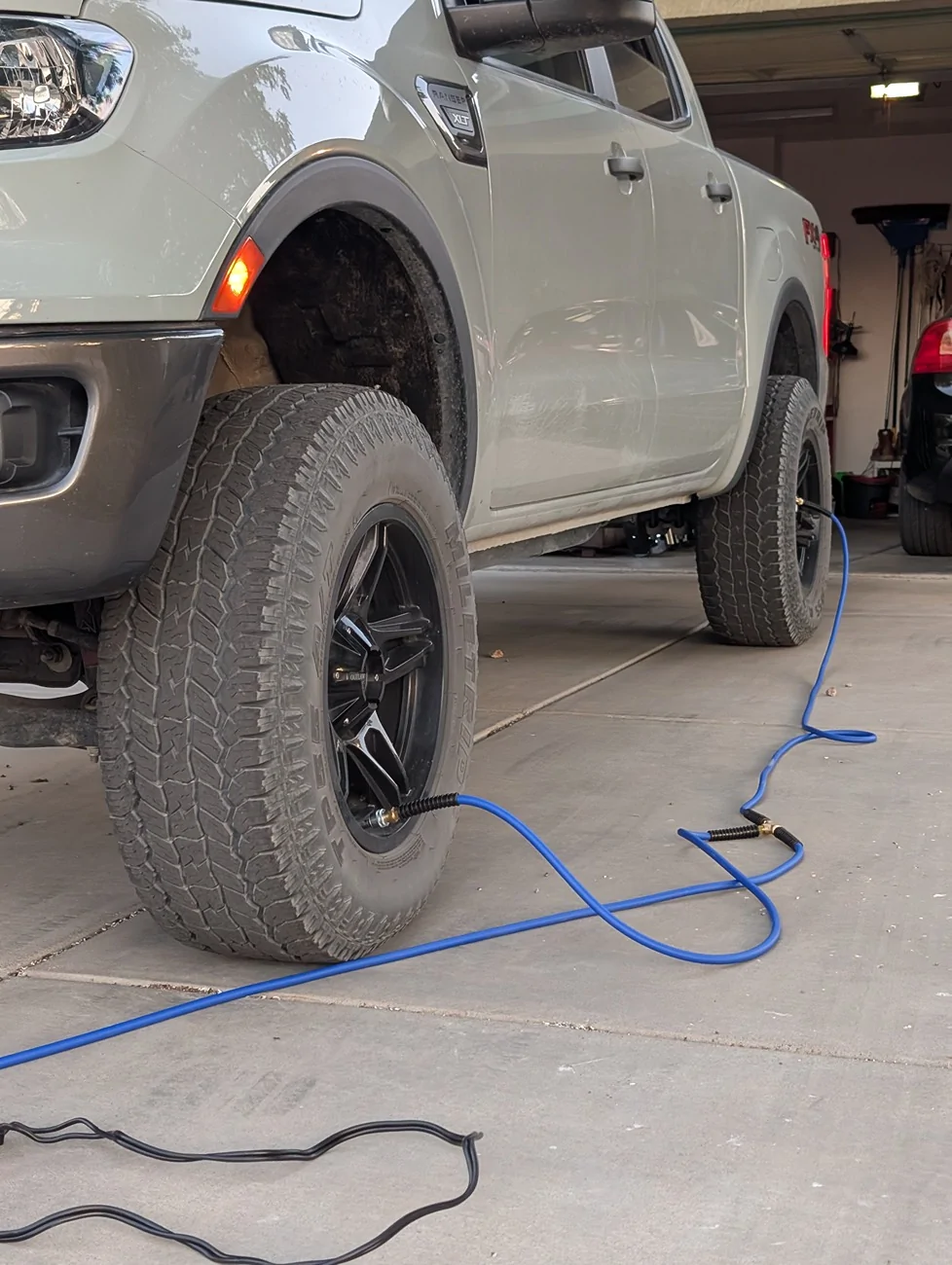

For reference, here's a 17x8.5 +10mm wrapped in 265/70r17
American Outlaw LoneStars - Look half decent, but they're heavy as shit for a 17" wheel.
Checkout Custom Offsets if you're exploring wheel/tire combinations.
Their gallery has a variety of customer-uploaded pictures with different wheel and tire setups, and you can filter the shop by size, color, offset, etc.
I bought a set of wheels and tires for my Q50 from their sister website/company Fitment Industries a couple years back and had a great experience with them. They also have sales reps who will reach out with any fitment concerns.
