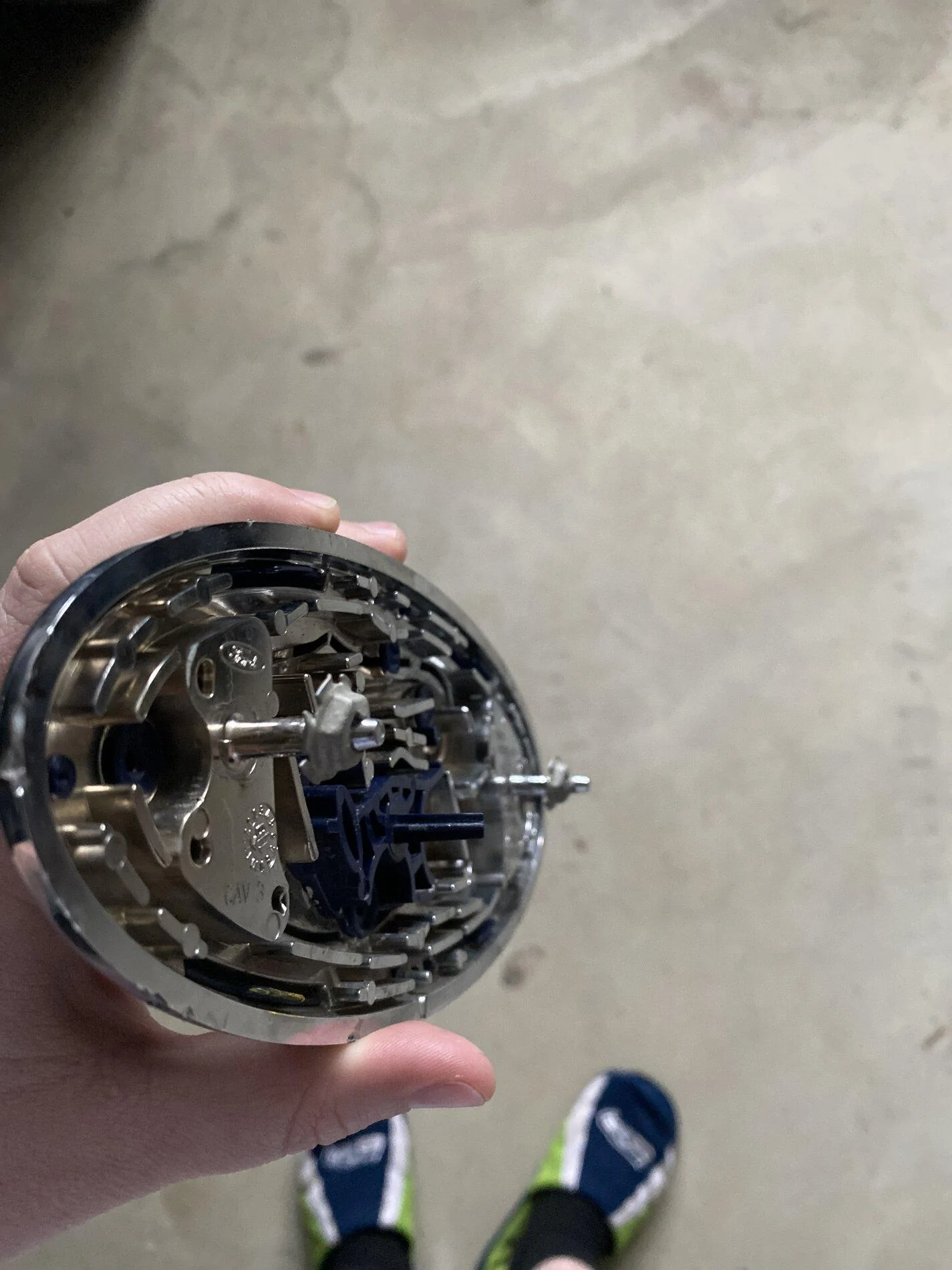

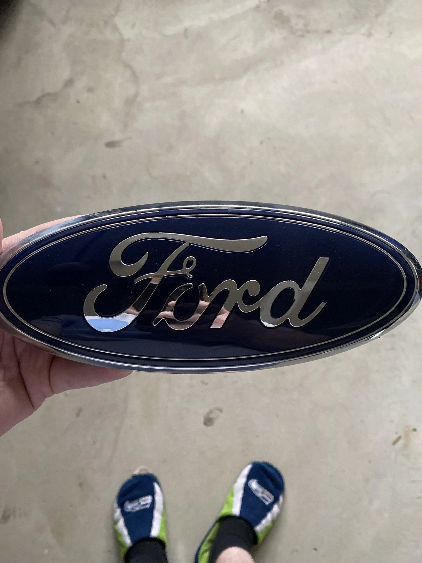

I swapped mine out for a Black Ford one. I just used some of those body panel tools to pry it off. There are some one time use nuts you’ll need if the emblem you get isn’t an adhesive only. Mine was an adhesive and the little anchors.

Just the center. The outer oval ring is part of the grill. I’ll take some photos

Also the rear is the same deal but without the nuts. It just kinda snaps into the holder. Front was more of a pain. Felt like I was going to break the stock one

So I was able to get it loose then used the pry tool to pop the nuts off so I’m not sure either then I guess lol

The nuts came off the back. They didn’t come through the holes with the studs. They dropped behind the grill after I popped them off. I just put the nuts on there after I took it off

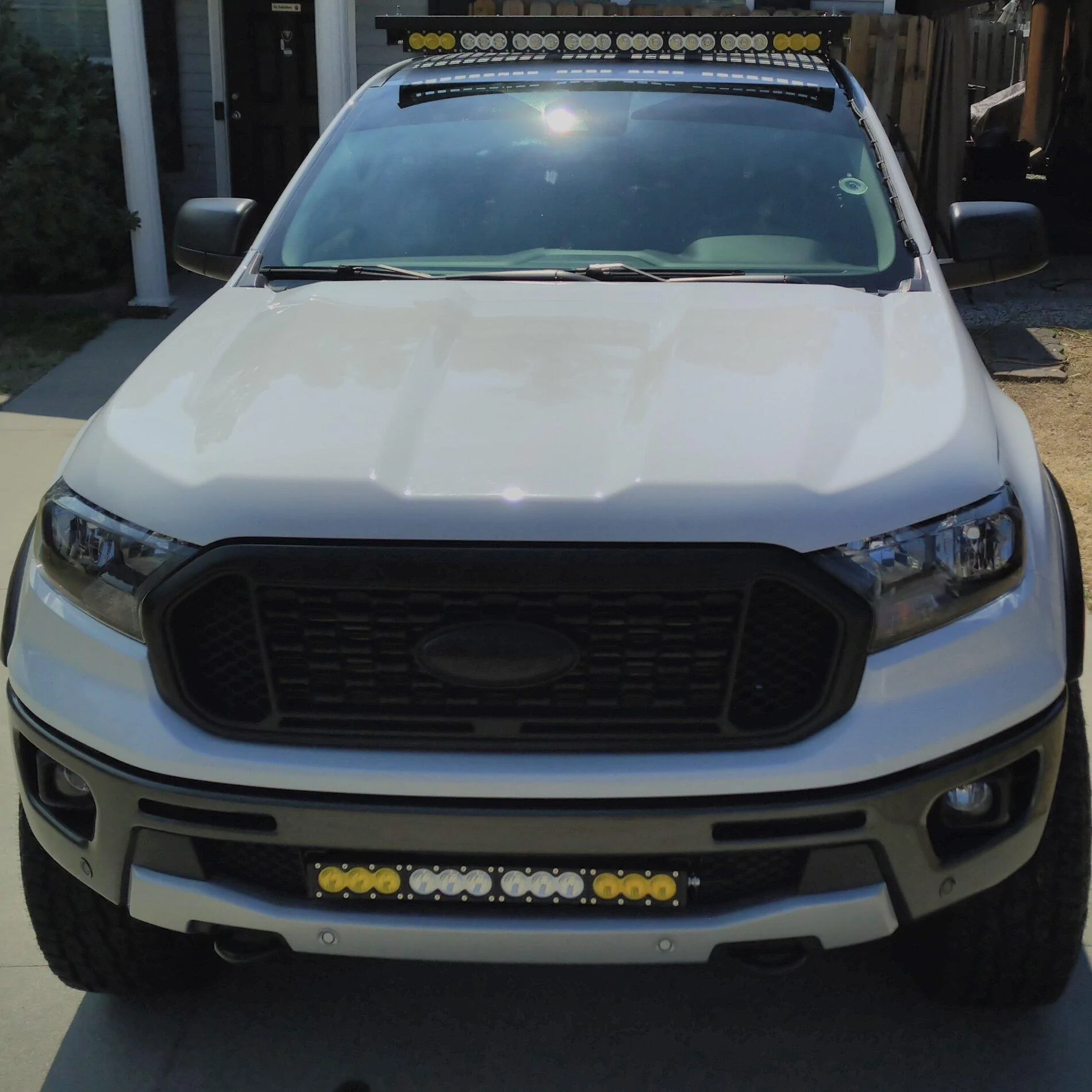

Painted mine satin black.
