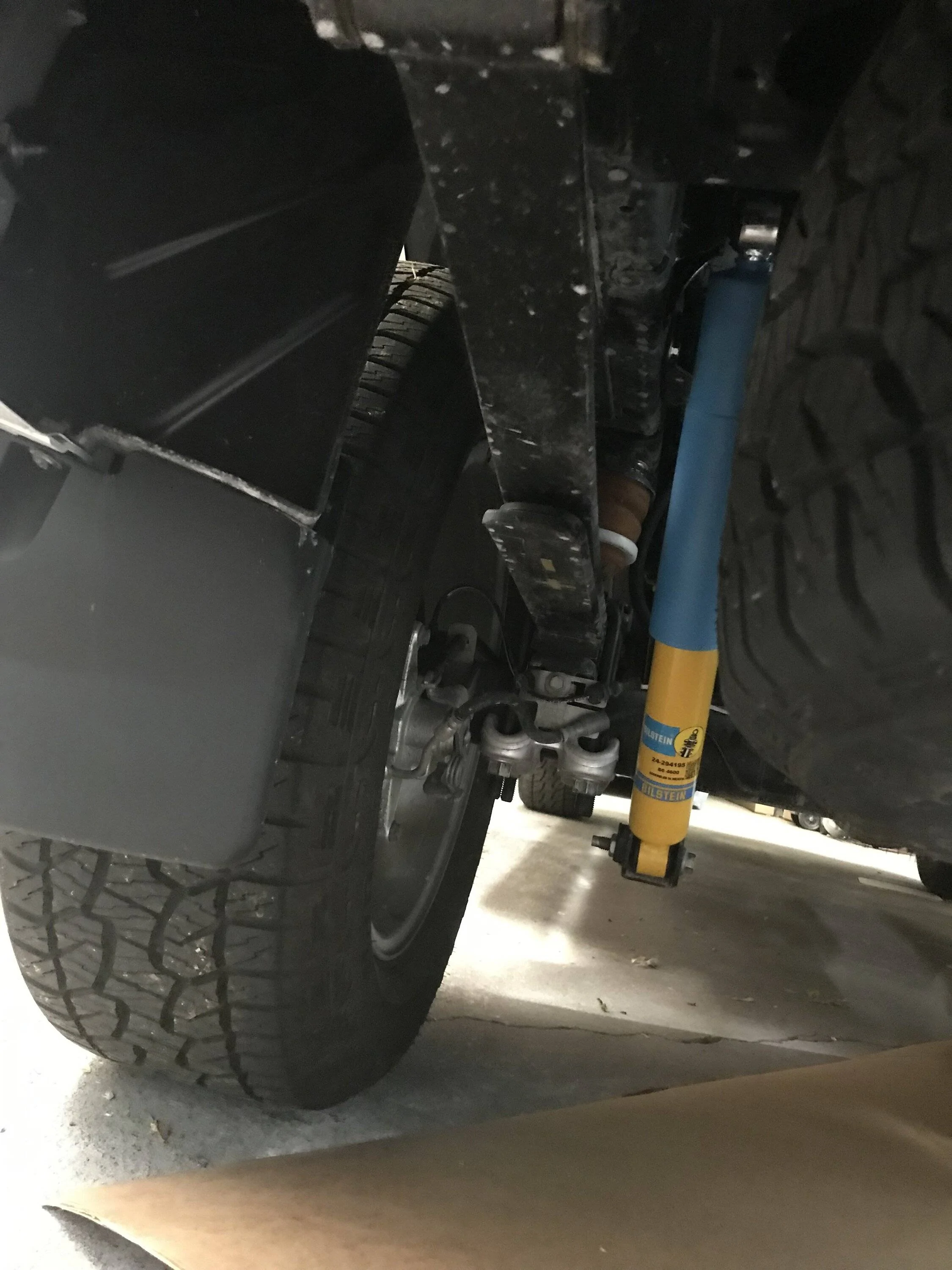

I actually installed the 4600’s (Rears)as well yesterday. Have not taken for drive yet.
The 4600’s were a bit hard to find, out of stock. Did find them at Summit Racing though. I did a off truck compression check and the 4600’s did have a slight stiffer compression. My truck just hit 6,000 miles - so rears are basically still new.
