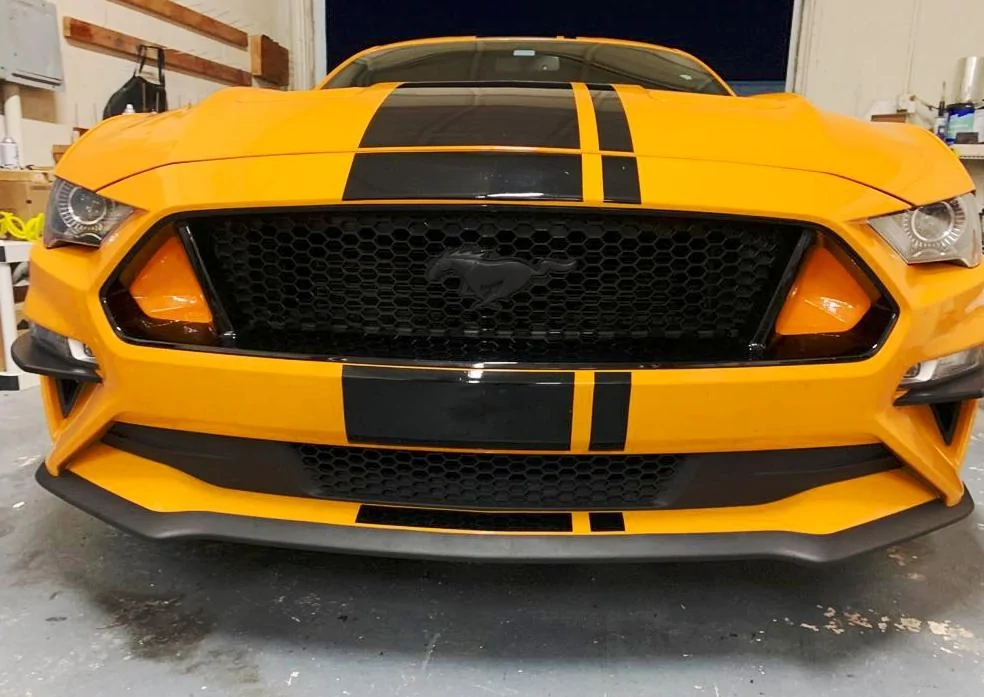

Dan called me yesterday, he said someone who had purchased one for their 2020 Ranger was having difficulty installing it and he was wondering if there had been a change in the trucks? I can't imagine that. He's not on the forum but I sent him the links. He was telling me about their new Mustang intakes, sent a pic:

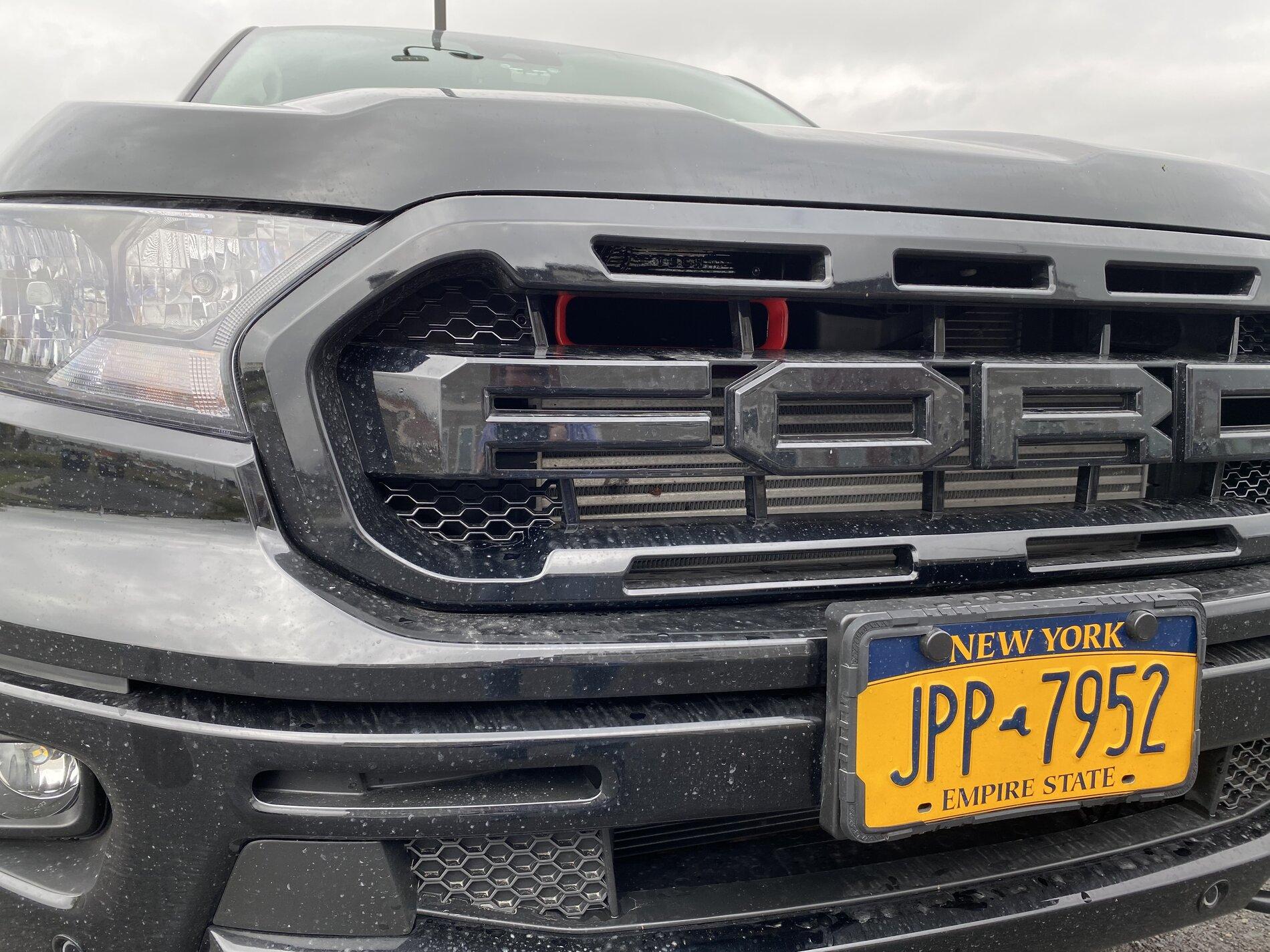

Just received mine yesterday, Raptor grill, it took about 20 minutes to install. The left hand screw is easy to reach and remove to begin the install but a little tricky installing. A long T handled Allen wrench did the trick.

Which Raptor grill? I know there are a few manufacturers and they are subtlety different.
Velossa Tech was looking for customer pictures.

I bought mine through the truck accessories guy formally Toyota guy
