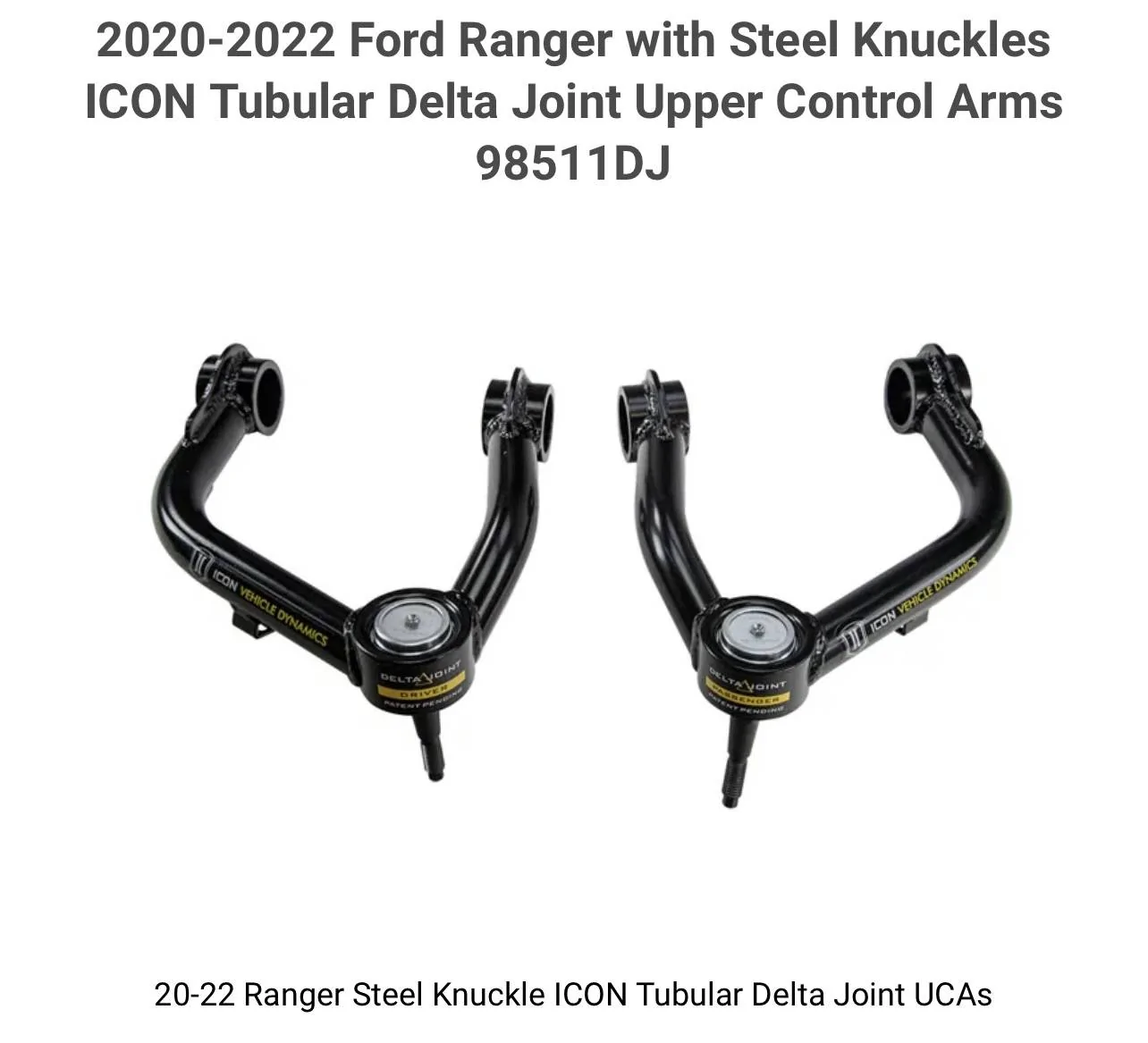

What do you guys think?……………. Will there be a “”little”” or “medium” or “a lot” of road noise with these? Thanks for your opinions.
Looks alot like my APG UCA's minus being shipped already fully assembled....
With the solid milled bushings there is a trade off... more road "noise" is transmitted into the chassis, but with the Heim joints and solid bushings steering feels much more responsive and nimble. IMO ...a good choice..
Edit; with the adjustable Heim joint ends ,after getting your alignment camber and caster sorted out and set, you can drill and pin the cam bolts on the lower control arm in place ( racers trick). Will hold it's settings under heavy abuse, and any future fine tuning can be done with just the UCA end joints...

To the OP,
I had Eibachs pro trucks 2.0 for several months before I decided to join a group buy here on the forum. I have a 2 1/2 lift from the Eibachs so many here would say they were not necessary. After installation I noticed immediately that it rode smoother and the front suspension worked much better, perhaps because I could utilize the extra inch of travel from the extended range of the Eibachs. Huge difference on rough terrain. I am running 32" 265 tires with no issues for 8k miles with this setup.
As stated I initially had no intention of upgrading my UCA but glad I did get the Icon UCAs, particularly thanks to Frank at Stage 3 and the group buy.
