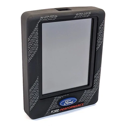

I installed the FP tune last night. Updating the ProCal4 device, backing up the stock tune and down loading the FP tune to the device went smoothly. I had a little bit of an issue transferring the new tune to the truck though. It went through the erase/write for all 95 blocks but at the end I got a FAILED. The ProCal4 gave me a message; Do You Want to Recover the ECU? I selected yes and it went through the whole process again resulting in another fail. I decided to shut off the ignition and unplug the ProCal. After waiting a couple of minutes I tried again and it completed the flash successfully.

So for anyone who wants to update the tire size when you goto the tire/gear ratio screen with the Key On Engine Off press on the numeric value and a keyboard pops up to let you change it then you have to follow the screen prompts key off ... wait... key on etc. then it updates the value.

I'm new to the board but not new to Ford Rangers. Bought the Ford Performance Tune/Calibrator/Filter and installed during the summer of 2020. Numerous timeouts when attempting to download tune from Calibrator to Lariat. Dealer and Ford Performance were at a loss. Took the entire mess to a Ford Builder/Tuner in a nearby town - he was successful after 5 attempts.
Read somewhat later there was a firmware issue with the Calibrator and a firmware update was issued at a later point.
