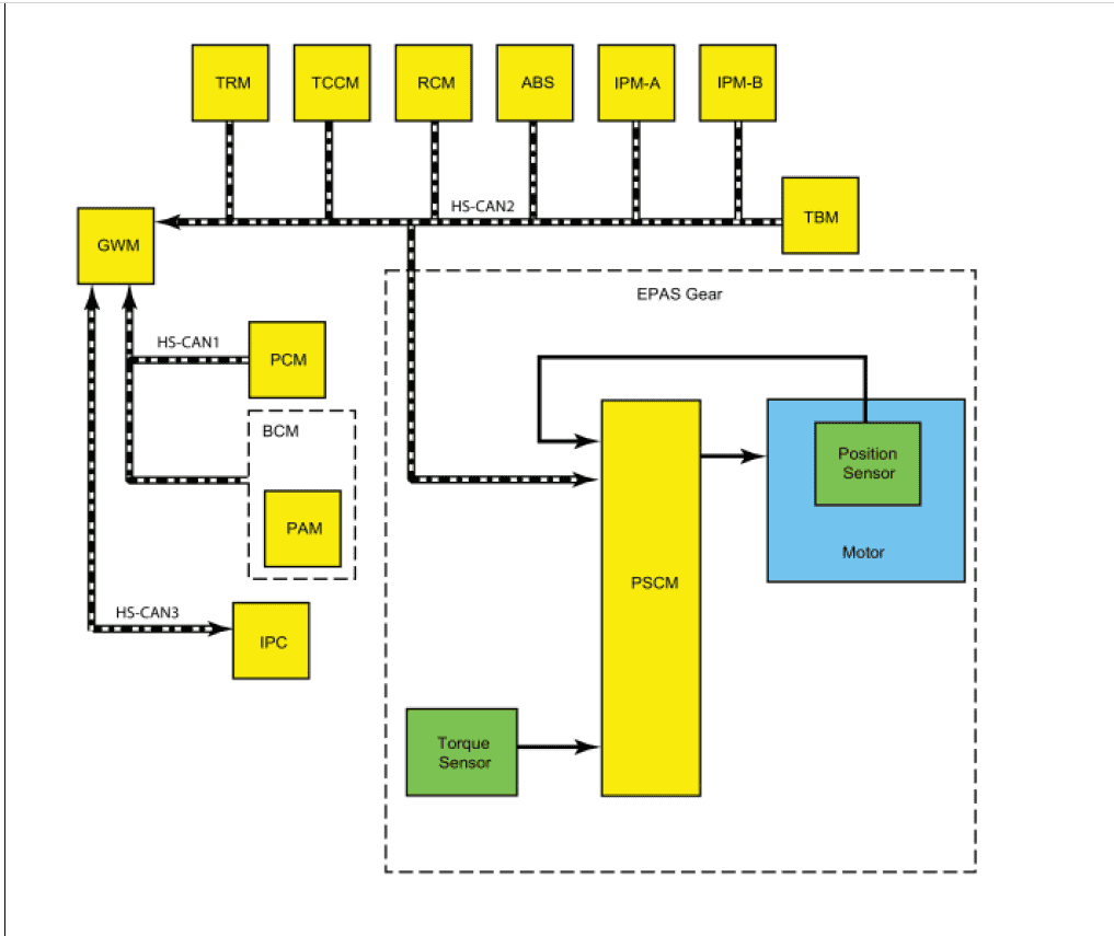

I said the steering shaft u-joints because I had similar problems a few trucks in the past. A dakota I had had an issue where after a full rotation the steering would bind. Turned out to be a bad u joint. My previous F150 also had an issue where steering would feel ever so slightly different in one direction. I got my ranger before investigating the problem on it.
It would be worth checking the wiring and see if there's any uneven power draw during operation.
If you use forscan you can find an option about steering ratio but I ultimately believe that's an option not used on any rangers. It may pertain to auto parking functions of other vehicles.
