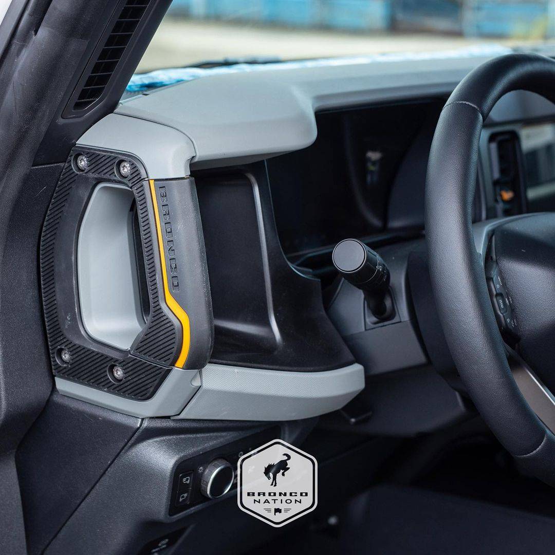

Like this? :shock: Maybe the R6G will have the same design as the new Bronco?
