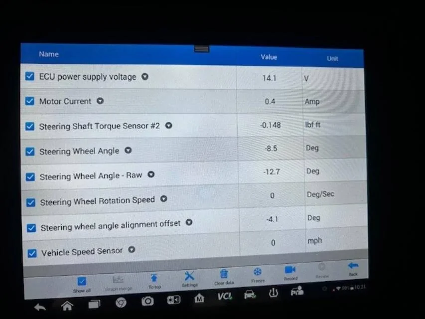

While I had my Scanner Out today
I pulled these PID's from the PSCM - Power Steering Control Module - Live Data
These PID's would most likely show a (Red Flag) and possible failure issue.
Between Turning Left or Right
Mainly Motor Current and the Steering Shaft Torque Sensor and then ECU Power Supply Voltage
Just look for any abnormal differences between Left / Right hand turns
