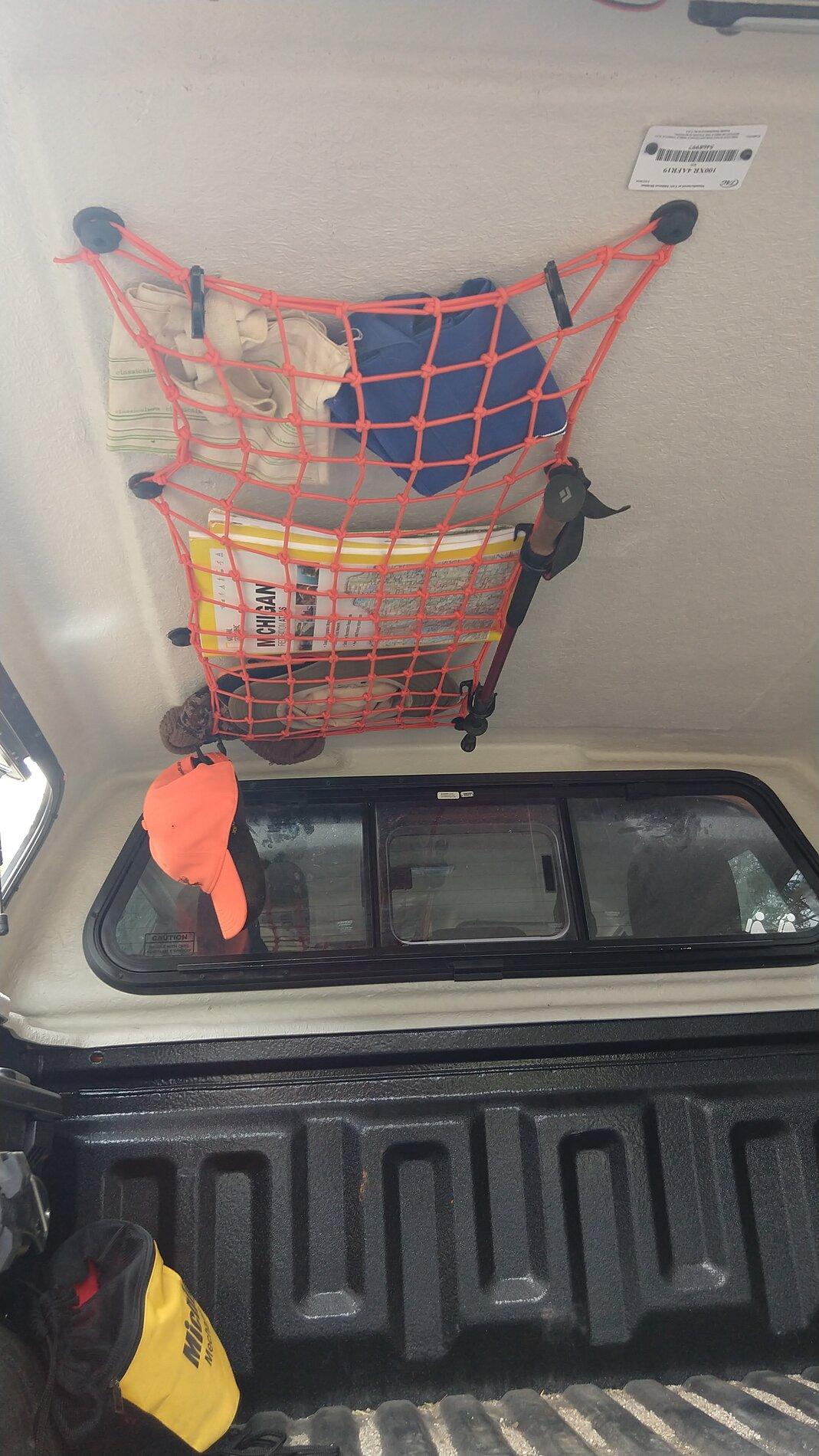

Yup! This is exactly what I was after. I didn't want to drill into my cap so the JB Weld is a nice alternative. I hadn't thought about that. Very helpful. Thank you!You mean like this?
I added mine myself. Pretty easy. Just JB Welded some studs to the ceiling, let them cure out, I already had the net, and boom done.
I only did mine half wide since I have a windoor on the driver's side, so I can easily open that, reach up and in, and easily grab anything I have stored up there.
The JB Weld is rated at like 3000 psi tension, so you could hang a lot up there. But, as you can see, I usually just store tote bags, hats, maps, and other miscellaneous loose items. It really is one of the most useful additions I've made.

I used this plastic weld type. Since you're bonding plastic to fiberglass, that's essentially what this one is exactly for. And they're darn solid. And it looks like it actually has 3900psi tensile strength, so better than I had remembered. Just got to make sure and prep each bonding surface really well so it can bite correctly.One other question. Do you remember which JB Weld application you used?

Awesome. I’m looking to do a full attic net, so I get your point about wanting to go the route you went. It’s a great setup for what you are using it for. Thanks for all the info and links. Much appreciated.I used this plastic weld type. Since you're bonding plastic to fiberglass, that's essentially what this one is exactly for. And they're darn solid. And it looks like it actually has 3900psi tensile strength, so better than I had remembered. Just got to make sure and prep each bonding surface really well so it can bite correctly.
Also, I used these as the bonded on anchors. Kind of made for that purpose and kind of not. I just removed the adhesive that came on the back of them (since it'd in no way be strong enough), and didn't use the screws. Though I had thought about using the screws if they were shorter and would just puncture into the core of the ceiling. But they were long enough that they'd go all the way through, so I just left them off and it's still more than strong enough.
