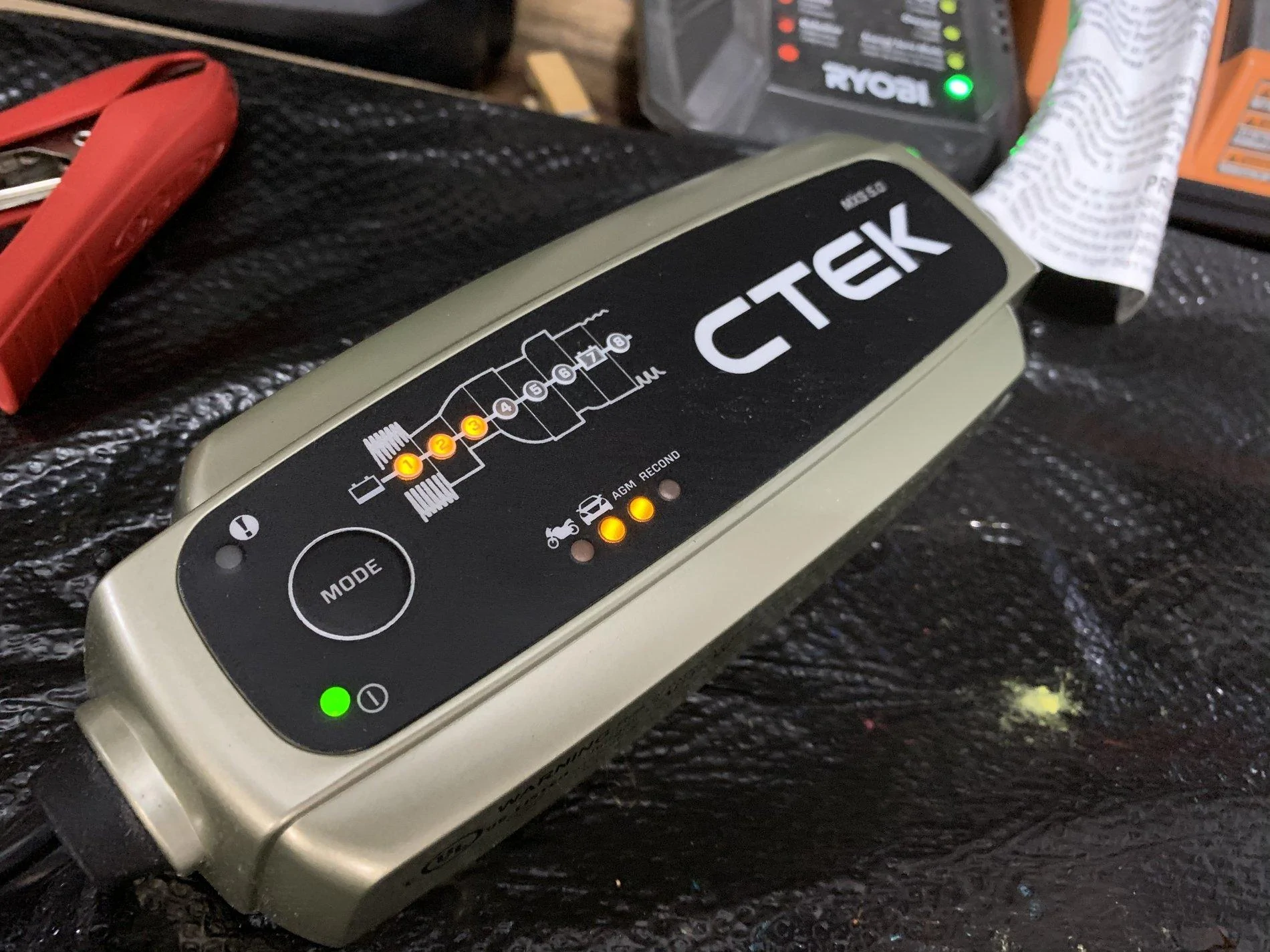

Got my CTCK 40-206 MXS charger yesterday, and installed the cables to the battery. I just need see if the company offers an extension cord less than 8'. Then I can try to figure how to mount the Port to plug it into the front of the truck with out having to open the hood up to plug in the cable to charge.

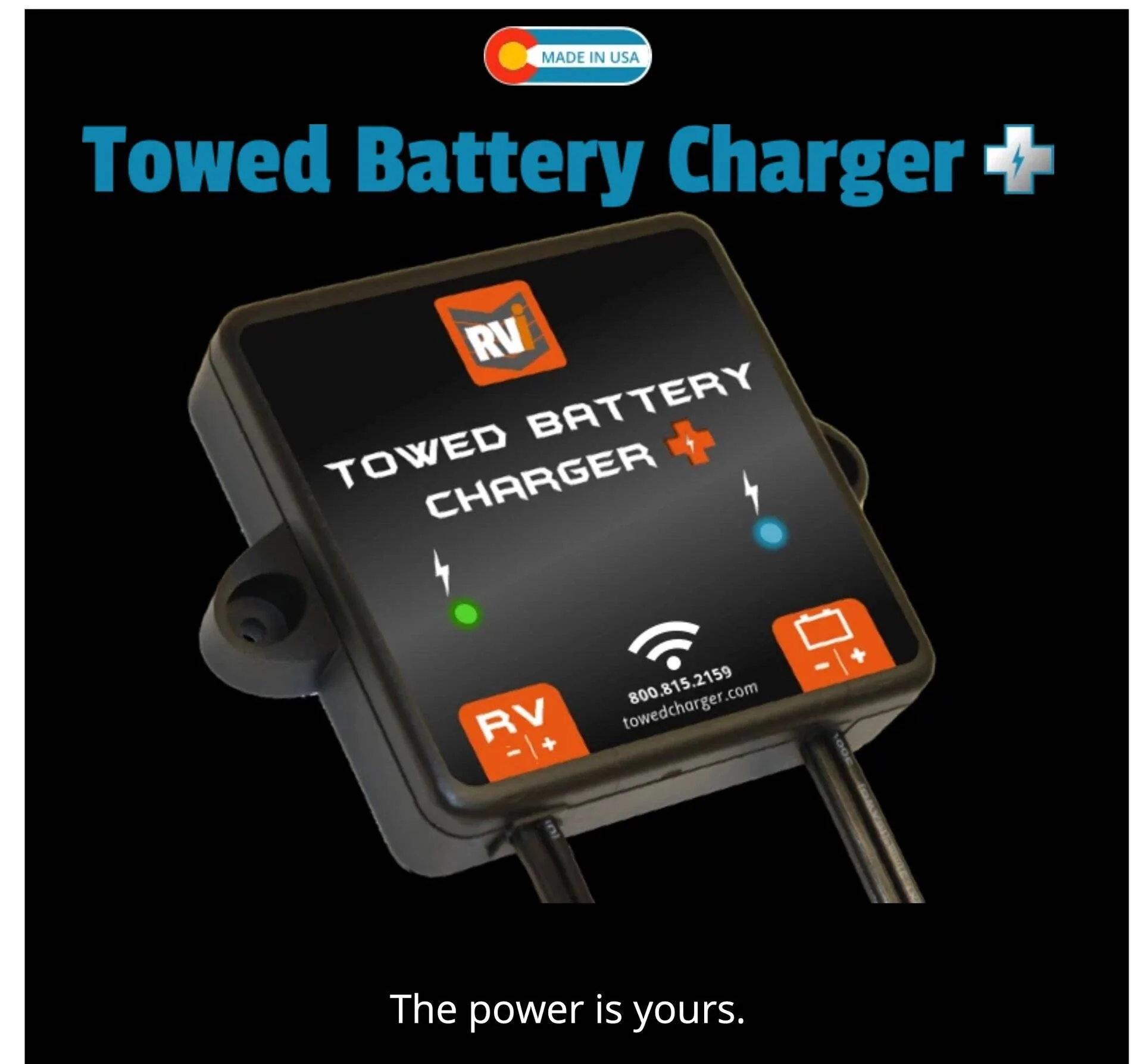

At home my truck get used every day or so, no problem keeping the battery up. On the road being towed is another matter, what with the truck being in tow mode and the supplemental braking system using power. So I installed a 12vdc>13.8vdc charger powered by pin4 (12+v) on the RV tow cable, and it keeps the tow car's battery charged, will trickle or smart charge up to 10 amps.
https://rvibrake.com/products/towed-battery-charger-plus
