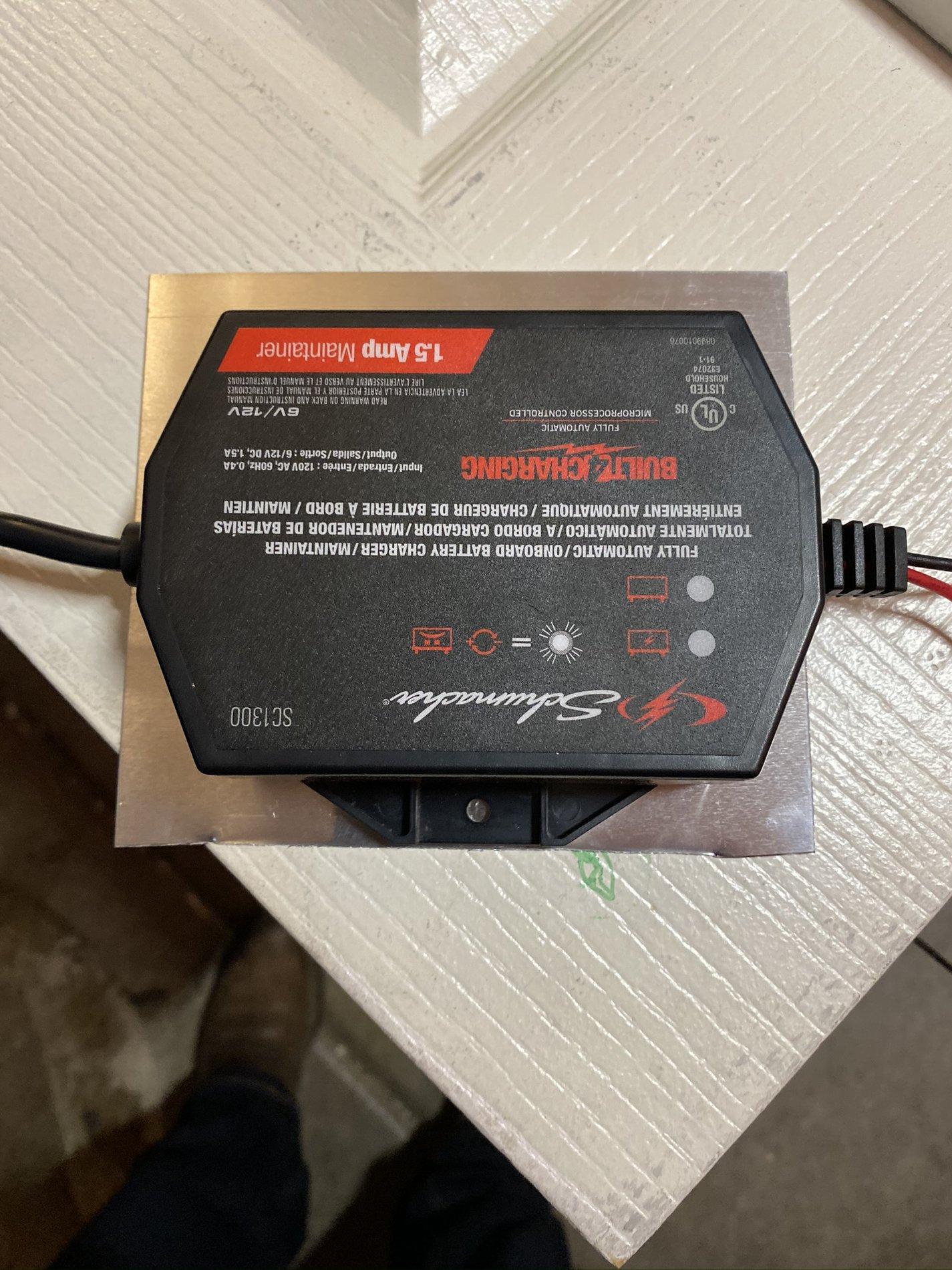

I use a 0.75 amp Battery Tender around the shop. I charge batteries all the time with it. Yes it's slow...obviously...but for a maintainer low and slow is what you want anyway.
If you want to actually charge a battery, get a charger. For the maintainer situation, I see no problem with 1.5A or lower.
Now if you have something drawing more than your charger puts out, that is cause for reevaluation. More like figuring out what's causing the draw, not upping the charger.

It seems to work fine. I don’t expect it to charge a dead battery. It does charge from whatever Ford sets the battery at to a full charge. The auto start stop works fine when i plug it in. If I dont, it tells me it didnt shut down due to vehicle charging. Battery and alternator check out ok per Ford so I assume they have stupid logic on the on board charging system.

Mostly because I don't drive a lot and when I do most of my commutes are short 15 minute ones. It doesn't give the battery enough time to really get a good charge.

I’m a snowbird in the winter and the Ranger stays home. I’m wondering if one of these trickle chargers is a better way to go than disconnecting the negative battery cable as the owners manual recommends. Simply disconnecting the battery seems less risky than leaving the trickle charger plugged in all winter?

Hi Al,
I have uset a trickle charger, Battery Tender 2, for about 15 years when we left each summer for a 3 month trip in our RV. Never had a problem leaving this tender connected for extended time. That said, I have never had a vehicle with an AGM battery until now with my 2019 Ranger. I have had AGM 6 volt deep cycle batteries for about 5 years now in the RV for our inverter usage. They have served us well, but they take a special charging strategy setting on our inverter/Charger.

Hey Phil,
The Battery Tenders are fine with AGM batteries according to their website:
https://www.batterytender.com/Battery-TenderR-Plus
  • Perfect for all lead-acid, flooded or sealed maintenance free batteries (AGM and gel cell).
