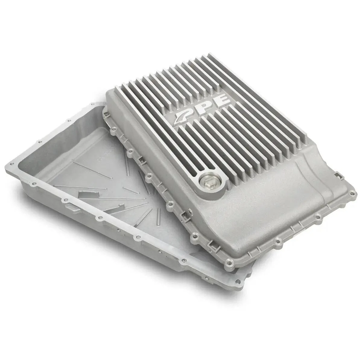

So, in typical overkill fashion when it comes to Soupie. I've ordered the FitzStick, will possibly get the shallow PPE pan for my birthday, and will probably do a full fluid AND filter change this summer.
However, I'm conflicted on that.
Since I have the 8 or 10 year ESP, part of me wants it to fail in that time. But with my luck it will probably fail right after the ESP runs out. =/
The Cherry Bomb trannies look pretty good too. But, as someone wrote, doing the fluid change is relatively cheap preventative maintenance.
