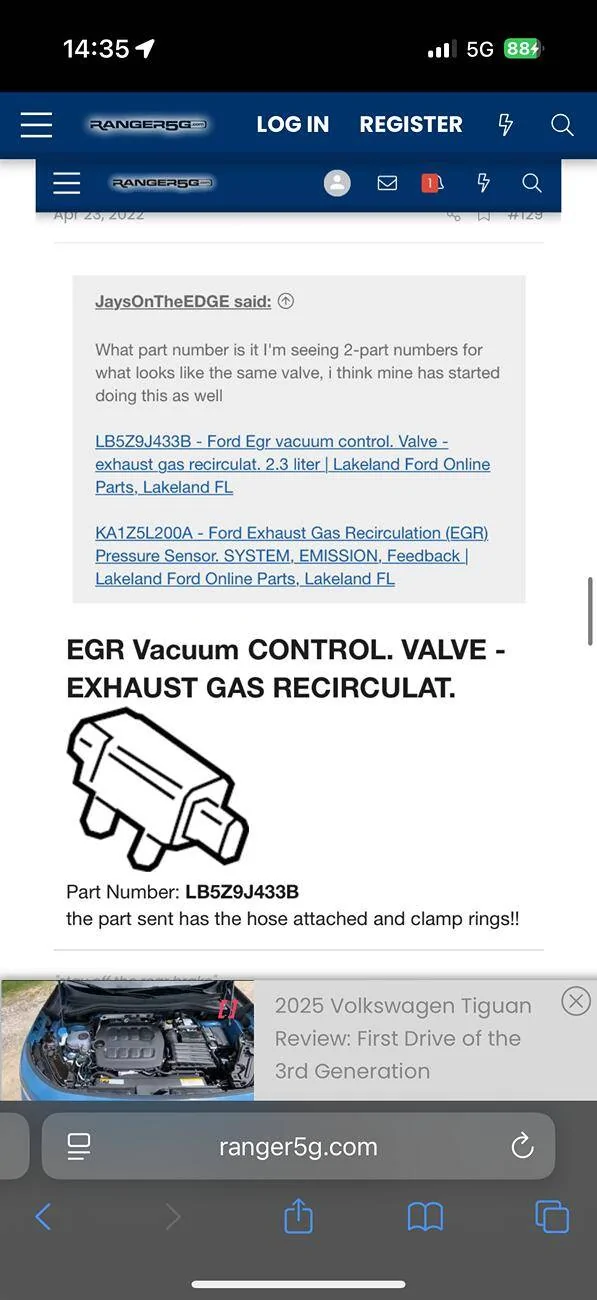

I found a couple of threads stating that other 5g ranger owners had the same issue my ranger had when cruising between 25-30mph. My truck would experience a stutter feel, like the transmission was having trouble choosing which gear to operate at that certain speed range. My truck began having the issue at around 50k miles and progressively worsened up until transmission warranty expired at 60k miles. That’s when I decided to do my research and found that a likely fix was the EGR valve assembly. I went ahead and purchased the part from my local ford dealer for $130. Replacement took me about 10 mins to do and I can happily say the issue has been resolved!!! Truck is good as new ?
part # LB5Z9J433B

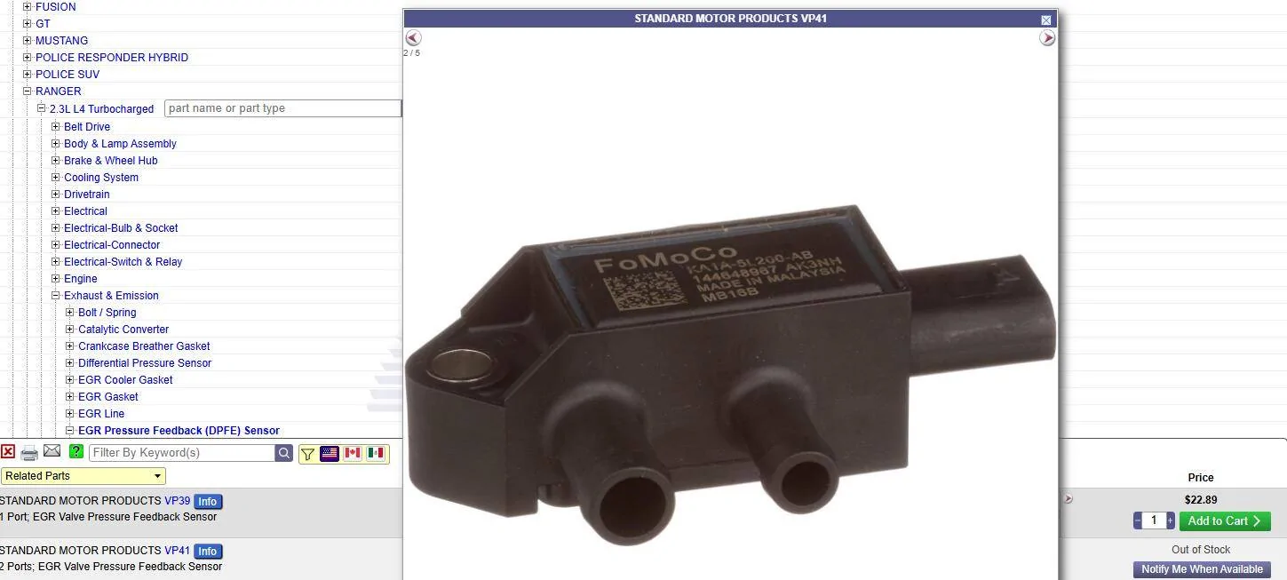

Yikes, $130 is steep. Most of us have used the Standard Motor Products one (VP41). I used to keep a couple on hand and replaced them about every 20-30k.
(They come with the gold paint scrubbed off now)

I bought the VP41 from RockAuto for $16 several years go, with a 3 yr 36 month warranty. They've since gone up to ~$20. I consider them wear items.
They have been reliable.
