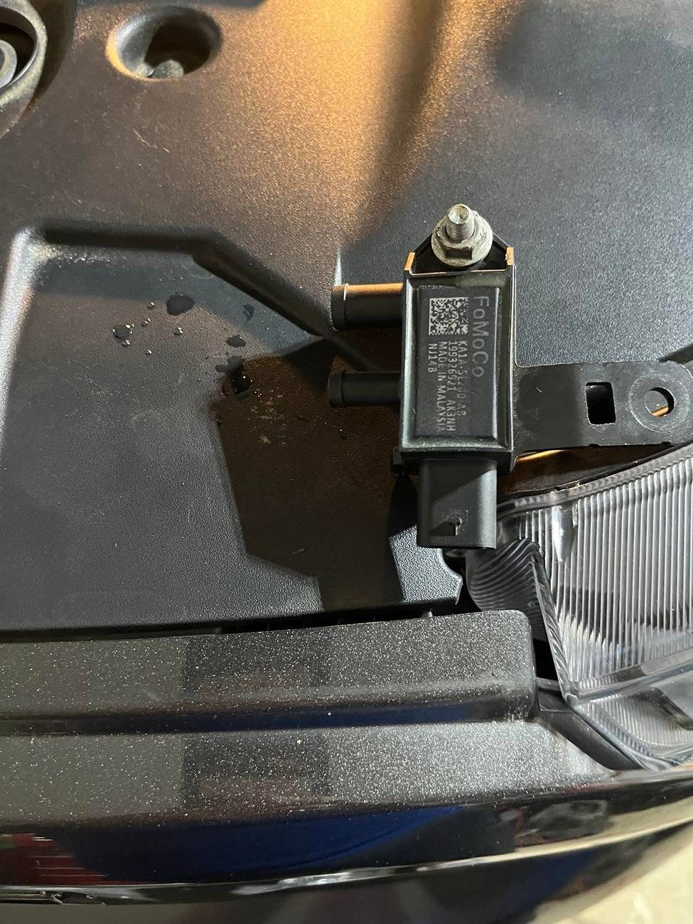

What about the shutter in the lower gears? Anyone else feel that?
There is a thread about that issue, not transmission related but a symptom of a bad EGR DPFE sensor. In my case (having lost faith and trust in dealers) I changed the DPFE valve myself. The price in April 23 was under $20, it is now close to $80. I took the one I put 17 months ago off because I was getting the symptoms again and it and the hoses had moisture in it. I used a blow drier to clear the hoses and shook and used Q-tips to dry as much of the sensor as I could. The performance is better, but not what it was. I will take it to the local dealer when it gets to be a pain again. According to a post on that thread, there is no communication between the two tubes that hook into the sensor; the two chambers of the sensor are separated by a membrane that reacts to pressure changes. It is true that the performance improves if you drive in Sport or (if you have it) tow mode. There are no codes triggered by the sensor failure; I believe it's a design flaw.
https://www.rockauto.com/en/moreinfo.php?pk=13959421&cc=3447362&pt=5088&jsn=516
