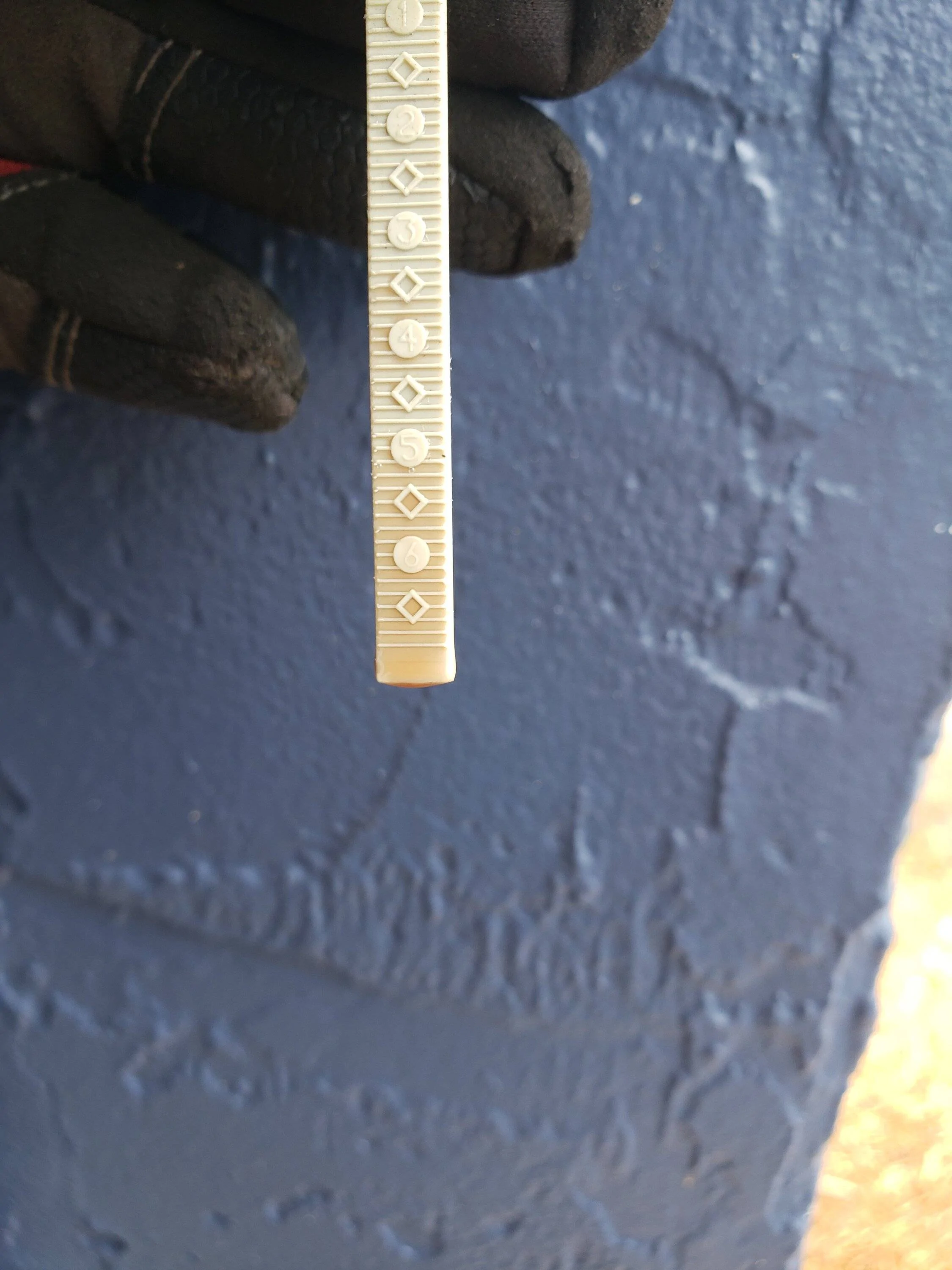

I stuffed some towels in my glove so I could bear to touch the downpipe... here's the reading warm.
It looks to be at or below 5. I checked it 3 times. Engine still running after driving around for about an hour.

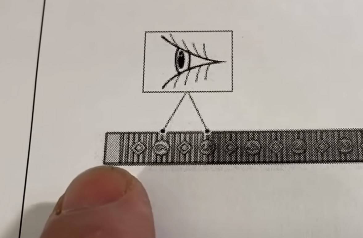

This is messed up...according the video referenced 40:50 mark... he clearly states that the reading HOT should be at between 5 and 6...so he says to target cold test to be between 6-7...so when expanded hot it would be correct at target 5-6...
BTW...between two numbers is a huge spread...that's a difference of 1-2 quarts variable...
There were a different set of instructions just for the Ranger. It was 4-5 hot fluid level.

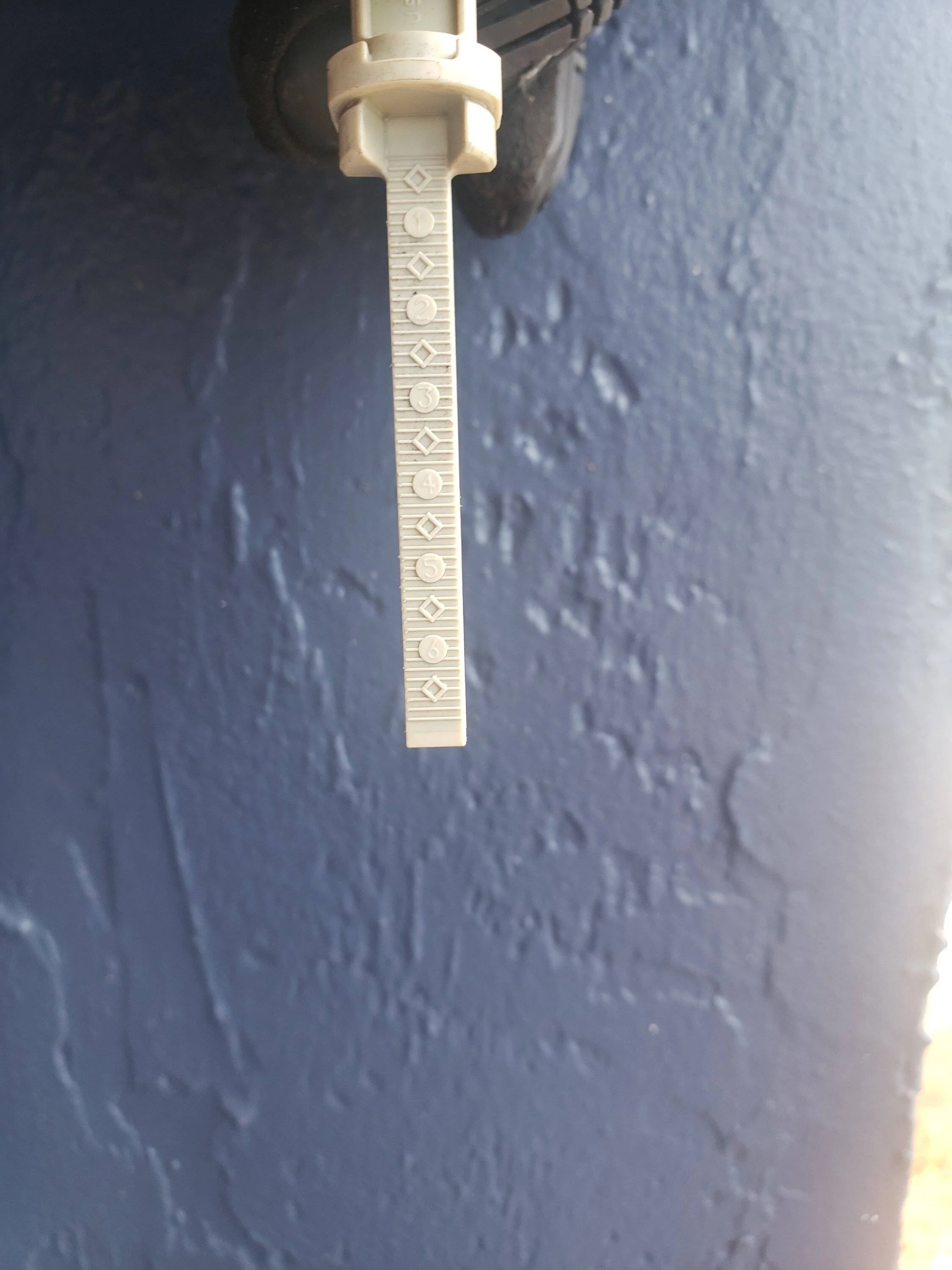

This was my cold running.
This was hot running.

My cold running check the level is at 6...adjusted for hot should be at 5...interestingly, I can't hear a thing coming from my tranny even with windows closed and radio off...

I don't see anything on the stick in cold reading...
Yup, its bone dry. Im convinced it is low, ordering some fluid now. But I won't just dump it all in. Half at a time and take reading after its warm etc.
You are seeing the exact results I saw when i checked mine. I never checked it again cold after adding the 12oz. I do wonder if that 12oz caused it to register on the stick cold.
