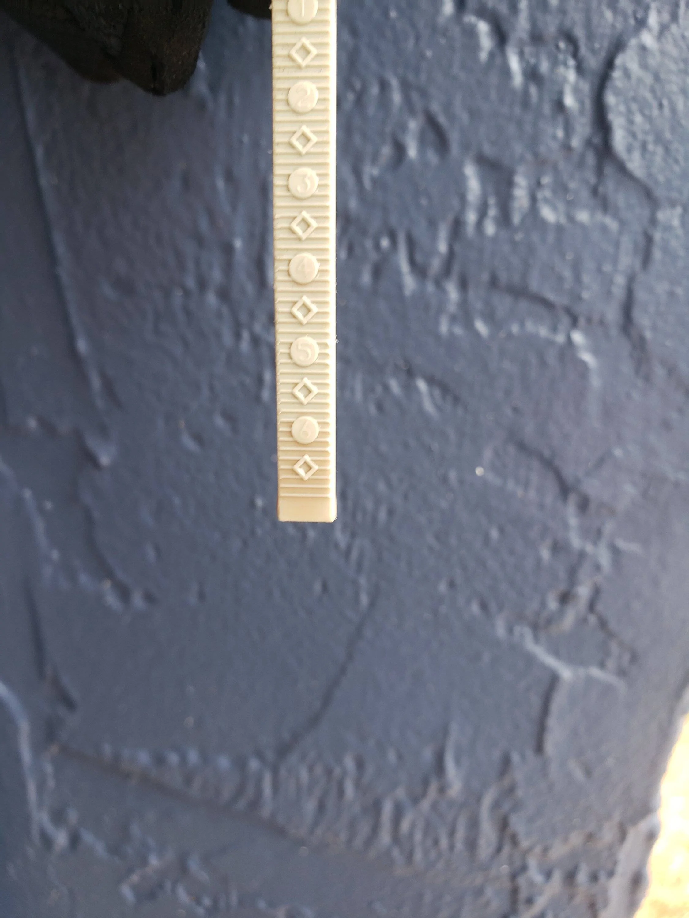

Yup, its bone dry. Im convinced it is low, ordering some fluid now. But I won't just dump it all in. Half at a time and take reading after its warm etc.
What mark is your hot at?

I stuffed some towels in my glove so I could bear to touch the downpipe... here's the reading warm.
It looks to be at or below 5. I checked it 3 times. Engine still running after driving around for about an hour.
This is exactly what i saw on mine.

As i recall, 12oz took mine from 5 up to 4.
I ordered 2 quarts from ford. Picking it up in a couple days. Probably won't use 2, but Amazon was more for 1, than ford for 2 so.

So I ended up adding some fluid. It actually only took about half a quart. I drove around for a while doing some errands and measured it while hot at the house. It is now dead on mark 4. It also did nothing for the rattle I hear. So unfortunately that wasn't the fix I was hoping for.
I will continue to keep an eye on it for any further changes in noise or functionality. Fortunately I haven't noticed any issues with the trans or motor since this noise started. I just don't know if its a ticking time bomb or not. Tbh, I am considering ordering a 4door Bronco in eruption green with the 2.7l when the order banks open in 02/2023.
