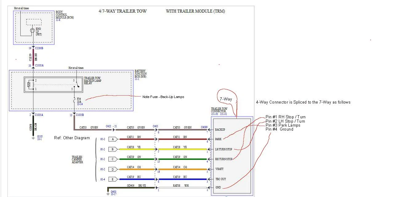

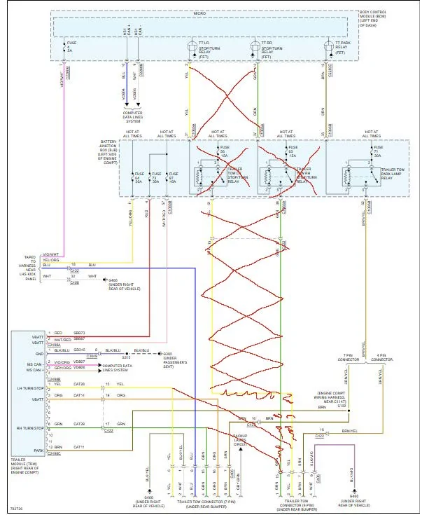

These relays have been omitted and full control is from the TRM.

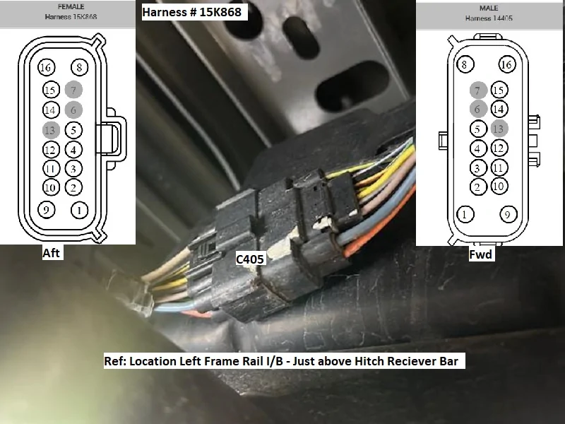

For the Truck Side, you may try to pull and inspect 3 ea connectors
C405 & C4099 & C422
If its a bad connection on the Truck Side, its a high probability of a dirty corroded connection on one of the 3 connectors below.
C405 - RH Stop/Turn = Pin #15

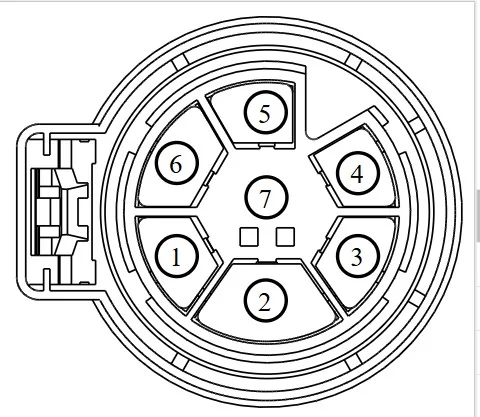

C4099 - Back side of 7-Pin Connector
RH Turn = Pin #4

check fuse? there are different fuses for turn signals.
Fuse #87 feeds both LH & RH Stop / Turn for the Trailer Lights and controlled by the TRMtruck
If you are referencing Fuse 56 & 63 and the relays, so far no one has reported that they have those relays and fuses installed.
The wiring diagram shows them but they are for a truck that does not have the TRM installed, so far I have not seen a truck that does not have it, which is why I edited the diagram to show how its actually wired.
C405 & C4099 & C422
RH Turn = Pin #4
